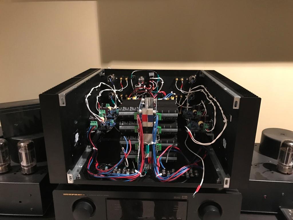

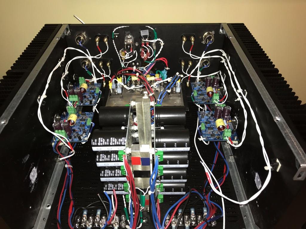

Great amps Tom;
Listening to four channels of a soon to be six channel amp. The last two channels are built and tested; I am just conducting a listening test on the first four with a passively bi-amped system.
Dead quiet, fast and resolving. Very very clean.
Kudos; very well done!:):):)
Matt

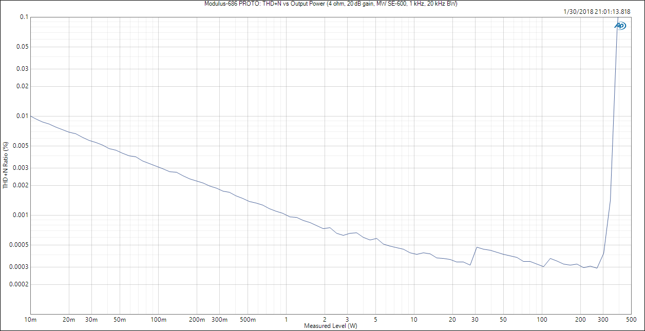

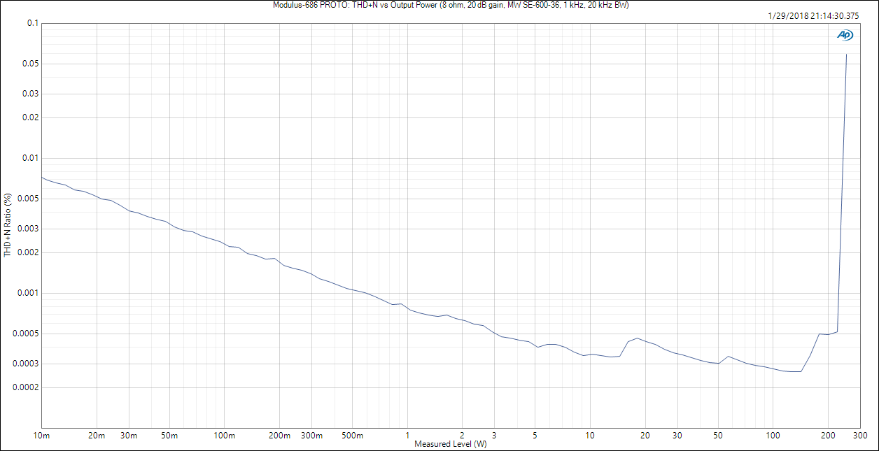

Ok, so maybe I'm biased, but I think those of you who want more power have something to look forward to.
Spinning some Dire Straits, Cream, Eric Clapton, The Eagles, et al. on the MOD686. Mono for now as I only have one channel built. Sounds amazing - like a Modulus amp only with more power.
Gain: +20 dB
THD+N: 0.00026 % (140 W @ 8 Ω)
THD+N: 0.00029 % (260 W @ 4 Ω)
Onset of clipping: 0.0005 % THD+N @ 220 W (8 Ω)
Onset of clipping: 0.070 % THD+N @ 380 W (4 Ω)
Noise: 15 uV RMS (A-weighted, 20Hz-20kHz)
Build cost: $300/channel + power supply, connectors, etc.
Teaser plots attached. I expect to open for pre-orders over the weekend.

  • Modulus-686 PROTO_ THD+N vs Output Power (8 ohm, 20 dB gain, MW SE-600-36, 1 kHz, 20 kHz BW).png
  • Modulus-686 PROTO_ THD+N vs Output Power (4 ohm, 20 dB gain, MW SE-600-36, 1 kHz, 20 kHz BW).png

What size heat sink are you running for a single board? Would a Disspante 4U chassis have enough cooling capacity for a stereo build running at 4Ω?
I'm using a 0.4 K/W heat sink that I bought as scrap aluminum (at scrap aluminum cost) many years ago in Copenhagen. :) It's about 300x150x50 mm and weighs in at 2.5 kg if I recall correctly.
I need to look at the Dissipante heat sink specs. 4U sounds about right.
If you lower the supply voltage to ±28 V, you can probably get away with the 3U. You'd get around 150 W in that case. That'd be a nice safe and sane build for those who'd like more power than the MOD86 delivers but don't need the 200+ W.
Is it possible to adjust the gain to 26db? I want to be able to bi-amp alongside my bridged Para 86 amps that are 26db.
Absolutely. I'll build the boards with the default 26 dB gain. Those who want the slightly lower noise floor can pluck a resistor off the board and reduce the gain to 20 dB.
The gain is adjusted by changing one resistor. This can be done without impacting amplifier stability. It does impact the amplifier noise floor, though, so as the gain is increased, the THD+N gets a bit worse. Figure a 3 dB change in gain -> 3 dB change in THD+N.
