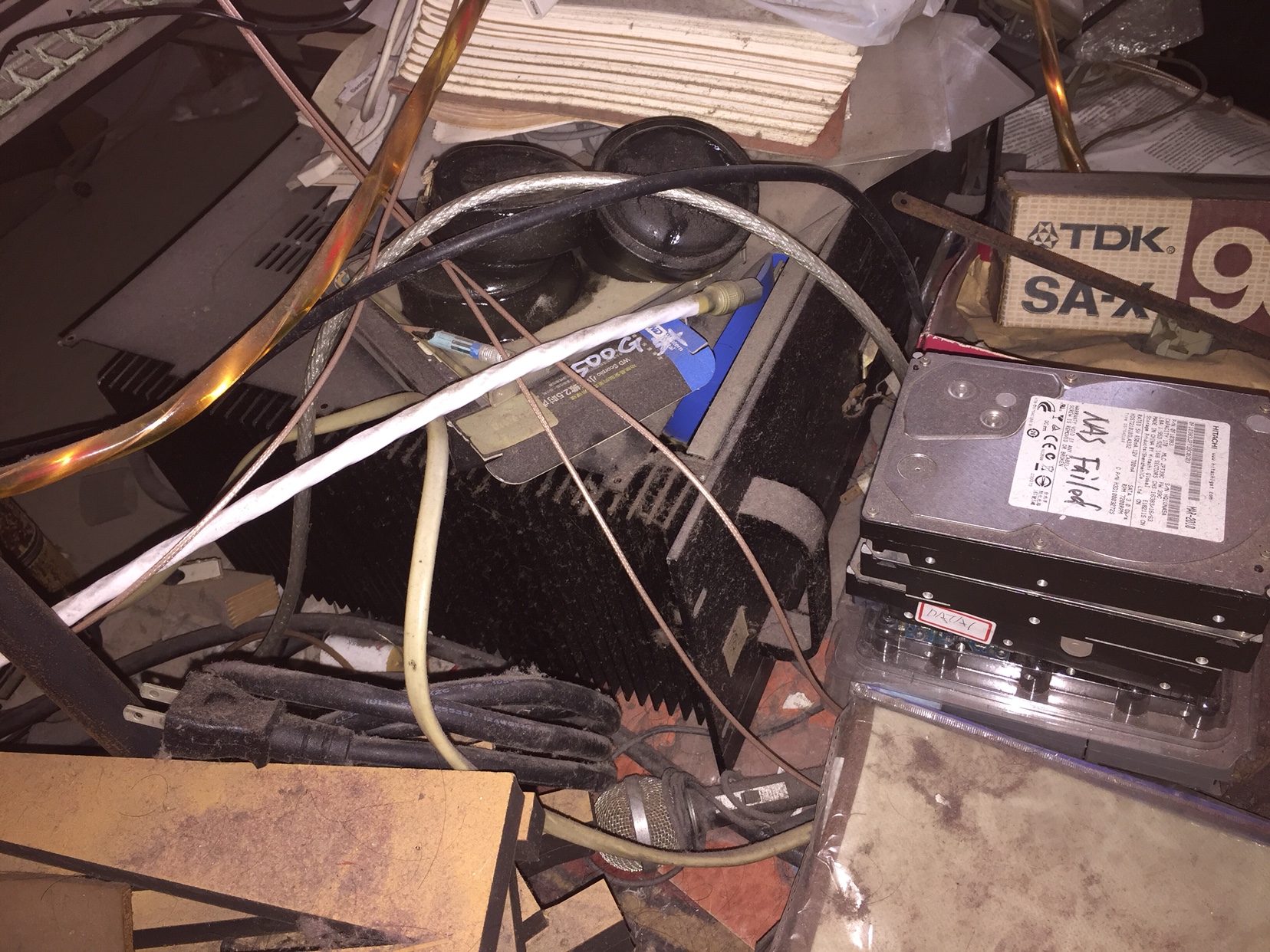

So would heat sinks about this size work?
At least from a casual glance, I'd say it probably would. On my Taming the LM3886 - Thermal Design, I detail two procedures for estimating the thermal resistance of a heat sink.
