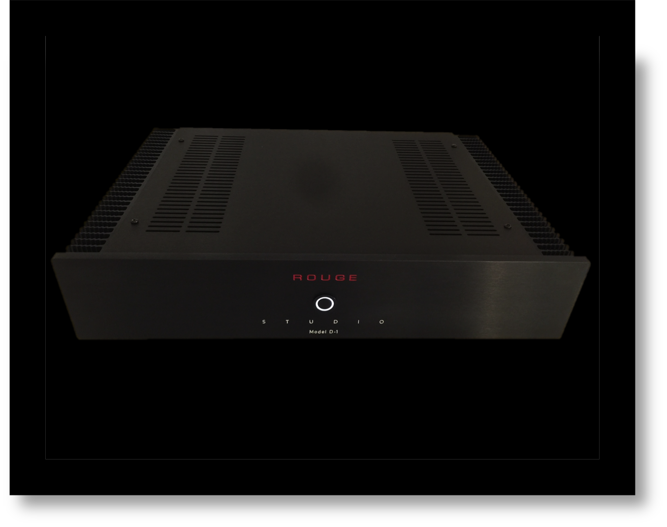

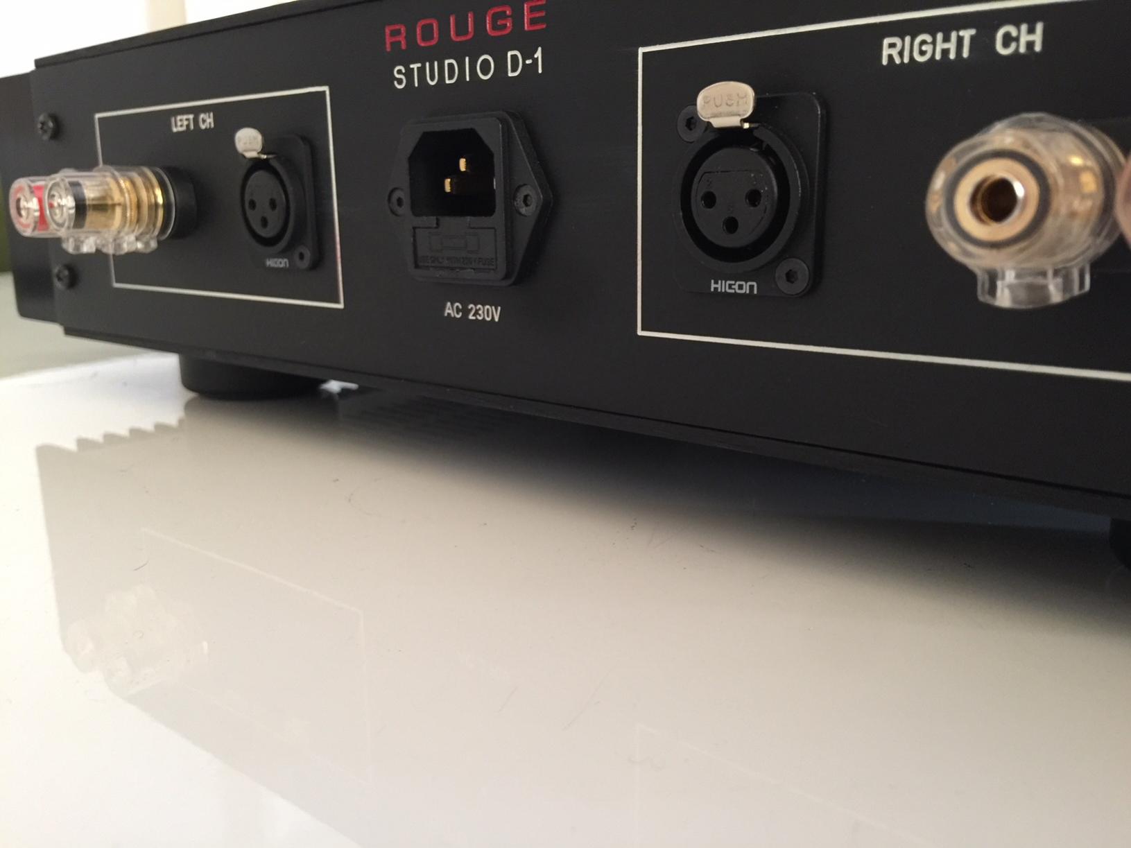

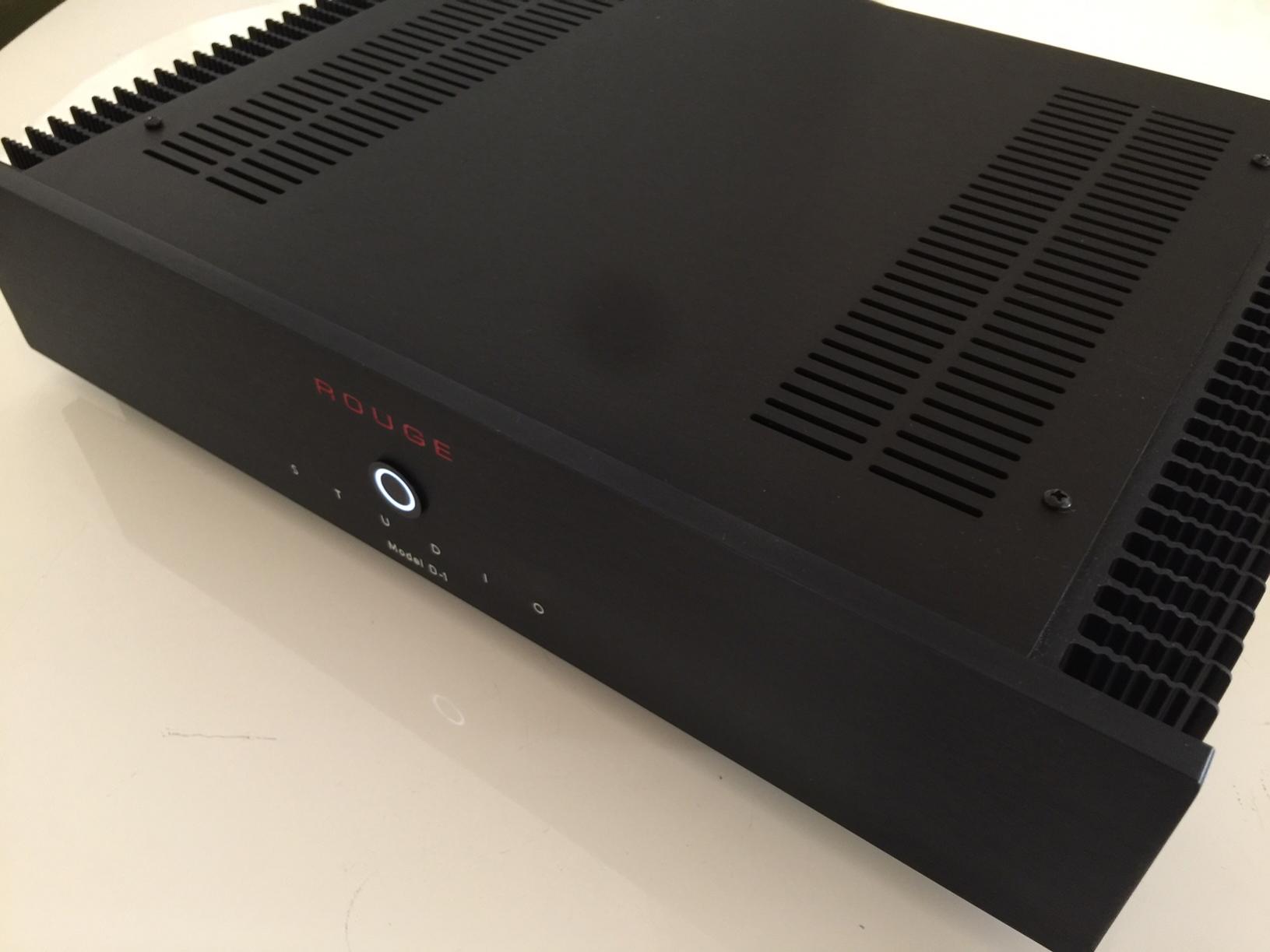

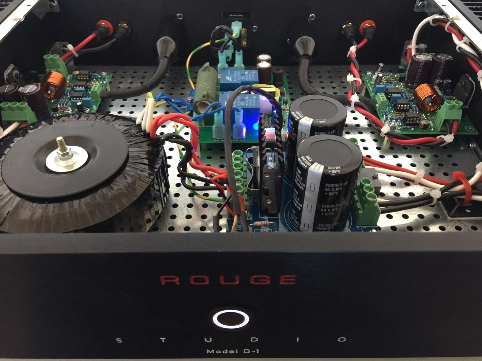

A mighty fine commercial MOD86 implementation
Folks,
I received this from Federico, the owner of Rouge Audio Design in Italy. He built an amp for a customer using my Modulus-86 and Power-86 boards and did a very nice job. I thought I'd share.
Tom

What is that board at rear center? Looks like relays or switchers with a load resistor?
It's a soft-start board for powering up the mains transformer gently. I generally don't use them, but some do. I'll eventually make my own soft start board.
