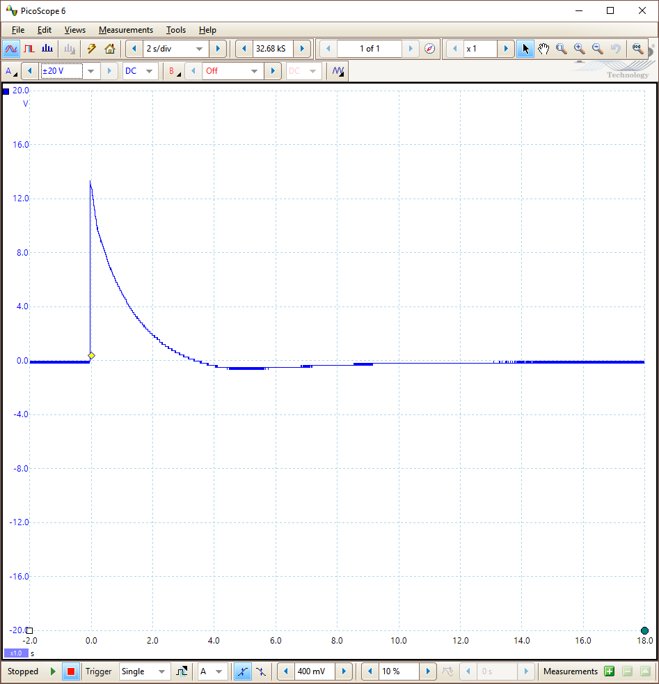

That's **WAY** too much pop. That's all the way to Xmax. At least the DC servo is doing its job and brings the output back to zero. This is NOT normal behaviour.
If the amp does that when the input is either floating or shorted, something is seriously wrong. I suggest making a shorting plug (XLR with the three pins tied together), plugging it into the amp, and testing again.

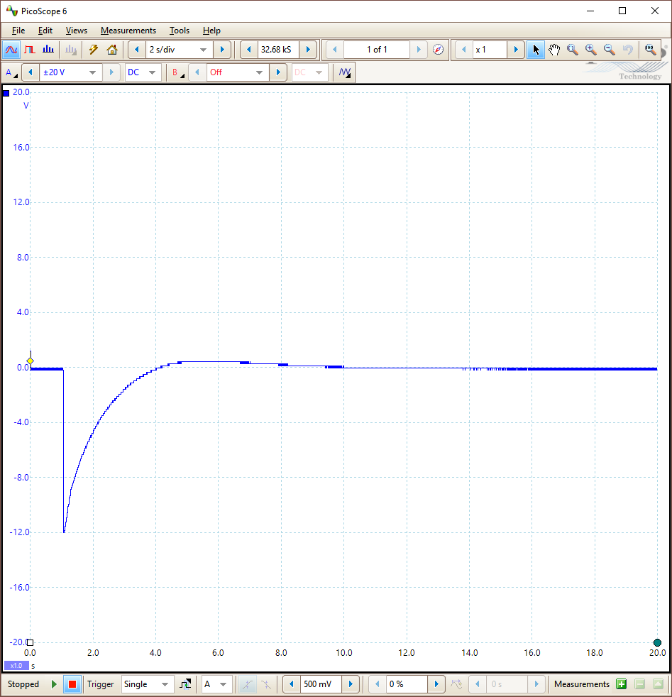

I've now got it on the bench. And it still exibits the behaviour with pin1 & 2 shorted at the chassis XLR.
This is what it looks like on the scope across the speaker output with a dummy load connected. This is just an example as they do not happen every time, will be positive or negative and will vary in size. You can clearly see the servo doing its job though.
Also to park the connection issue to pin 1 for a while it does it with or without the connection made at J1 GND. In fact I can dissconnect everything at J2 except a sorting link between GND & IN- and it will do it.

I don't think I have ever had a thump with a LM3886 chip amp. I would suggest checking output of the THAT chip.
Yep see it at pin 6 of THAT1200
The plop is caused by the input bias current of the THAT1200. I am now able to reproduce it in my setup too.
If you leave the pseudo-differential cable floating, you'll get the plop. If you connect the pseudo-differential cable to a DC coupled source, you do NOT get a plop. With an AC coupled source you DO get a plop.
If you use a differential source or leave the differential inputs floating, you do NOT get a plop.
This issue is caused by the rather large input bias current (1400 nA) and input offset current (±300 nA) of the THAT1200. You need to provide a path for this current to flow or it will dump into the input resistors within the THAT1200 and cause a large output voltage offset.

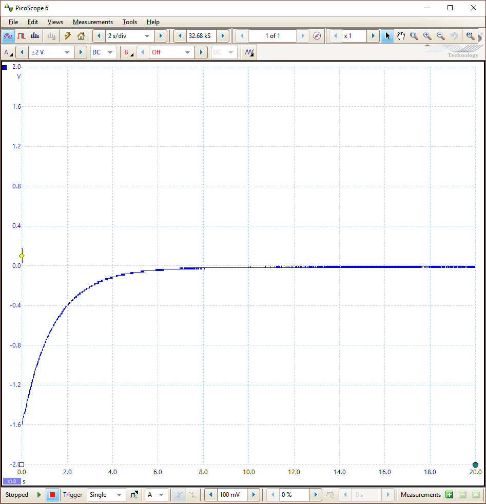

I agree. It's the input bias current and input offset current into the input impedance creating the voltage. The reason for the transient behaviour on the output of the THAT1200 is that the common-mode cap on the THAT1200 (Cb in the data sheet) needs to charge.
Charging Cb generates a plop on the output of the THAT1200, which the MOD86 amplifier section happily amplifies, so you get a plop on the output.

Yep. The significantly lower input bias current and input bias offset current of the OPA1612 will significantly reduce any plop. The input on the MOD286 also doesn't have the common-mode cap, so it won't have that transient behaviour either.
Could the THAT1200 problem with psuedo-diff be remedied with a resistor to ground at the input? Perhaps 10k? Or, if differential mode is to be maintained, a pair or well-matched 10k, one from each input pin to ground?
A 5 kΩ resistor from the input to ground would reduce the plop by a factor of 10.
