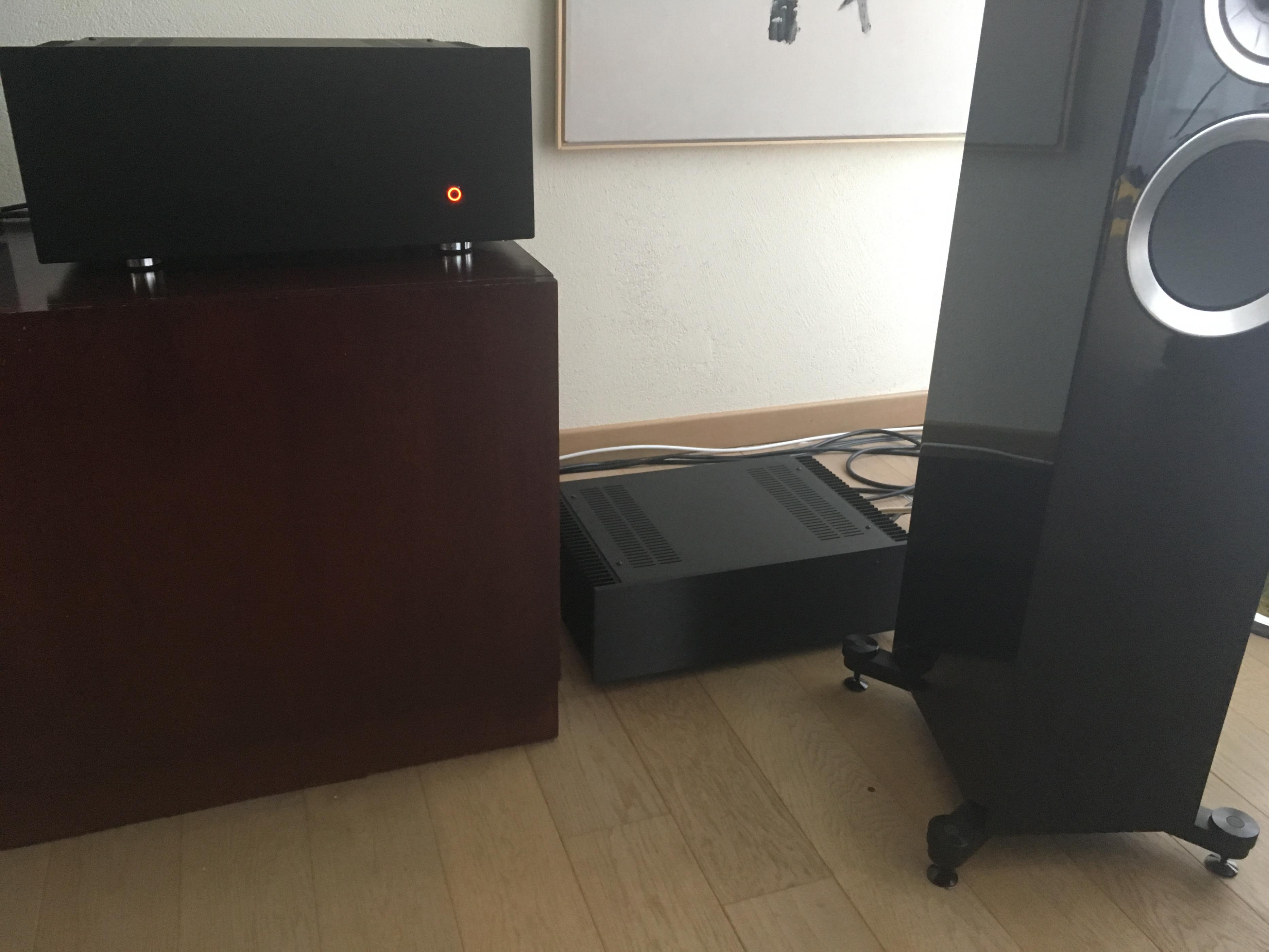

Comparison Mod286 Monoblocks with Mod686 Monoblocks
Hi.
As promised a while back, I wanted to share my impressions when comparing my two Mod686 monoblocks (20dB gain) as described here
https://www.diyaudio.com/forums/ven...wer-amp-extremely-low-thd-85.html#post5581125
with my two Mod266 monoblocks (20dB gain) as illustrated in this thread
https://www.diyaudio.com/forums/chip-amps/309848-mod-286-build-thread-14.html
The objective was to find any difference in tonality between the two pairs.
The tests were conducted at a constant setting providing a max 0.5W output level (was the right level of loudness for me to catch the details and not have the room vibrate). Of course the tests represent only my subjective impressions. I choose three music titles, one for comparing the highs, one for the bass and one for soundstaging. I listened three times to the first 30 to 60s of each song, before switching amps, which took about 30s total. The speaker were the KEF R700 (8ohms, 3.2ohms min) at a distance of 2.5m with the Auralic Altair as a source and pre-amp. Just to be sure I compared the output levels from the Amps and even adjusted for the 37mVACrms difference between the Mod286s (2.035VACrms) and the Mod686s (1.998VACrms) tested without load using a 1kHz, 0dBs, 24bit, 96kHz testtone coming from the Altair.
Summary: It was not easy as the brain plays tricks on you, but I think, I could not hear a difference between the two amps into these speakers at those power levels. The power levels were not very high for the weaker Mod286 to run out of breath nor is the impedance behavior of the speakers very demanding. After all the amps measure pretty much identical with only minute differences.

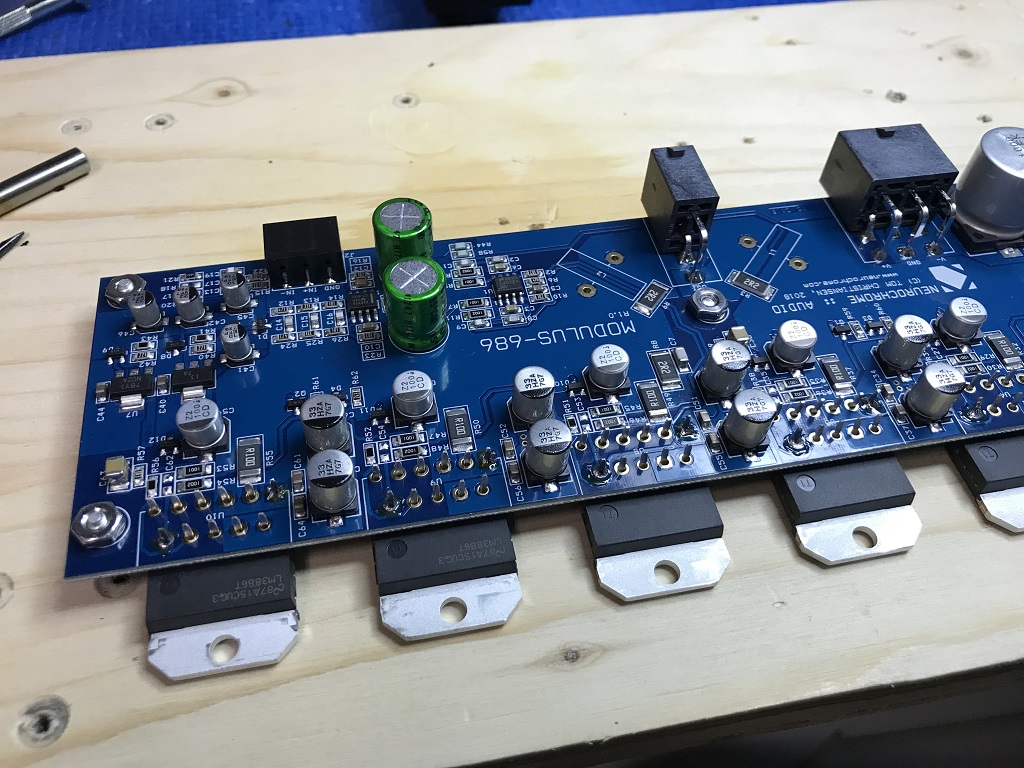

Hello everyone!

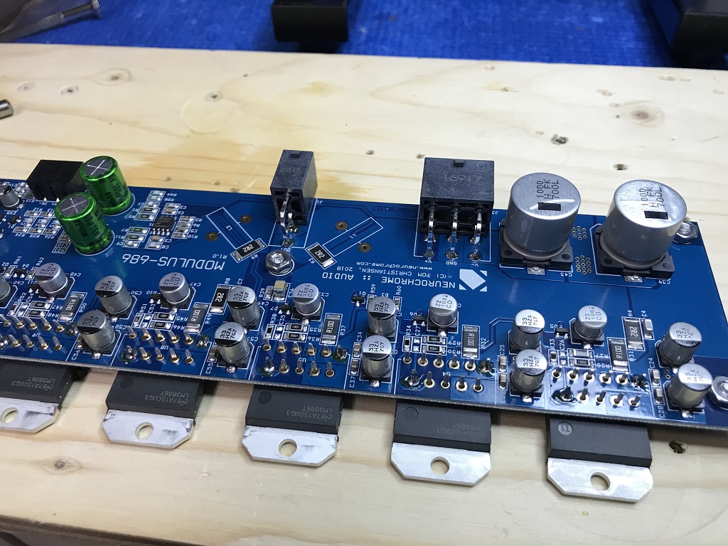

I've decided to do a non-standard build of the Modulus-686 that will be powering my Sagwee LT V3 speakers. For this, I've decided to install the LM-3886 chips in a 90 degrees bend to provide more room in my chassis. I've also decided to use 0.5mm alumina/ceramic pads for the LM-3886 as they provide amazing heat dissipation.
Here's some pics of the modules.
All the best & Happy New Year!!

I’m tickled pink that you are building Tom’s SMD designs, you are a pro builder! I think you will enjoy the amp, they are indeed a reference standard imho!
Chris, I think Do is building it the way he is to allow for more room in the chassis, not because of the loudspeaker design itself.
I am actually curious to see how they sound with your Troels ATS design in addition to the Sagwee.

Hello everyone!
Do
I do like this idea a lot, you really going to save a lot of space in the case .
Where did you order the ceramic pads from?
