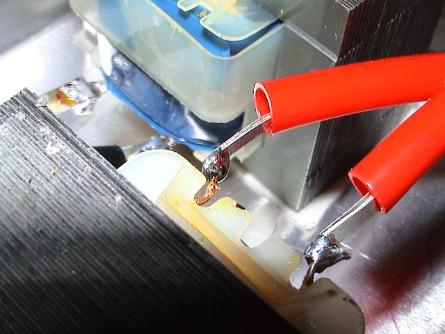

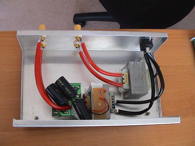

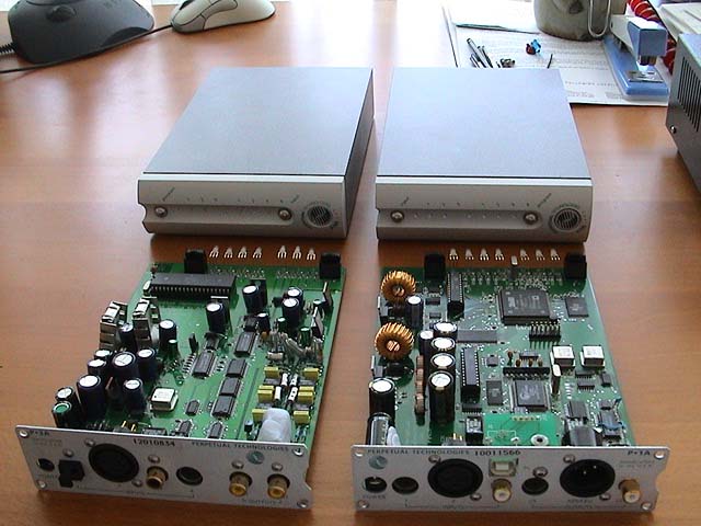

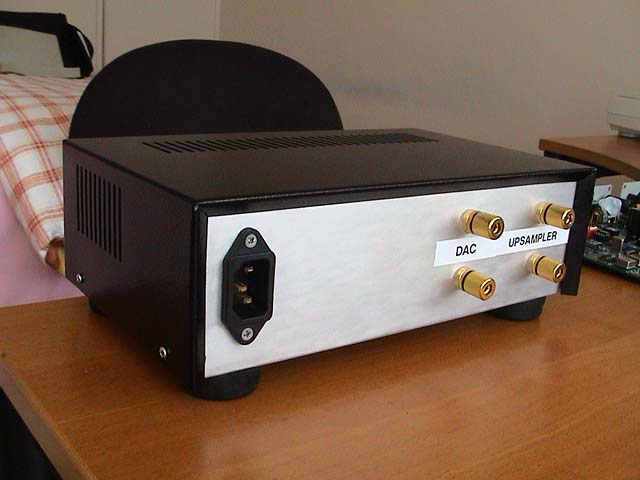

Sorry to disappoint you guys, but this DAC and upsampler sound horrible! DAC on its own could be used, but only just!
I modified both units 2-3 years ago, and the level of noise and crowded design were the biggest limiting factor. The sound just wasn't right at all. Friend of mine asked me to do something about it... so I did - I built the external power supply, used silver ribbons - a lot! I replaced some capacitors in both DAC and upsampler: used 2200uF FK Black Gates + styrene in analog filtering / buffering.
This external power supply actually did most of improvements.
Needles to say, he is one of many, who once heard NOS with 1541A, will never go back to upsamling. I have 'em waiting in a cue... all quite stunned with NOS DAC sound.
Extreme_Boky
