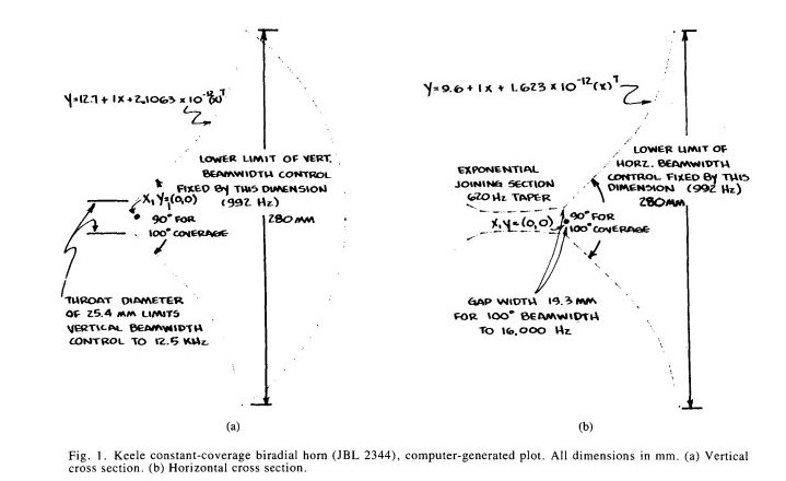

840 hz, that won't work with a 2342. Cutting them makes them yours for good though. I am out of JBL options the PT Waveguides don't load well enough to crossover that low. Here take a look at this in case you have not seen it. Food for thought if you decide to cut them.
Good Luck Rob:)

Interesting picture, very helpful, thanks!
Though the horizontal dimension of the 2344 actually is 320mm. My idea was to replace the cutout partially by absorbing stuff to smoothen the edge rolloff/avoid reflections. Do you have hints towards this technique?
320mm??? Mine don't, they measure 11 1/4 or about 280mm across the flare, you are an 1" and change too big across the flares. Top to bottom they measure 12.5 or 320mm where the mounting skirts are. Once you cut them you are going to shorten the distance and loose some directivity control in the lower portion of the horns range compared to a stock horn. If you are not worried about that then cut away. I don't know what the effect of the dampening material would be as it relates to changing the horns size.

I checked all my 2344; apparently they all measure differently. I've got 3 old 2344 (separatable) measuring between 318 and 322mm across the flares, the latter exposing >90° flare (having 90° at about 310mm), with a mere 18mm mouth opening, and two 2344A with 315mm and the said 19.6mm mouth (All have the original JBL tags on them). I tried to measure the curve, apparently the older ones flare more rapidly than the diagram suggests (which fits the 2344A).

Apparently my cut-down plan would reduce the horn size just a little under the design size (280mm design, 265-270mm target). I might loose a little (hopefully acceptable) direction control at the low end, will acoustical damping at the edges help avoiding (more) reflections? What material would you suggest?
