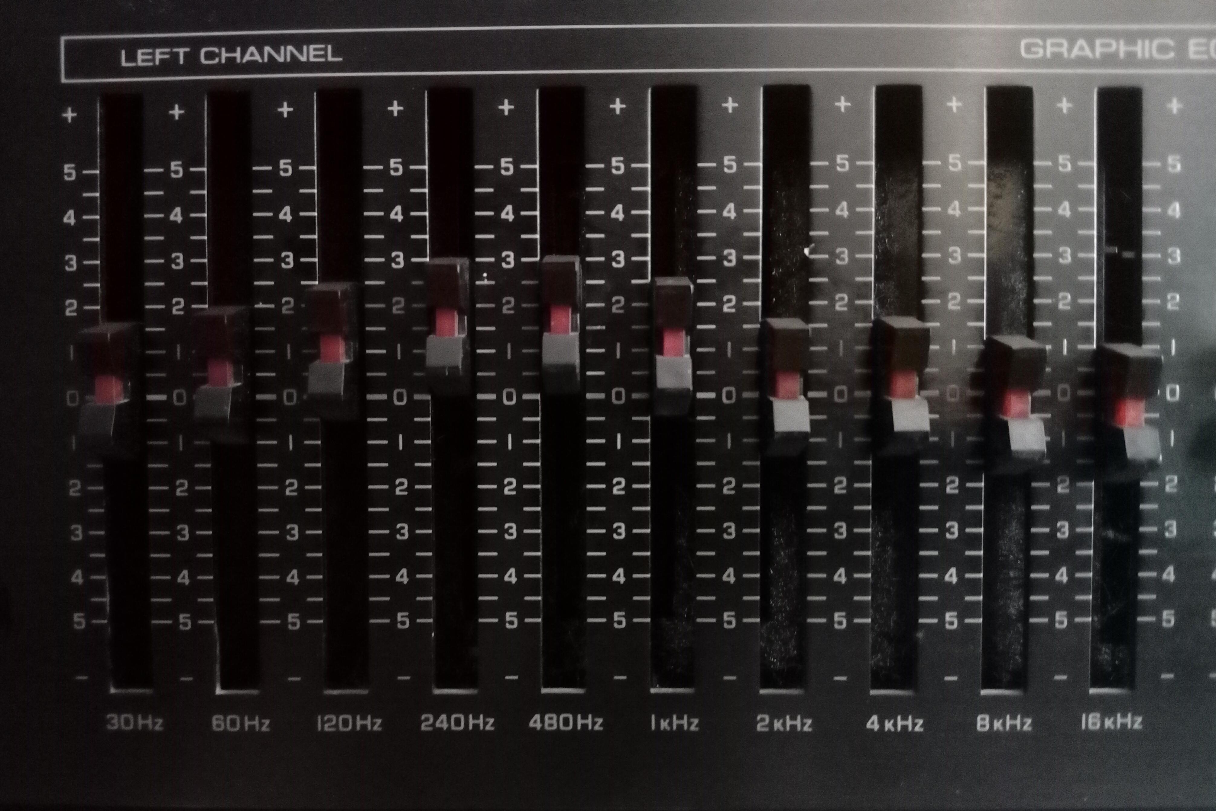

Is it possible to modify speaker crossovers so that they mimic the speakers response after a graphic eq. is applied? Or are we limited by the drivers in question?
Sorry if this is a stupid question, I imagine there's a lot of factors involved, I don't know the basics of crossover design... I'm guessing the answer is it could be done but it's a painstaking process! I was testing a pair of Kef concerto speakers and tried to make them sound as my main speakers and sort of managed it using an external eq adjusted as you can see in the picture

Just loop the EQ through, ie feed it with the sound out and send it back into the laptop. Get an analyser program, set your levels, to do a single sweep or block of pink noise and instantly you have the response. Convert it to an *.frd file and you can work with it in a speaker simulator.
The speakers will take a little more than that but if you can work with resistors and cables then no problem.

It is WAY better to do it in the Signal world, meaning an EQ before the power amp, what you have already done, than in the Power World, passively between amp and speaker, which costs precious Watts.
For an electronic EQ, getting 10dB boost or cut is easy peasy, passively it means that if your average listening level is 10W, you will need to boost it to 100W or attenuate to 1 W.
We can "waste" Volts which are cheap, not Watts (expensive)
Your curve shows about +3dB boost at a midrange frequency, around 480 Hz; that means attenuating lower and higher frequencies by 3 dB since crossovers are passive, they can only provide loss, not gain, so you start by wasting half your amplifier power.
Much better to get that curve beforehand.
EDIT:you have ALREADY found an EQ you like, so no real need for measurements.
Just trying to keep it simple to solve your problem. :)

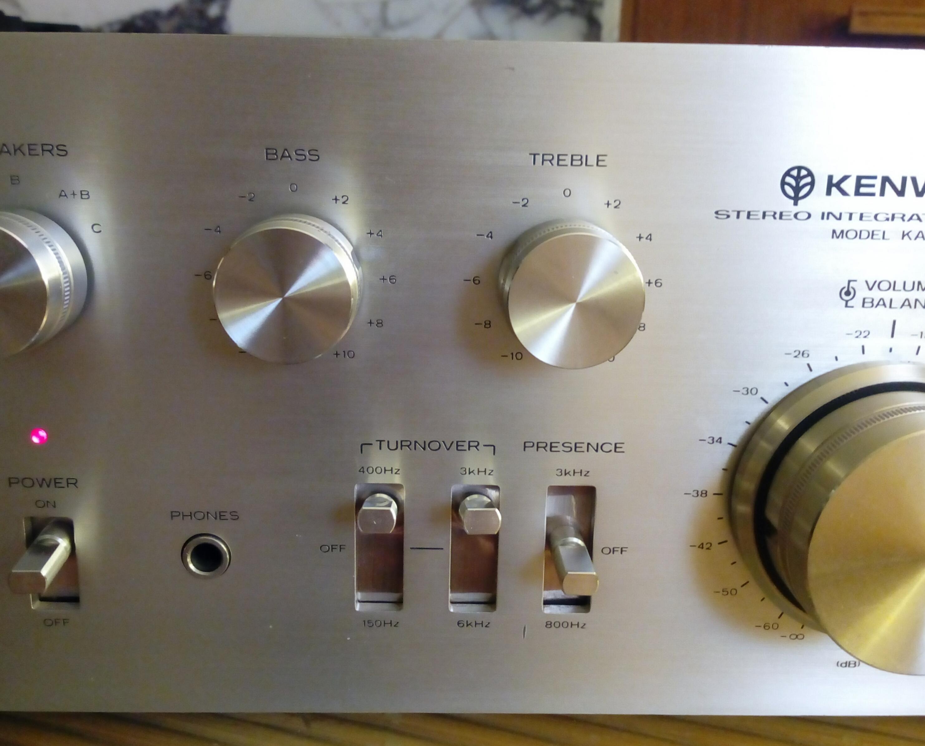

Thanks all for the input. I had already improved the boxes with bracing, bitumen, felt and white wadding to the sides. About the changes in the "signal world" I took out to the arena my Kenwood KA7300 and used its tone controls adding two notches at 400hz and cutting two at 3khz and I have to tell you results are quite good! I think I prefer that to having an extra piece of gear in the middle, despite the EqQ may allow more precise tweaking... a shame amp these days come with no tone controls at all!
