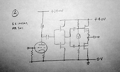

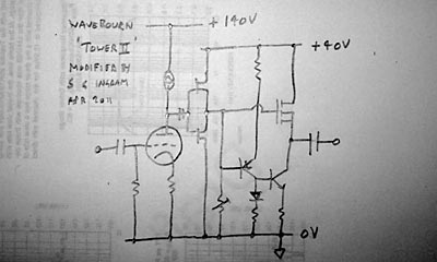

And of course this being DIY I thought about whether I might build this but with some constraints in mind it means some changes. Firstly, I have some trafo's without centre taps so I'd need an output capacitor :mad: and I would like to use just a single triode for the voltage amplifier stage.
A single triode doesn't have a very low output impedance so I am thinking of inserting a complimentary JFET follower between the triode and the output stage in place of the Pentode that is part of the original design.
I have assumed some understanding of the workings of the Wavebourn Tower II the output stage which might be somewhat naive ! I see a MOSFET source follower on top of a counter modulated current source. This current source is actually a current mirror, I've cheated and drawn the mirror as a diode + npn output transistor. The current is modulated by the pnp transistor that feeds it. Am I on the right track here ?
The attached diagram, Option C shows a very simplified sketch of the idea.
Option A shows my initial musings over a triode driving a Nelson Pass F4 (simplifier diagram) for comparison.
I'd be interested in your thoughts ?
Yes, you got it right. Counter-modulated current source keeps as stable current through the source follower, as real load (speaker) permits.
It's a "2-store Tower", as I call it. A complete, "3-store Tower", has one more feature: the follower is augmented, so voltage between source and drain is kept as less variable as possible.

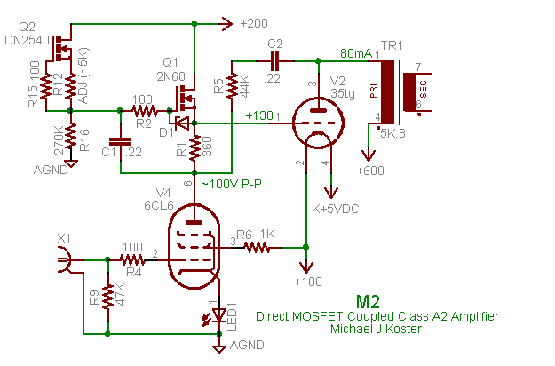

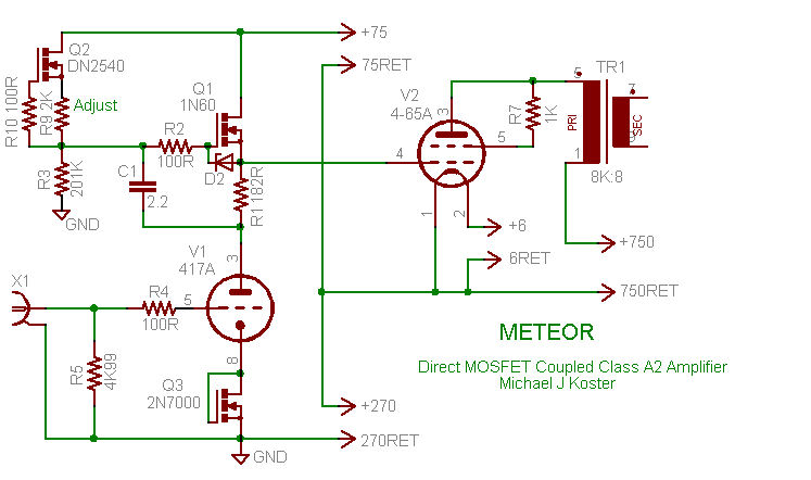

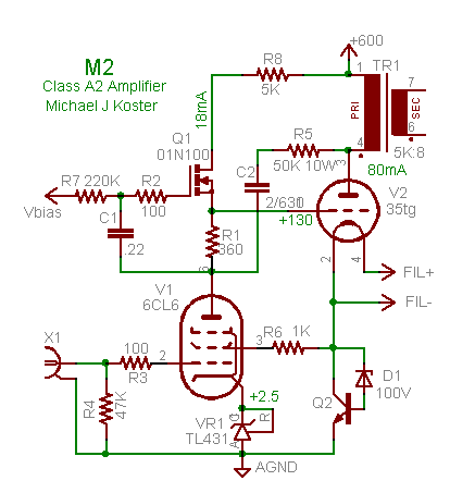

By the way, you may use a SRPP stage to drive it. Like, Michael Koster used to drive huge tubes on his avatar. I have not seen him here for a long time, and he does not answer on e-mail, so I am attaching his Meteor schematic here.
