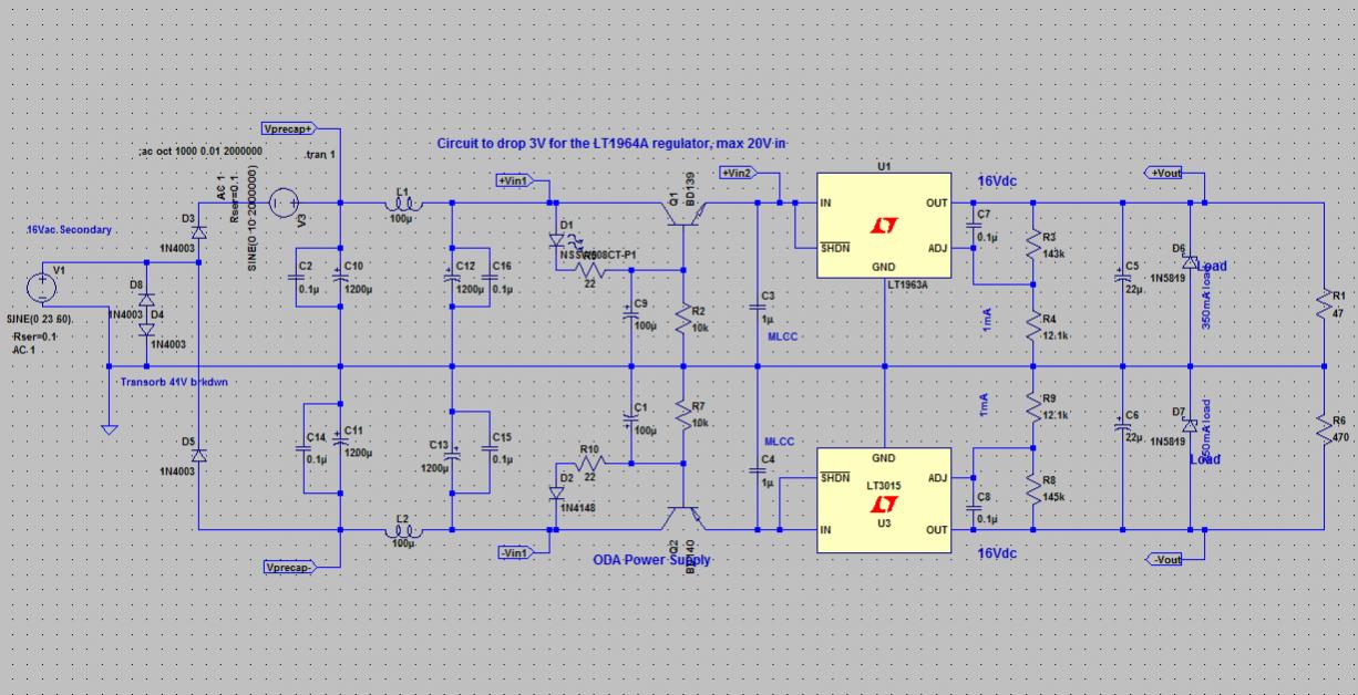

Indeed why not place a similar attenuator into the other, negative, leg of the supply as well?
Good thoughts!
In my original layout I did have one on the negative rail, just for symmetry. I used a 1N4148 diode there instead of a LED since I didn't need any voltage drop. I've been thinking about adding that circuit back. From past experience it seems like every time I design something asymmetric like that thinking it won't matter, it does. :) Plus opens the door for a drop on the negative rail if a higher voltage input was used and really did need to knock it down to -30Vdc.
I also simulated adding in a cap multiplier, R5 and C5. I wound up with 22R and 100uF. I'm thinking of adding that in, too. That one is sort of a "why not?" The circuit is already 50% of the way to a cap multiplier, might as well add the two parts. A 100uF solid polymer electrolytic is small and cheap these days, with just 25mR ESR, Mouser 647-RL81V101MDN1KX. The error amps in regulators seem to be more than fast enough to cope with the sharp corners on the incoming 60Hz or 120Hz sawtooth, the diode cut-off. But something in my head keeps thinking about the Fourier decomposition of those corners and isn't liking it. I would prefer to have them rounded going into the regulator chip. Plus, as you say, even though the regulator ripple out of the regulator is already too small to believe sim results, small/atten is likely to be better than big/atten.
R3 and Q3 are new. Is that to spread the power dissipation over two transistors? I see the top one starts turning on at 21mA.
They reduce the base current of Q2. Without R3+Q3, Q2's base current is (350mA / Beta). With R3+Q3, Q2's base current is (21mA / Beta). Less base current allows you to increase R5 without decreasing the final output voltage. Larger R5 means a longer RC timeconstant, better filtering, and less ripple.
Edit- oops, forgot to mention that Q2+Q3 are a complementary feedback pair and as such, get all of the advantages of http://www.fidelityforce.com/keantoken/content/Kmultiplier.html including lower output impedance.

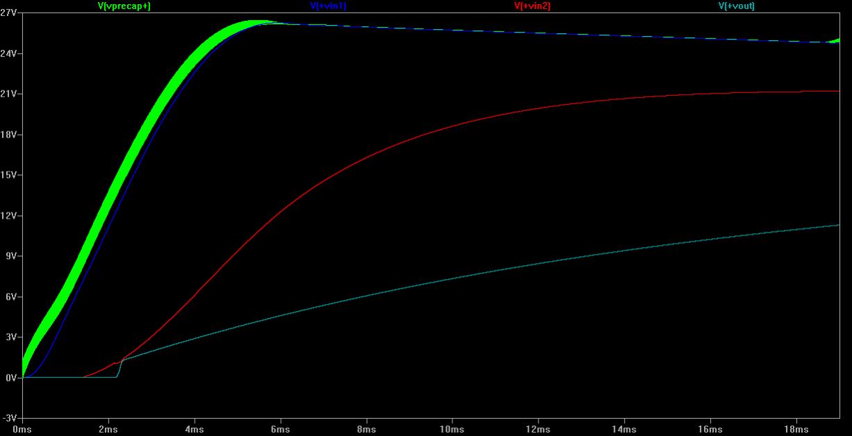

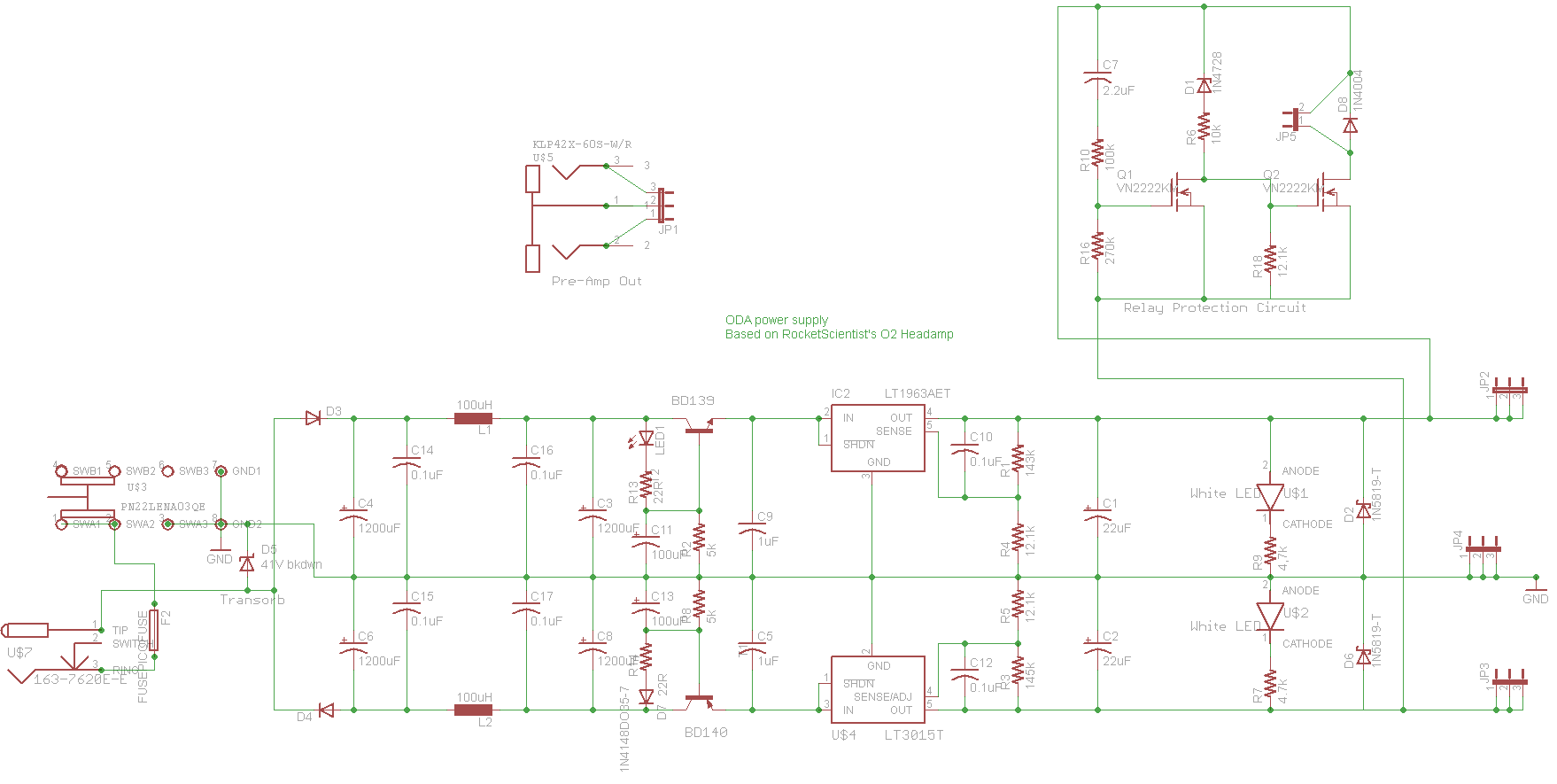

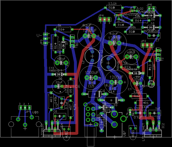

I completely agree. Last night I wound up stuffing in two 100uH chokes between the two 1200uF main filters. The chain of thought was originally thinking of making CRC filters with 0.2R resistors between the caps. But then got to thinking that the inherent resistance in a small choke would be about that. Sure enough, #580-12LRS104C at Mouser has 100uH and 0.2R, along with 1.4A burst rating (cap charging current). So using the inductor gives C-(L+R)-C.
Below is the result. BTW, this isn't commercial. This is part of a DIY headamp in another thread and I'll eventually be posting the Gerbers here in the wiki section on DIYA if anyone wants to DIY it once I get the boards stuffed and verified. This is a 80x100mm board that would fit in a B2-080 or B3-080 aluminum enclosure (Allied Electronics or Newark), or in this project half of a B3-160 with the amp 80x100 in the other half.
The green in the LT Spice plot is before the inductor and 2nd cap (positive rail) while the blue is post inductor. I've injected 1Vpeak of 2mHz noise after the diodes (diode bleed through at high frequencies). That fuzz on the green trace after the t0+ startup is the HF noise. The CLC filter, blue trace output, does a good job of cleaning it up. This is in addition to tombstoning the rectifiers and putting ferrites over the leg for high(er) RF filtering.
