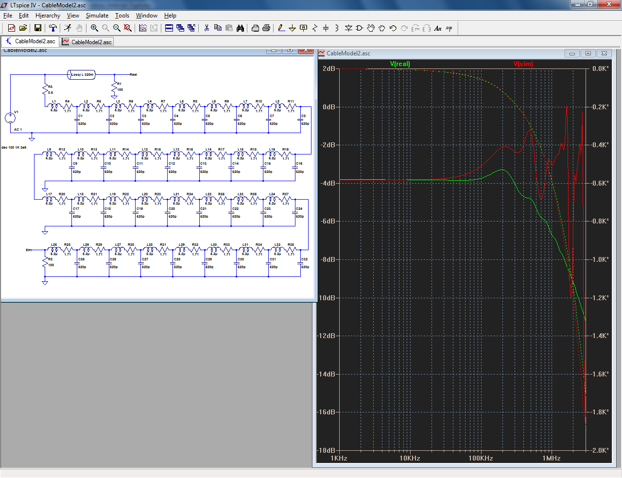

In my first sim, I made a factor of 10 error in the sections of the lumped line.
It doesn't change the gist of my argument though: here is the comparison, and with the resistance also spread between the lumps.
The two transfer functions begin to diverge as early as 20KHz, to reach ~1dB at 100KHz (for 10m sections).
The phase/time aspect is more accurately modelled though: this means that such artificial lines are suitable as delay lines, but not as cable simulators.
There are much better topologies for that, departing completely from the method consisting to attempt to duplicate the elementary L/C cells (which have no actual existence, since they are infinitesimal).

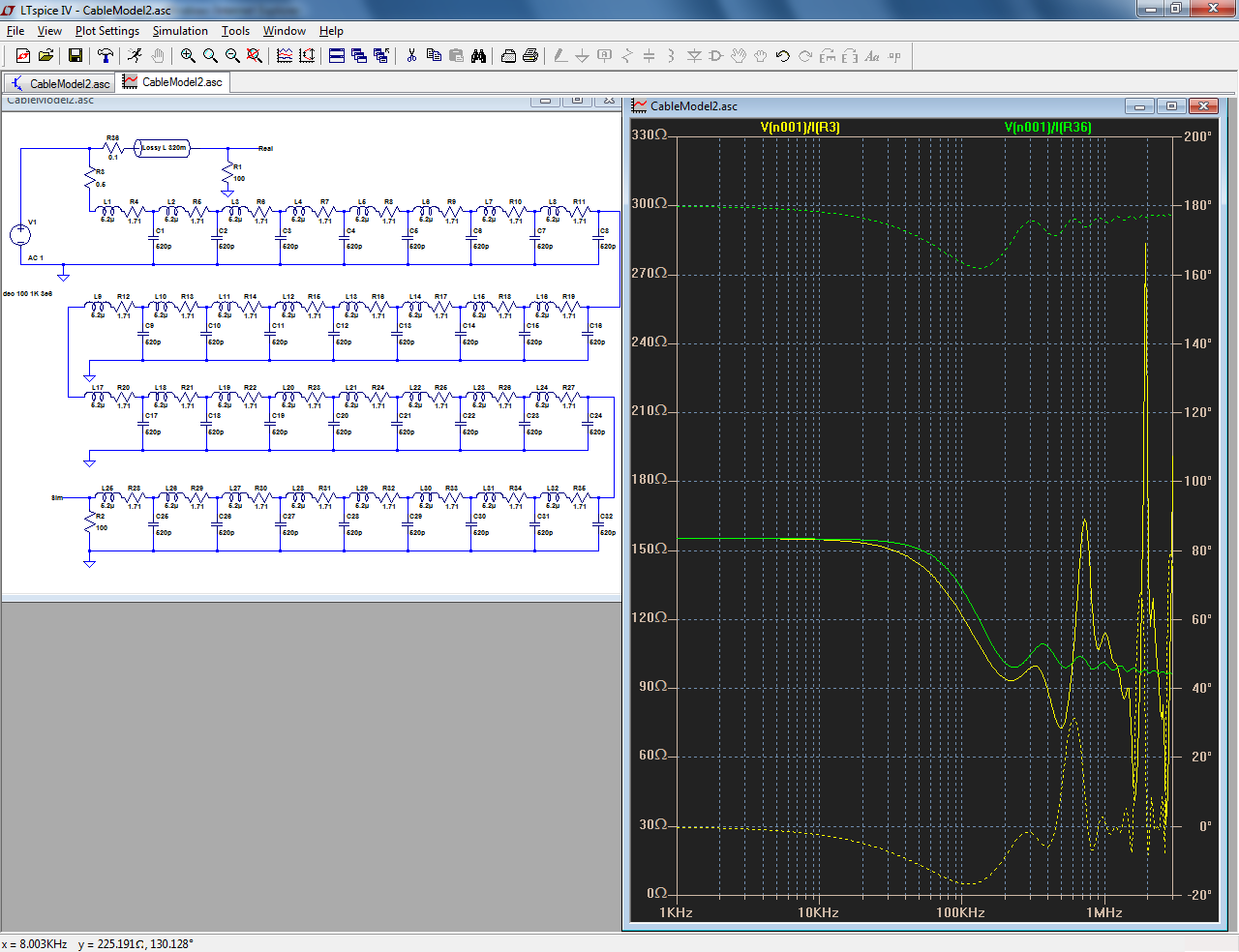

The impedance plots are also seriously divergent above the corner frequency:
