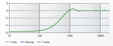

So, very interesting Neil. By using all 20 corner points, it's fairly easy to model a round baffle and then to add a large radius roundover to approximate what would appear to be the front half of a sphere with your program.

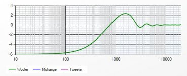

First graph below is the diffraction result with a 16" diameter round baffle with an 8" roundover with a 7" driver in the middle. Just for comparison purposes for the OP, the 2nd graph is the same 7" driver on a 16" x 22" baffle with the driver centered 8" from the bottom. Results look like what you'd expect according to Olson's research, although there is just a little extra peaking in the sphere model here.
Just curious whether you might have any idea as to the degree of accuracy of what I've done? I was a little surprised at the fairly large difference in the baffle step transition point between the 2 graphs but it would seem to agree with what sreten has been saying and to also jive well with lucadelcarlo's subjective experience with his 2 trial conditions.
I could try making it more accurate but it would take some time. Right now the roundover algorithm only uses 4 points. That is, it divides the roundover radius into 4 reflection points and then applies the weights to each point, as Paul Verdone describes in the user manual for his BDS program: http://www.audiodevelopers.com/misc/BDS_Manual.pdf. Paul actually generated weights for 8 points, and I could try using those values to see if the results better approximate the expected results for a sphere.

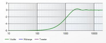

Dimensions:
Sphere: 17.7 cm
Box: H 17.5 cm x W 15.5 cm x D 21.5 cm
12 cm driver
Note: the driver is top mounted and with a 4mm thick basket frame which itself sits atop a 4mm mounting ring, so in total, the front of the speaker flange is 8mm away from the sphere's surface. Does the program offer a possibility to take that into account, and were the graphs supplied earlier depicting a mounting style? I'm very keen to examine what effect this may be having on diffraction. Physically remodeling the spheres is a difficult process, so some degree of CAD-based modeling predicting response as guide would indeed be an excellent tool.
The program has a built-in drawing tool to outline the baffle shape, but that tool is way too simple to address mounting rings, re-radiation from driver openings, absorption from cone materials, reflections from interior walls through the cone and other such implementation details that can affect diffraction. In order to model mounting rings and other details like that, I would have to use a 3D CAD model that provides much more detail than my simple drawing tool, and the model would need to be considerably more complex. I actually considered using an embedded 3D drawing capability and importing SketchUp files, but decided I already had plenty to do . For complex geometries and modeling absorption, you are probably better off just building a physical model and taking measurements.
Also, the model currently only provides a single user-specified summation point, and baffle diffraction can vary quite a bit depending on where the measurements are taken. So at this point I would rather spend time creating a 3D picture of the baffle (and crossover) effects than adding more fidelity or additional features to the current diffraction model.

So lucadelcarlo, especially considering that the program cannot account for your mounting method (which is going to add some extra rippling to the diffraction pattern) and that the program may not be totally accurate with the large roundover size that I have to use, I wouldn't take the simulation for your sphere beyond a ballpark estimation. Here are the results. The sphere is the 1st one.
The 0dB points end up quite different - it looks like about 2000Hz for the sphere and about 700Hz in the box. No wonder you are hearing such a difference. It would be interesting to see how these graphs compare if you actually get around to measuring them.
