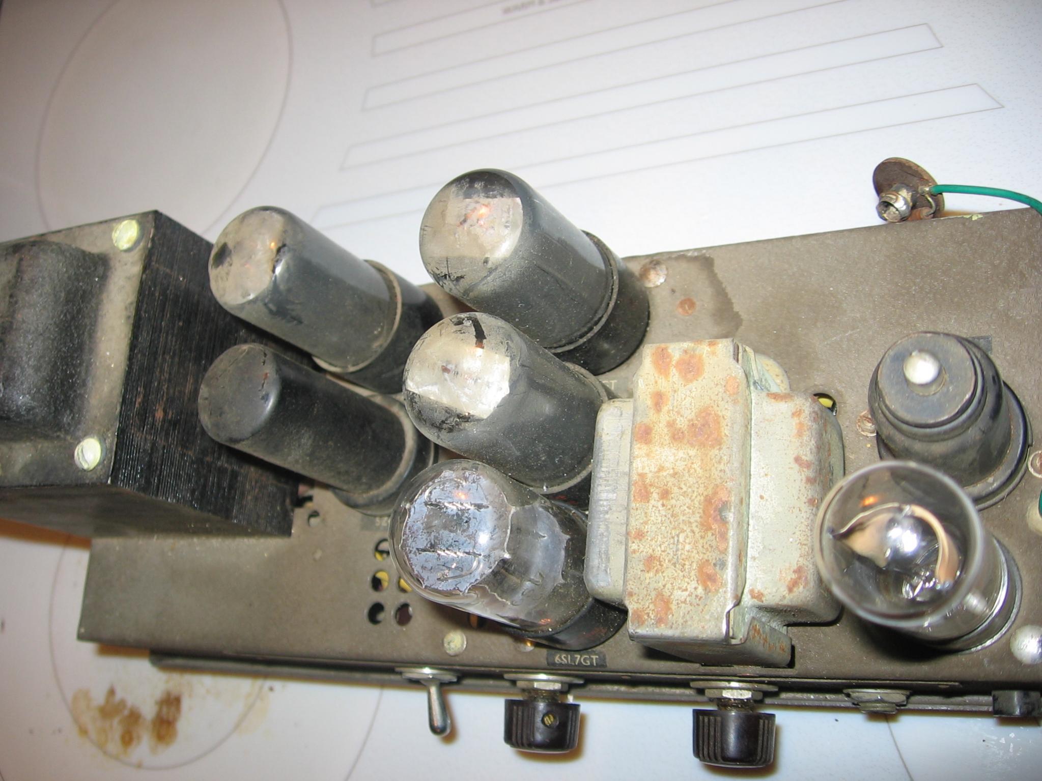

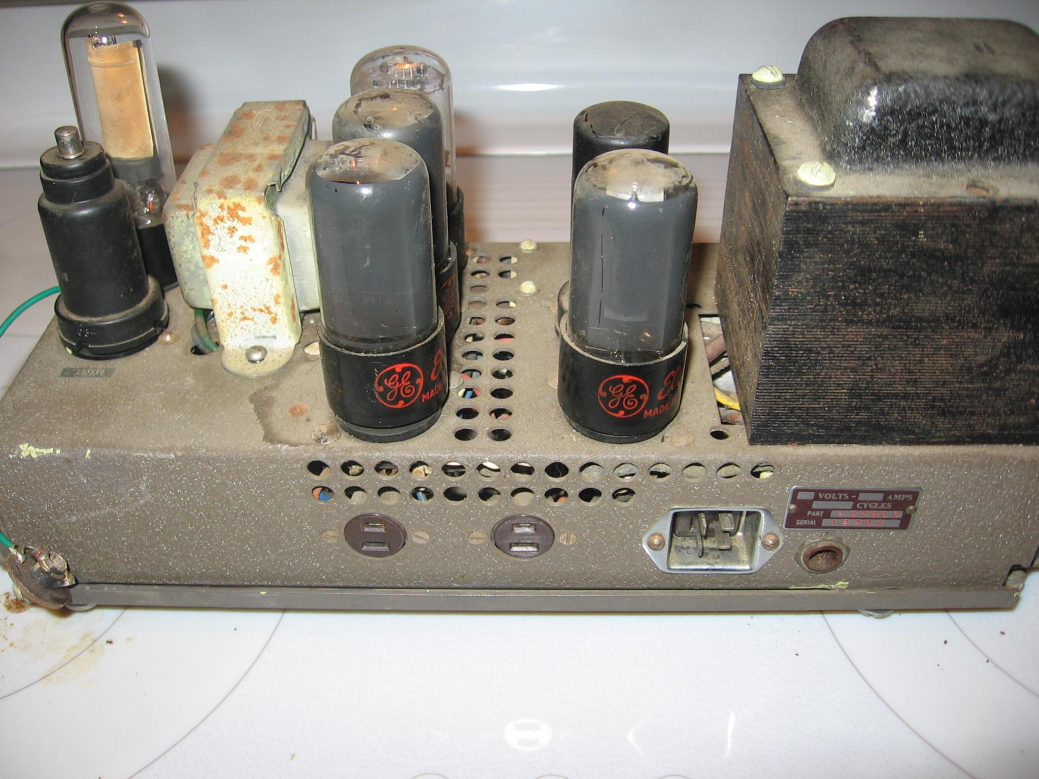

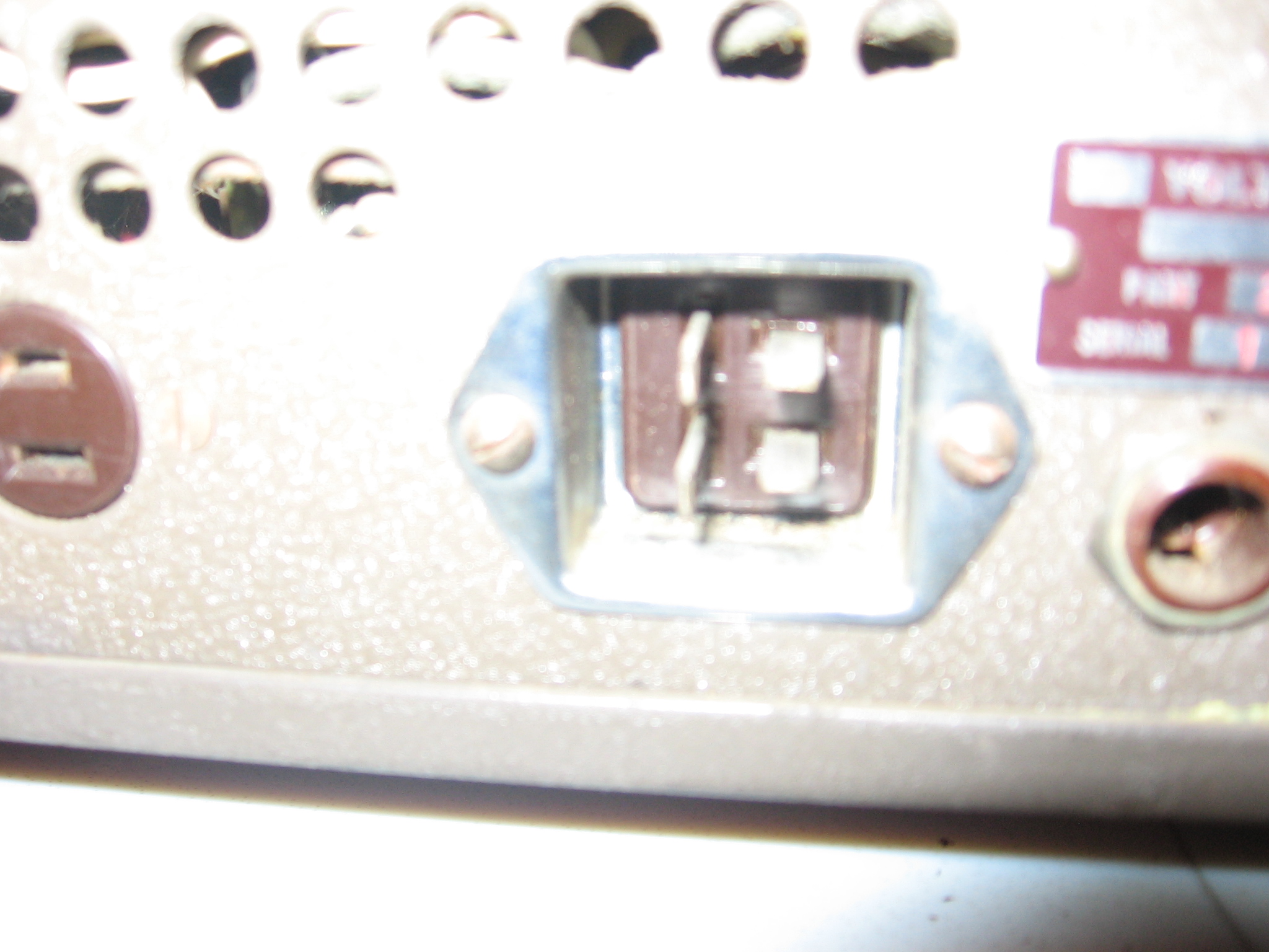

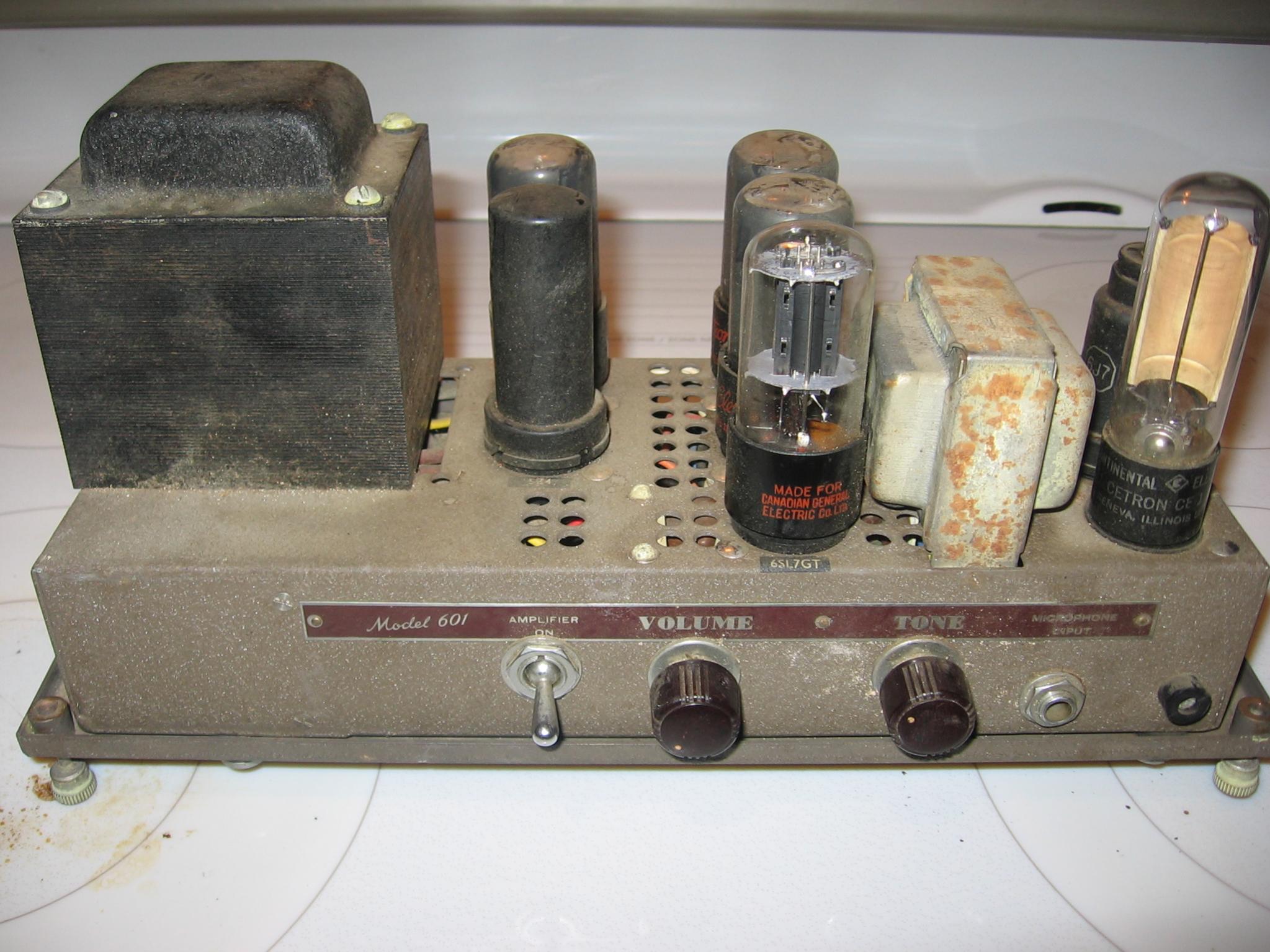

I picked up a vintage tube amp today. I have no idea with any details or how to begin to put it to use. Any help would surely be appreciated. On the front it says Model 601 and has a Microphone input. On the rear it has a couple of strange connectors, on the top there is a green wire that is not terminated. It has what resembles a fuse cup.
It has 2 6V6GT, 2 6SL7GT. It has a 4 pin unit that resembles a tube.
On the back it is marked 202000

The green wire plus "dohickey" is the top cap connection for what is likely a metal envelope 6J7 pentode.
The tube with a curved plate and a rod cathode is a photocell. I'm guessing the amp came out of a movie projector.
What look like 2 contact Jones connector sockets are probably speaker connections.
The rectifier is a 5Z4 metal envelope tube.
The power trafo looks "meaty" enough.
Stereo is out, unless you can find an exact mate. The makings of a guitar amp are certainly there. If you want go down that path, have the moderators move this thread to the Instruments and Amps "board".
