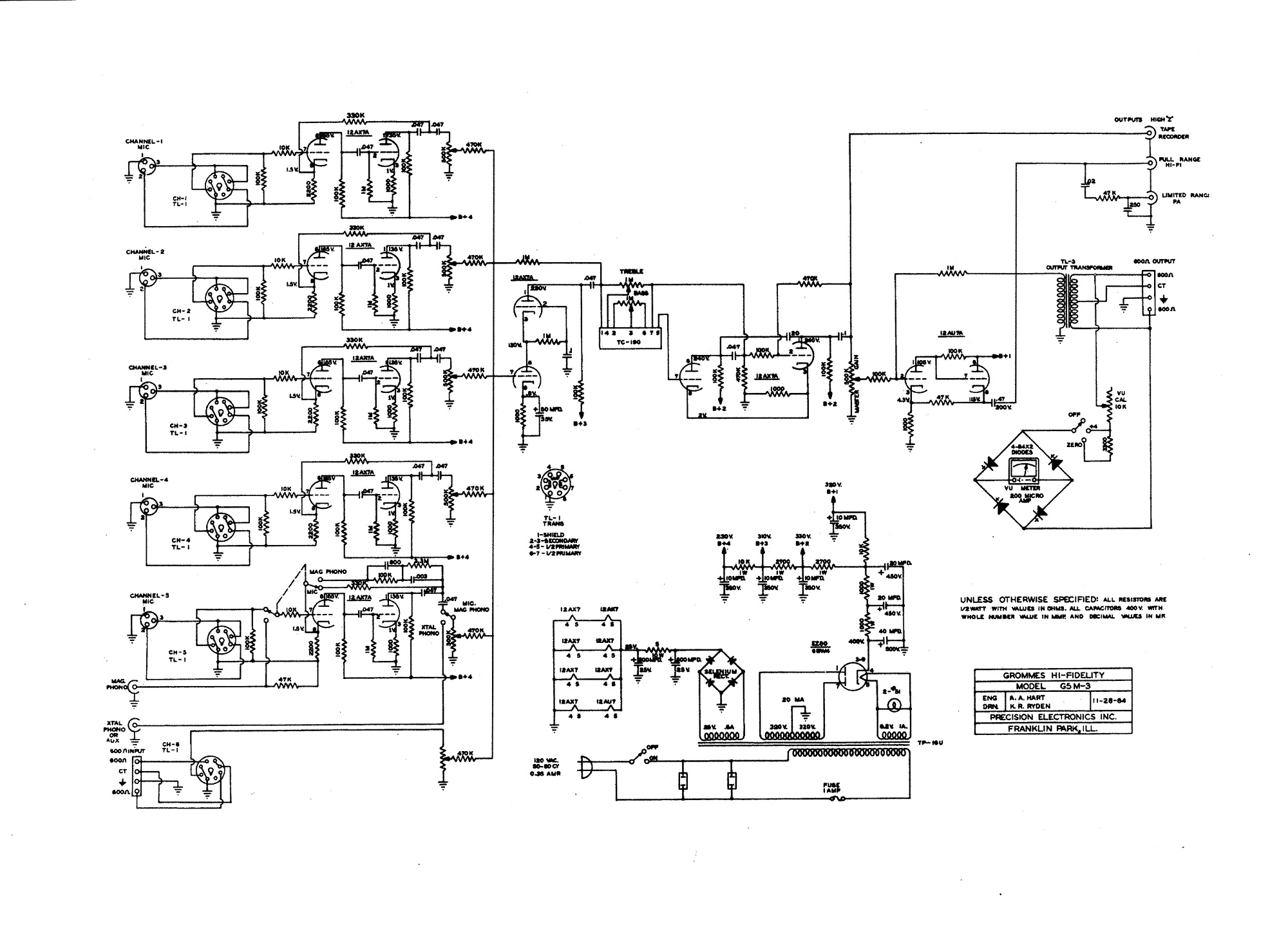

HI, I'm new here and I just aquired a cool device. Its a Grommes / Precision Electronics / Western Electric G5M Tube Mixer. Its a lot like the Altec 1567 Tube mixer but has a lot of important improvements. It has 5 transformer balanced mic inputs, , a line input, tube EQ, and a master gain stage. Basically I want to refresh and modify it. I would like to install DI inputs bypassing the transformer and direct outs for each of the 5 mic channels. It uses both sides of a 12AX7 per channel so I assume there should be sufficient gain for the direct outs. I want to use this as the front end for my DAW. I want the individual outputs for use recording drums and I want to use it as a mixer in its natural state for overdubs, utilising multiple mics into one output. What I'm looking for is any help with this. I could use a schematic if there is one out there. Maybe one of you guys has one of these? How would I go about installing the mods on this? Thanks in advance guys.

Problem there is: if it does not have channel outputs already, it probably mixes at ~270K impedance. You can do that when the whole mixbus is in one box and barely a foot long. It lightens the load on the preamps, saves a ton of money compared to low-Z mixing, money that went into better input transformers and nicer knobs. But it also means the preamp can't drive a length of cable, much less the typically 10K impedance of sound cards and other newfangled ana-digital gear.
The "proper" solution is to take the one existing output amplifier and duplicate it for each channel. You might be able to simplify/cheapen this amp, since it does not have to make-up mix loss and master fader headroom. Still it is likely to double the number of tubes and add a pile of iron.
Another approach, frowned-on here but practical, is to add a transistor or chip buffer to each channel. As Richard knows, you don't need monster tube power to smoke an ADC input. Fake-up a +/-15V supply, wire a TL074 (hi-Z input) as a follower; or derive a ~+30V 20mA supply and wire some 2N2222 emitter followers.

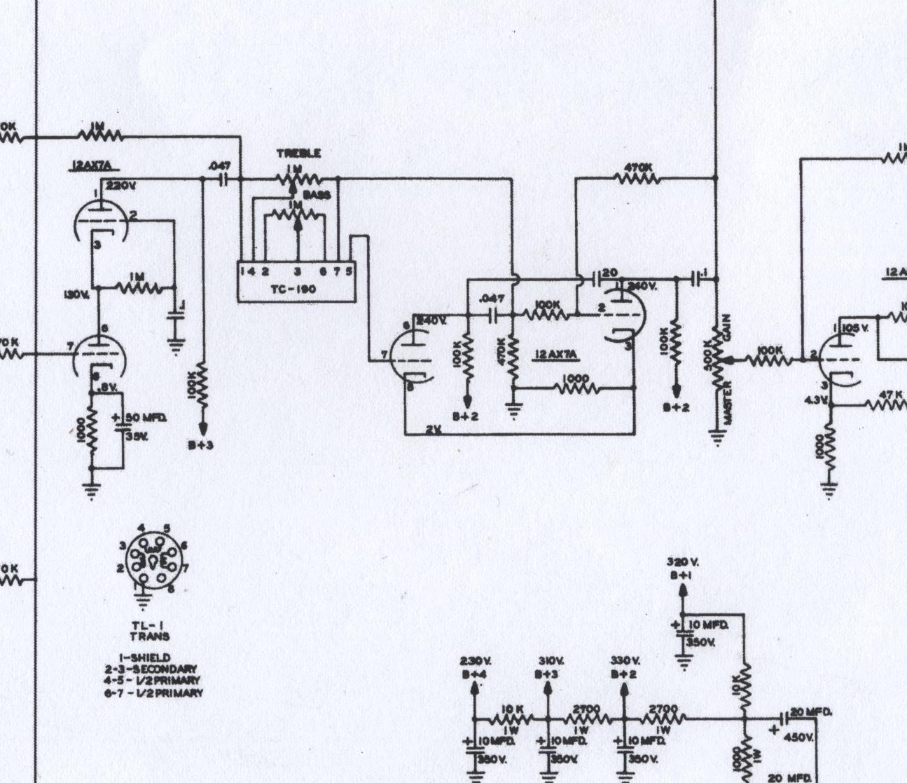

However, a basic mixer is usually not mind-bending to reverse-engineer. Think what "should" happen: mike transformer to grid, plate to next grid, etc. Keep a 12AX7 pinout handy and start sketching what you see. If you get one preamp you got them all. If the EQ is bass-treble, there's only about two standard ways to do that (feedback and passive). The output amp will be a 12AU7-kin with a transformer. If it was made for small work, single-ended; if made to drive long telco lines or many bridged loads it may be push-pull.
Wow, thanks for the advice. Since it appears to be so rare, I think I will keep it as is and clone the circuit for experimetation. If its as rare as it appears, I don't want to screw it up. I think it will work great as a mic mixer for mono drums (kick, snare, room) and guitars (mic on each speaker of a 4x12 cab) and Bass (DI and mic). Pretty much anywhere I would gang together channels anyway in the DAW, now I can just record one track with multiple mics. I did find a fellow who has a schematic (from ValveTone the plug in guys who modeled this eq section) so as soon as I get that I will get to work on a clone of this circuit. The transformers will be the hairiest thing to copy. Are most of these octal based plug in transformers similar in their pinout? I have some Dukane and McGohan plus that I may use for this. Any further advice will be helpful, thanks.
