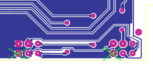

Hi Mike..
I find it hard to understand how you can get buzzing at zero vol and not have it with power amp disconnected from the pre?
I wonder if the balance control is at fault (trace)?
Check that the balance has still got a ground trace (continuity between the two crosses).

Its definitely a possibility, I remember the first time I dis-assembled the amp I had trouble removing the Vol and balance pot so I could have damaged the trace or solder joint. I'll check it very soon.
At the moment my hunch is that the input selector i/c got fried when I did the first mods; I mistakenly fitted a local decoupling cap the wrong way on the op-amp. The supply to the op-amp also powers the selector i/c so damage could have been caused by the wrong orientation of the cap. I remember getting a loud buzz on the first power up, this occurred 3 times but eventually went away by itself. Then later I noticed the faint buzzing sound so I opened up the amp and found the local supply de-coupling cap on the negative rail was badly swollen. I replaced them with the original caps and the buzz was still there so some damage was caused elsewhere in the circuit.
I have a new i/c on order which I hope to receive in the next week or so. In the meantime I'll check those ground traces on the pots.

The thing is I tried that already and the buzz is there even with no source and the volume at zero, on headphones and speakers. I have listened to the amp late at night with the volume right down before I modded it and I never noticed any buzzing before. It definitely a fault somewhere I'm sure. I'll have one more go at solving it and if I cant I'll just bin the PCB alltogeter and get some chipamp.com PCBs and a good diy pre plus 'Dantimax.dk' relay input selector and re-do the whole thing. It will probably sound better too.
Guess what guys?.....
I found the problem!!!!
The local supply decoupling cap on the negative rail of the input selector was in wrong polarity. I had a look at the service manual and traced back the PCB track and spotted the problem. I hadn't seen it before but the trace goes the opposite direction meaning the caps both 'face' the same way as you look from above. There is still a little buzz but its so quiet you have to put the speaker in your ear to hear it! I just have 'normal' amp noise now, much less than before.
