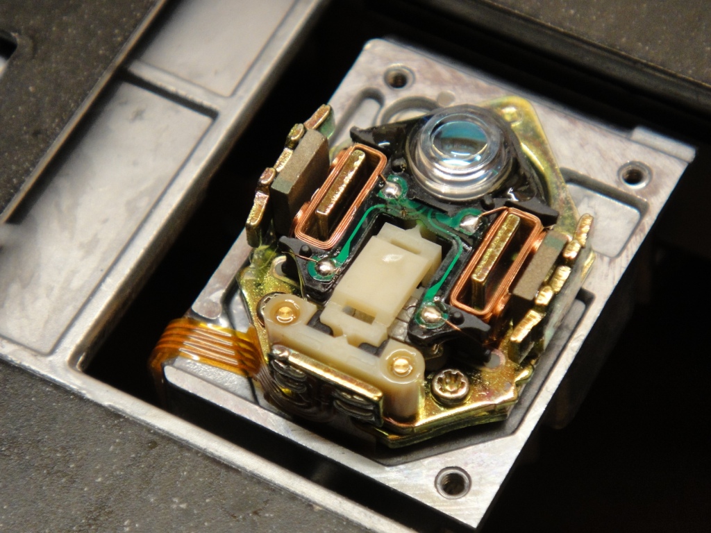

You are lucky in my view to have a proper plastic loader and laser mech. The lasers are easily and cheaply replaceable, and the loaders are reliable and endearingly clunky. The only weakness is the belts don't last long. Cleaning and re-greasing the cam drum and ball can make a worthwhile difference if you have some suitable 100% synthetic grease handy.

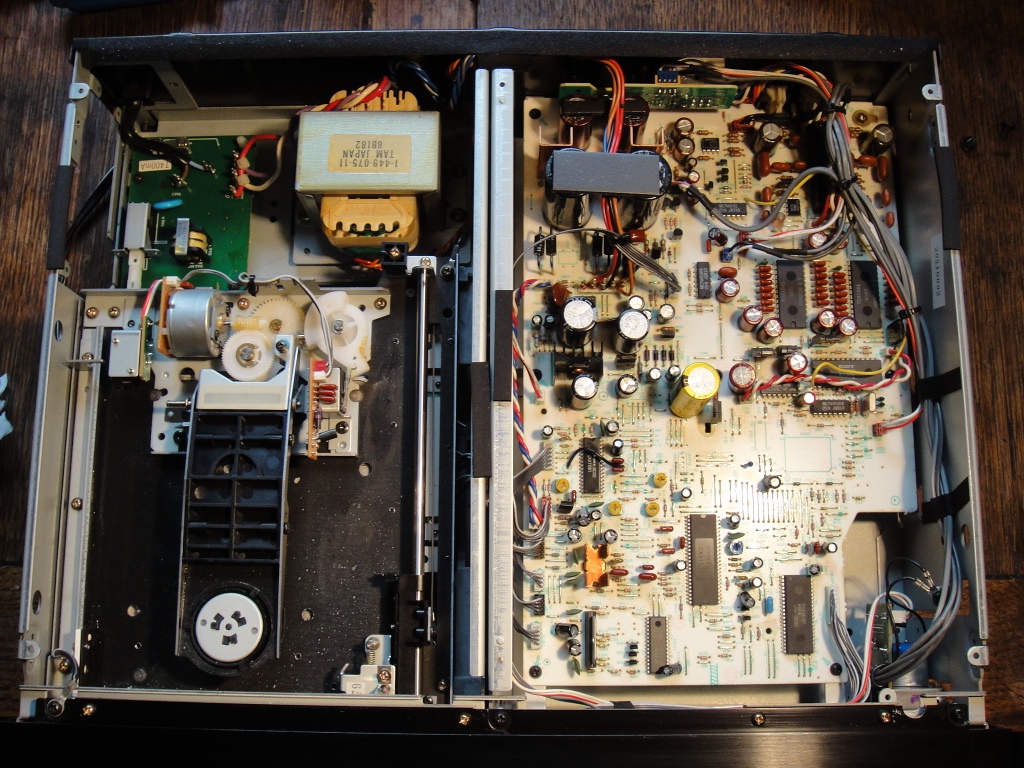

The player is quite plasticky and once you remove the metal cover and bottom metal plate, quite lightweight, but it mechanism is indeed fast and it reads discs faster than any other player I have. So, even for a ~25yr old player, replacement laser assemblies are available? Or only from donor units? The PCB is of high quality though.

I believe the KSS150A is interchangeable with KSS210A. Both are available from several vendors new. Possibly some are better than others, depending on origin.

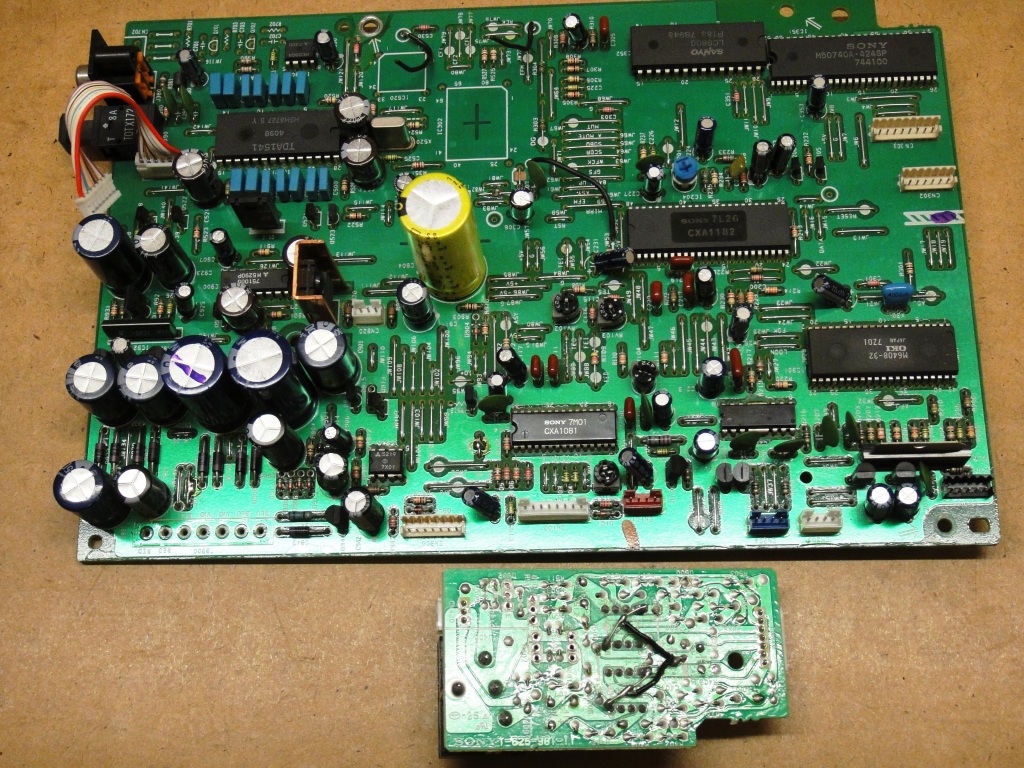

Well, I finished putting in the opamp sockets, 0.47uF MKP caps on pins 13/18, 0.22uF MKP caps on other TDA1541 pins, and replaced 4 of the 6 caps I intended to replace.
I made a mistake and ordered 4.7uF instead of 47uF for two of the Duorex caps, which kind of sucks, but I replaced the 470uF and 1000uF ones.
To get a baseline for the cap only changes, I put the 5532DD opamps back into the sockets and gave it a listen. The biggest change I noticed was there was much more bass after the mods. Seemed smoother as well.
Will let the caps burn in a bit with the 5532 opamps, then try the OPA2604, LM4562, and OP275 opamps to see what kind of changes they bring.
Before:
After: The MKP caps are much bigger, so 4 went on top, and 3 went on the bottom.
The new 1000uF Muse caps are really big and tall, and kind of get in the way of the opamp sockets and the cover may touch them as well, though I think I can manage. I knew they'd be big, but thought I could bend them into a convenient position. But it turns out they're constrained on one side by the opamp socket, another by the MKP caps, and on the others by each other or the other caps.

Before:
