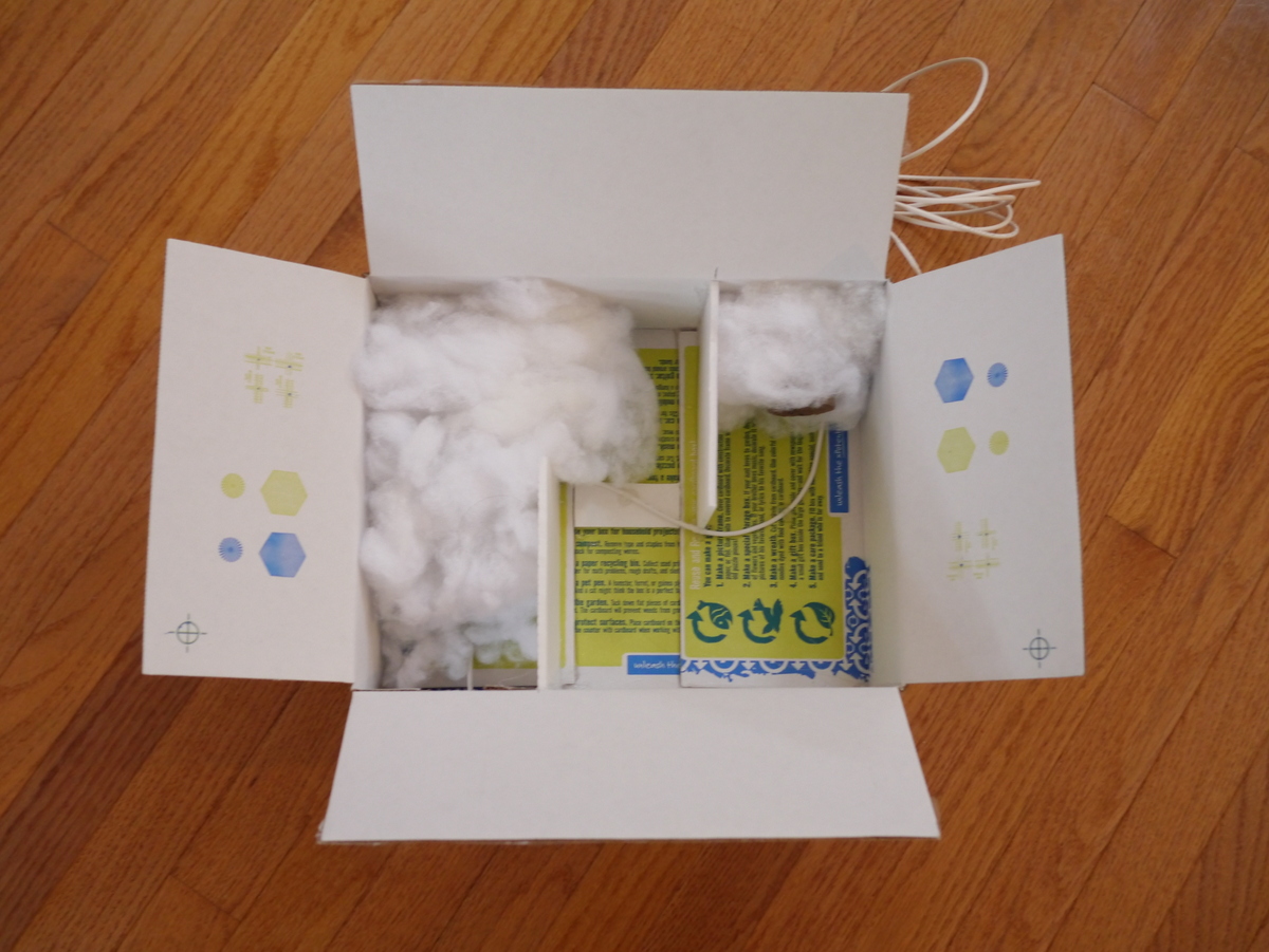

Welcome to your new addiction of diy speaker building The cardboard will resonate like a guitar body and produce quite a bit of sound. But it is not always bad as these speakers can sound quite nice.
My first DIY speaker was a made from a postal cardboard box. I then discovered that foam core boards work infinitely better more precise to cut and is nicer looking than the brown corrugated cardboard. We discussed foam core vs cardboard at length in this thread: http://www.diyaudio.com/forums/full-range/223313-foam-core-board-speaker-enclosures.html#post3239367
This is one of my best sounding cardboard speakers - it helps if the box is high quality double wall stuff. http://www.diyaudio.com/forums/full-range/223313-foam-core-board-speaker-enclosures-109.html#post3335376
The inside:
Have fun and good luck.
