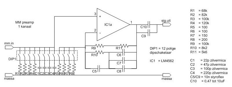

C5,C6,C7,C8,C9 are all the same 10nf styroflex.

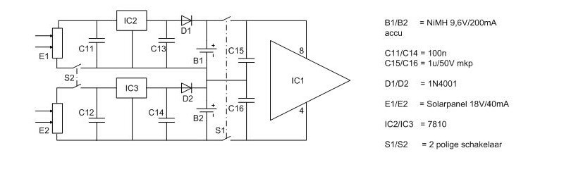

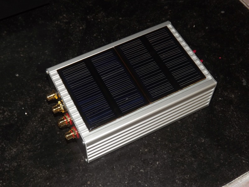

It runs for 20 houres, but when it is daylight it runs just on solarcells. Charging the empty accu's takes about 3 houres. But you can leave the solarscells on, there will no overcharge. At night when you have lights on it is better to switch off the solarcells, otherwise you can get some humm from your AC lights.
Ronny.

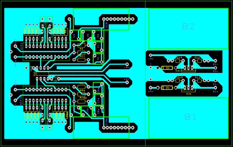

Hi, lovely idea and pcb layout. I used to use a single chip amp phono stage powered by a single 9v PP7 battery for long life. Wiring up a simple zener diode controlled power supply from a wall wart mains transformer was an astonishing upgrade. Moral here is that the power supply should have a low impedance, which a battery does not unless you regulate its output.

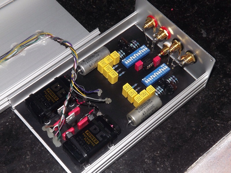

- MM phono preamp with accu and solarcells
