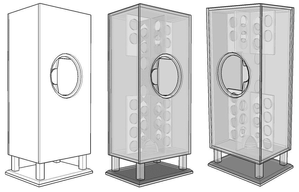

Scott did a custom ML-tl called Bison,
attachment.php
dave

That's great news then. I was reading at a forum earlier that mentioned the Bisons and that these were designed for small to medium sized rooms, but I don't suppose it would matter that much. I know that he can go big like 10-12+ cubic feet no problem, and I was also interested in what GM would think re the 604 III
The guy I sold my amp to has your Frugal Horn XL cabs and really enjoys them. He also has your fe206en drivers with your phase plugs. Also he was looking at some of your smaller bookshelf designs you had for sale, to use in his office and linked me some. I said I hadn't heard these newer designs but that you couldn't really go wrong as they should all sound good for their intended purpose.
Anyhow I guess I should try and talk with Scott and see what he thinks of the Bisons in a larger room, or if they could be enlarged some if need be. His room is 22'x30' and I think 8' ceilings. Low power valves will be the amp.

My default MLTL alignment for the [Fb] = [Fs] tuning required for high output impedance source is ~58-62" high with the driver offset in the ~0.33-0.42 [inside/i.d.] range depending on desired ear height, 30" wide min. [reduces/negates the need for baffle step compensation/BSC], depth as required [outside/o.d. dims] , ~0.84 offset or use bottom shelf vent or spaced up [adjustable] with bottom floor loading vent. Vent area [Av] = > [Sd]/4. Slot vents < 9:1 aspect ratio. Net [Vb] = [Vas] - [Vas]/1.44. Recommended [Qts'] range ~0.312 - 0.403

Thank you Greg, I will look through these links. That quote of me was my bad wording and sentence structure, sorry. What I meant was I mentioned about some of your MLTL's that I've read about, to the guy that wants to build some cabs for the GPA 604's he wants to purchase. He was recommended the Stonehenge V cab, and I told him to hold off a bit while I dig around and see if I can find some more info on something better, like an MLTL etc.
Would you have any plans all worked out for the GPA 604III for purchase that he could have his woodworker easily build from? This person that I'm inquiring for cannot diy at all, but he has a good cabinet builder. If not would you have any input on Scotts Bison design? I've messaged Scott but haven't heard back on how he thinks it may work for a larger room etc. I think the Bison cab is 290 or 300 liters, so 10.2413 and 10.5944 cubic feet.
