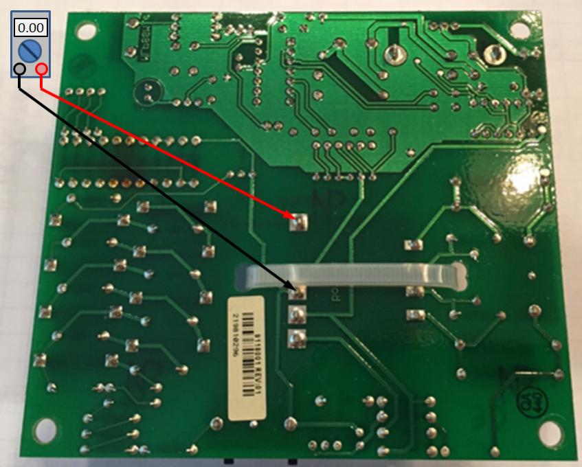

Ok will repeat the test on the good board. I also flipped the board over & measured directly
on the trafo output. Same readings. Can this be bought from ML ?
Guess it was just waiting to go down hence the volume issue that I experienced.
Thank again Bolserst.
Just to make sure, attached is pic of where you should measure the transformer on the back side of the board.
Andersonix was able to purchase a replacement transformer in the US a few years ago.

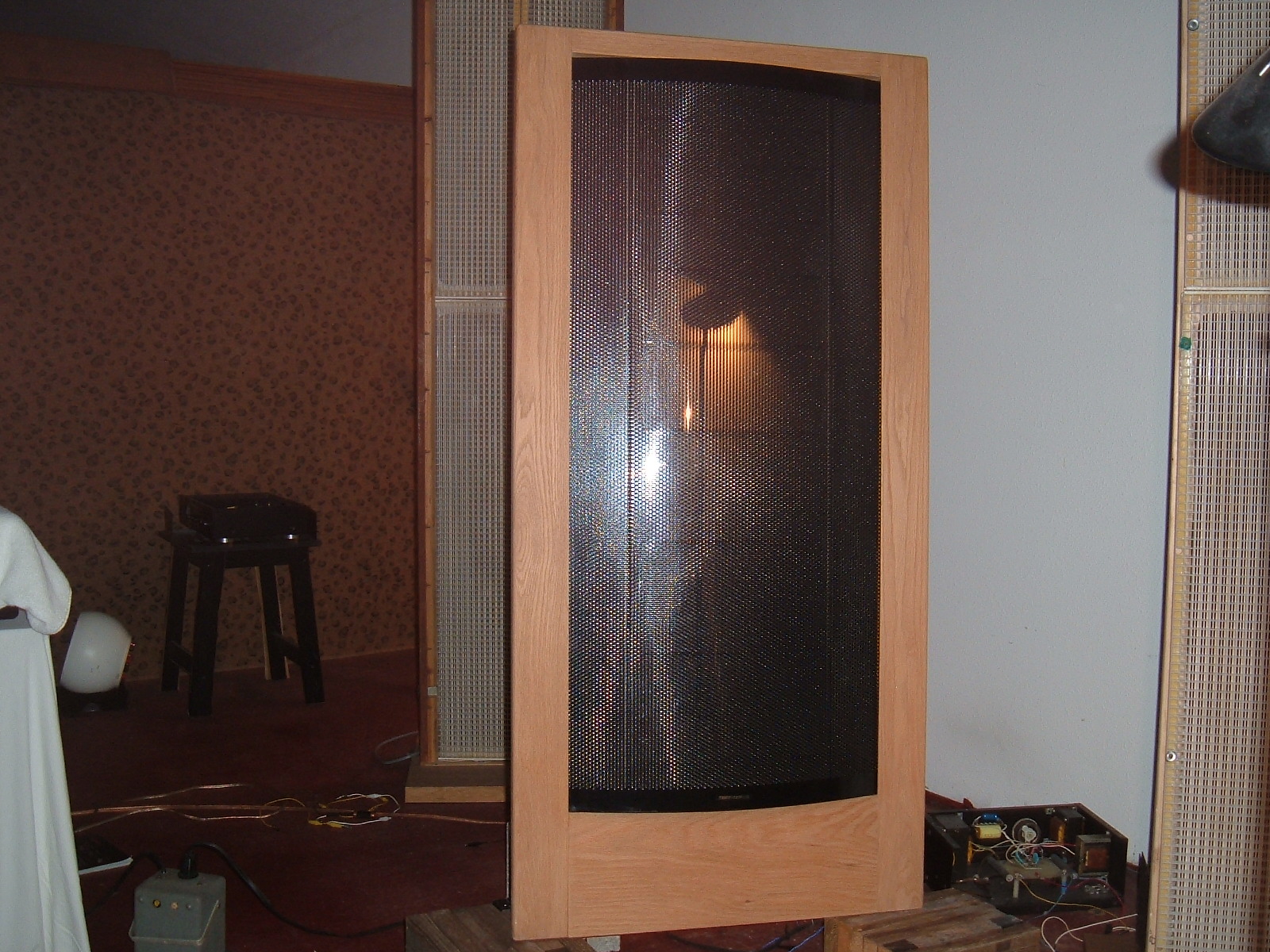

I have two bias that I can sat...3k-6k...cost less to diy...an the panels like all ESLs sound better....when bias on all the time!
But I do a lot of qiuk ck on ESLs panels...I pick up...two diy bias part setups.... less than $50-80

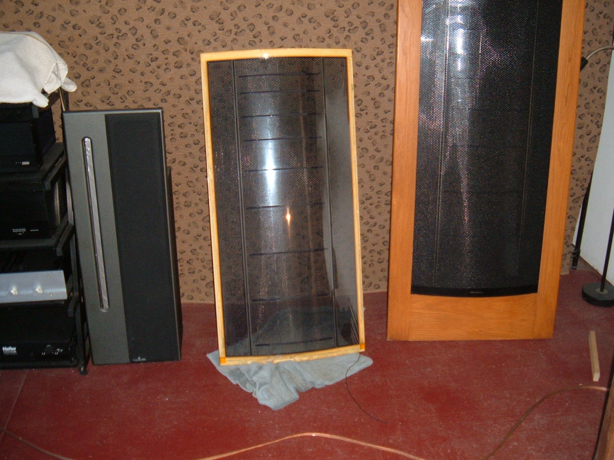

I forgot About when I re-work my CLSs...I put my own Bias togather ....on all the time..... sounds much better than stock...an a litte higher bias...4k...my babys are sounding Sweet
An playing.... as I type this...Before & after..
life is good...
just ck CLS the bias,,4k8....an ezey to drive....mind blowing room .25X18 ....50-60 watt tube amp work great...go fig
other say you need a lot watts....an these well play loud ac/DC..

Yes Bolserst that’s where I measured . Also if I measured resistance no readings, dvm just fluctuates
So definitely a bad HV transformer.
Hopefully the dealer in Indonesia or Singapore can get you a replacement transformer or board for a reasonable price. If not, let us know and maybe we can locate a replacement here in the US and ship to you. Of course shipping cost won't be cheap...about $35 USD I would estimate.
