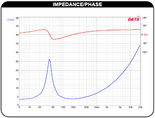

Remember that the impedance of the woofer will not be a constant 4ohm resistance. It has inductance as well. Attached is an example woofer impedance curve showing the rising impedance at higher frequencies caused by the inductance.
To compensate for non-constant impedance the values of crossover parts, like the capacitor, need to be adjusted to achieve the desired low pass crossover response. It is difficult to do properly without measurement equipment.

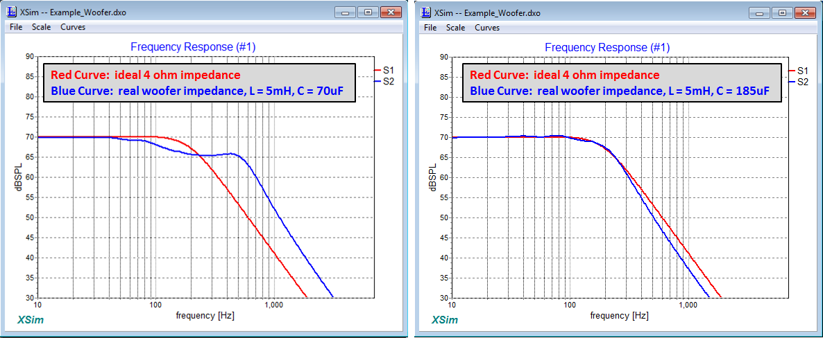

Yes, changing the capacitor value will change the crossover, but that is what is required to achieve the desired crossover response when the real woofer impedance is used instead of an ideal 4 ohm resistor. Attached below is an example to illustrate the difference in response when crossover parts are driving an ideal resistive load vs. driving a real woofer that has inductance. I don't have the impedance curve for the Odyssey woofer, so I just used an 8" woofer I had on file. In this case a capacitor value of 185uF provided the best fit to the desired crossover response.
- The red curve shows the desired crossover response for the woofer.
- The blue curve in the left plot shows that when the component values for an ideal 4 ohm crossover are used with a real woofer, the crossover doesn’t roll off until well above the desired frequency.
- The blue curve in the right plot shows that if the capacitor value is adjusted upwards you can achieve very close to the desired response even when used with a real woofer.
Every woofer and crossover frequency will require unique adjustments to achieve desired response. Without measurement equipment, it is difficult if not impossible to do.

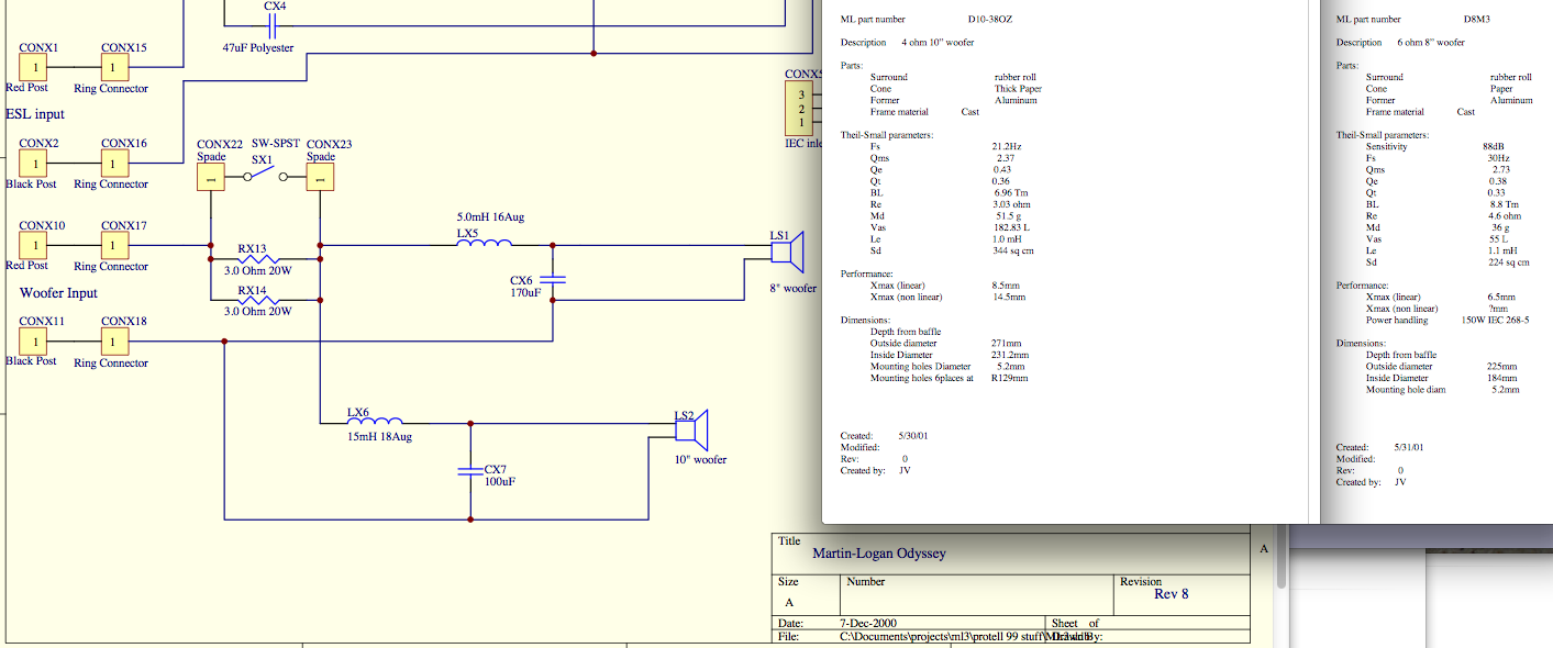

Here's what we're looking at in one place, attached.
Ordinarily it would be easy to suggest using active xo on the bass, but on Odyssey there are two different bass drivers doing slightly different things (in separate sealed compartments), so one would need 1 channel of xo & amp per woofer, which could get a bit involved.
All that in parallel is a miserable load for any amp. Try passive bi-amping? Whatever you do, don't use the bass cut control.
