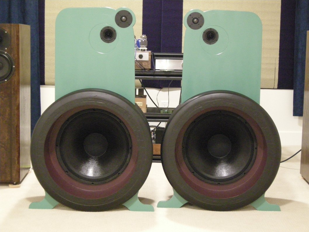

Check the photo, I'm half way into it. I'll coupe it with a 83db driver and forget the L-pad. I might try a super tweeter for a bit more sparkle. Heeeeeee Hope it sounds good. Let me finish the baffle first and have everything installed. Will let you know for sure.

My lovely wife said I never stop. I've been busy for my business at the day time and again very busy with my hobby after dinner, and sometime early in the morning- the time before I leave to work 7.30 am.
To answer your question, I've done something this afternoon to keep them standing like a rock - hope so heeeeeeeeeeeee.

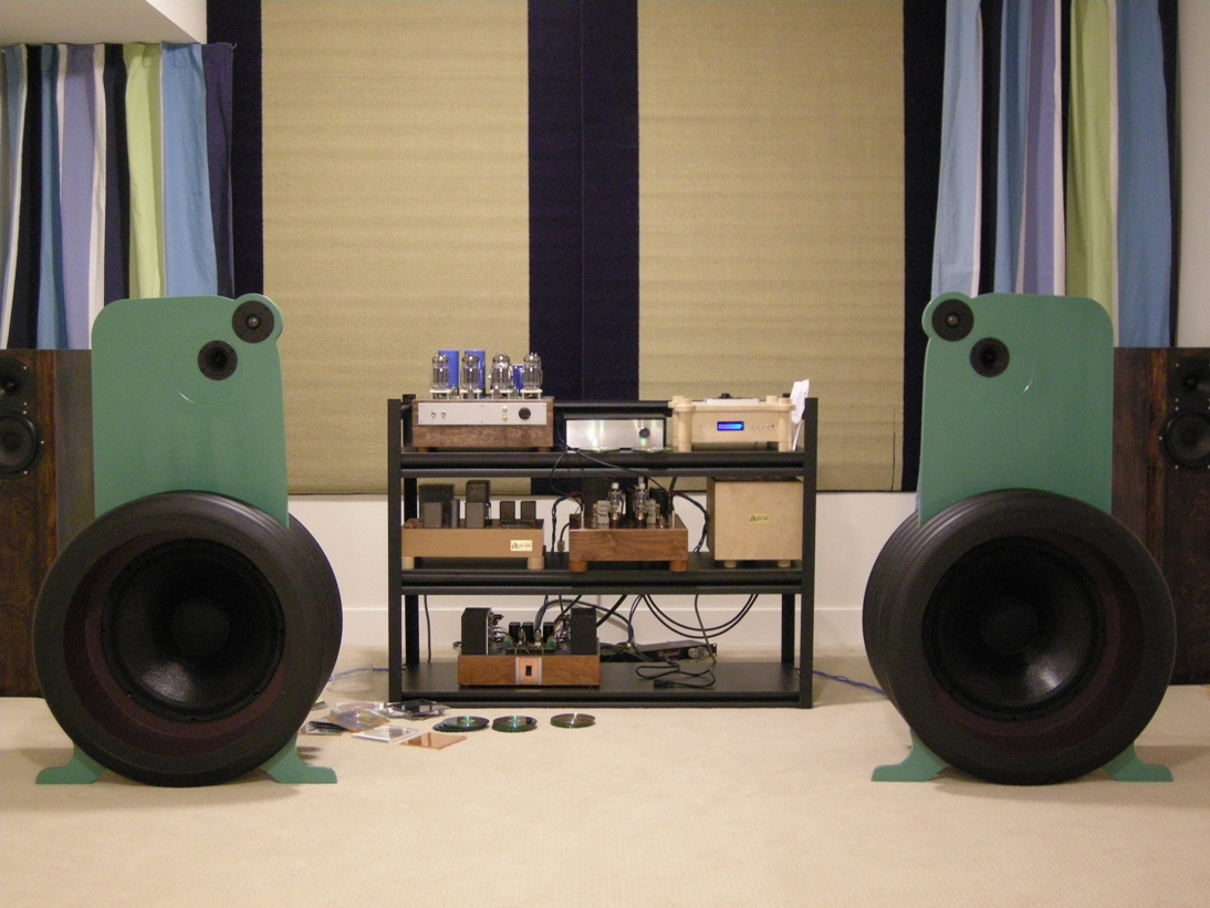

Here's how I'm using my MJK Goldwood H-Frames now... Fostex fe108esigma's in BIB cabs firing upwards and hung tight to the wall corners via L-brackets.. Goldwood H-Frames underneath the BIB cabs positioned tight to sidewall and 7'' from the back wall (the actual back of the driver from the magnet is about a foot or so from the wall).. I am able to get away with this due to the open area to the front hallway (I assume).. The sound is excellent with awesome imaging, the musicians are all in the space of the opening between the cabs to the hall, either center stage or off to the left or right depending on the recording etc:cool: The bass back at the listening position is really good and very realistic to the instruments being reproduced. The Goldwoods in this design are excellent for the money!.. Time has to be spent on placement but once you dial it all in:D
The time stamp on this last pic is not valid..
Dave, i've hear BIBs (165k and 168z) with H-frames and think it might be one of the best combinations possible for a home stereo. I'm sure what you have there sounds incredible!

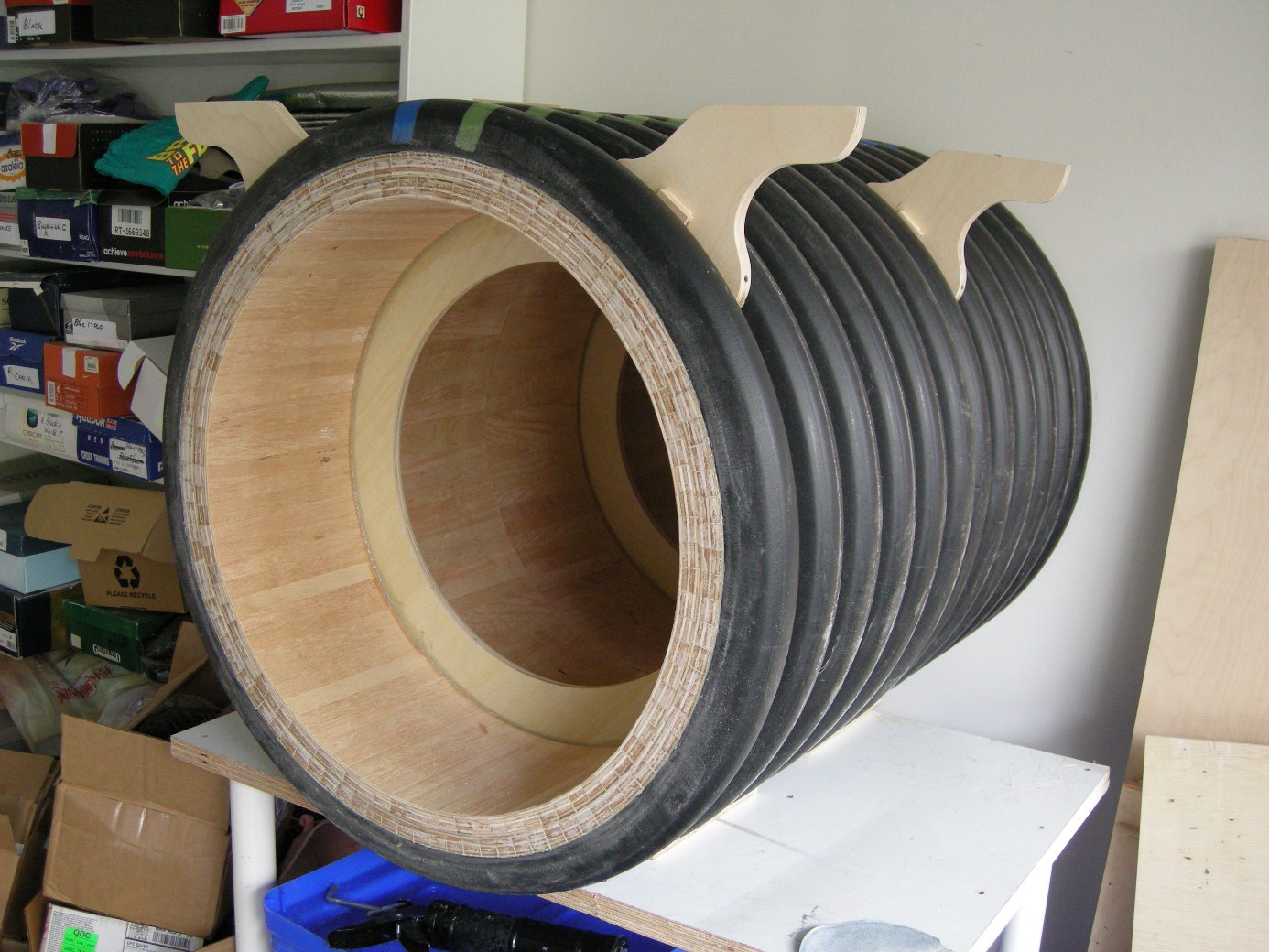

I lately re-do my H Frame with some polyurethane pipe with ID 24", OD 30". I filled the ID so to make it 21". The size is very humble and my old daring's face changing color like rainbow every time she looks at them. I quickly have them moved to my basement after finishing the paint. Still have to wait for some parts to come. Stay tune.

Well I have finally put the bits together to make some noise and WOW! The sound has amazed me. I have never really listened to a “good” sound system before and the difference is amazing. I was expecting my wife to get most of the benefit as she is the musician and I have been working in loud environments for years, but I can hear little things in music that I have been listening to for years and had no idea was there.
As you can see from the pic, I made a few modifications to the dimensions which with hindsight was a bad decision, though it does place the drivers at the height of the TV where a large % of there use comes from.
There is one thing that I do need to improve and that is the bass volume. While the lower frequencies are defiantly there and are wonderfully clear, they are at levels significantly lower than the midrange (and while I can't be sure without measurement I think there is a big dip around the crossover region). This is probably caused by 1. my modification, 2. my positioning of them so close to the wall and 3. driving them with a HT receiver. Over the next few days I will try playing around with different outputs of the HT amp (bi amping and connecting the H-frame to the sub output) but if that doesn't work I will build some sort of amp.
Any suggestions or guidance on what might be worth a try would be appreciated.
My very humble speakers are singing for me for almost 20 hours now and it sounds very deep and wide with thundering bass. The RS100-8 is a bit small so I don't expect it sounds as big as the 8" driver. It sounds not bad with smooth sound through the whole spectrum, but lack of mid bass kicks and cello was found a bit too thin. There is lot of room for me to tweak it.
I have 51uf 9mH on the RS100, 1uf 0.25mH on the tweeter and 150uf 13mH on the 1858.

Unique design. The H-frames... or should they be called O-frames... look amazing. Have you fixed the baffles to the H-frames or can you replace them in the future with something else? I always wanted to hear those dayton reference drivers.
Yes, I did fix the baffle for the RS100. I can replace the A12 back there, I miss that so much. The RS100 sounds a bit too small in my room. I try it on for matching the 1858 and see what wonder they could do.
Another idea, I would instead consider matching the A12 with Eminence A15, A15 97db and A12 89.3db. What do you think/idea ???
