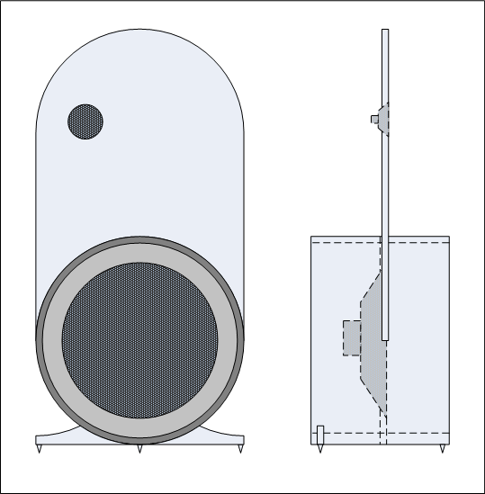

OK, so now I have to embarrrassedly admit that I was wasting Martin's time with what might turn out to be a hypothetical question, since this is quite a ways down on my project list.
The illustration shows my (not very carefully thought out) idea so far. A sonotube of a little over 22 1/2" inside diameter would meet Martin's requirement of same area, and that's the way I've drawn it - this is an unlikely size for sonotube, so I also didn't worry too much about drawing it with a 3/4" thick wall.
If I actually got around to doing it, I'd likely buy 24" sonotube and fill the inside wall with something (felt to damp ringing? bendy plywood covered with veneer?) and veneer the outside.
I've drawn the baffle for the Jordan as a simple vertical 3/4" piece of ply with a hole for the sonotube. Again, if I were to actually implement this, I think I'd try to make a baffle where the front face curved towards the front as it went to the bottom, so the top edge would be 3/4" thick (or thereabouts) and the bottom maybe 4" thick. The easiest way to do this would be to build ribs and panel them with thin plywood front and rear - then fill in the voids with sand, kitty litter, or expanding foam, depending on weight and convenience requirements.
Probably you'd want to make the simple baffle first to find the correct fore-and-aft alignment for the drivers.
Anyway, that's as far as I had got. Do show us if you implement something with your sonotube.
Regards.
Aengus

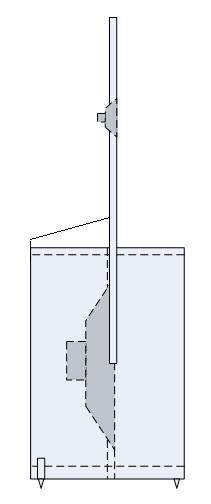

Hi Brad
Your suggestion should look pretty good as well. Both your and my ideas have (if I'm understanding your description) the drawback of having to make a large precise hole in the baffle, so it fits around the sonotube, but at least with your design you're not trying to make the hole through a thick, curved-front one!
You still have the problem of connecting the two rear spikes to the sonotube in an aesthetically pleasing fashion - I'm not sure how I'd tackle it.
I attach a sketch showing what I think you described, and showing one possible way of attaching the rear spikes - don't know that I'm all that keen on the leg shape, though. What did you have in mind?
Regards.
Aengus
Regards.
Aengus

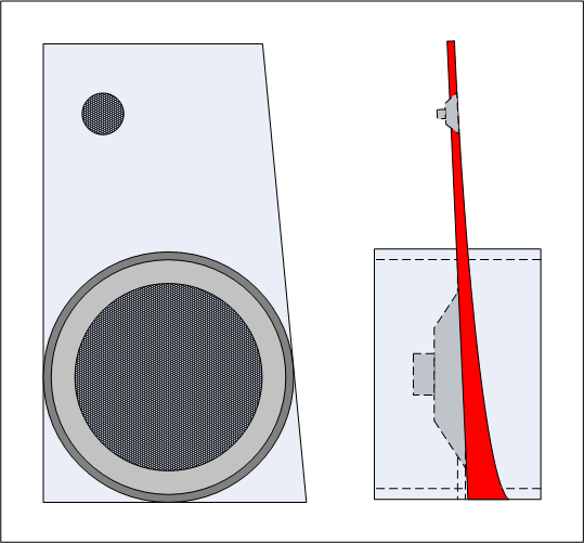

Hey Aengus,
You are pretty good with that sketching. Note that the baffle for the Jordan is 20" square. I was thinking since the sono will probably be wider than the upper baffle the sides would be stratight and not extend as far down Now seeing your sketch I probably wouldn't have as large of a radius at the top.
Other words more like this but the bottom fitting the sono.

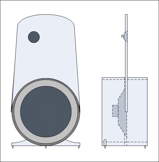

Brad, those look pretty good. The trick in the sonotube design will be finding an upper curve that harmonizes with the sonotube's curve. What about tapering, so that the baffle is 20" across where the Jordan is but widens to fit the sonotube?
Damn, I'm starting to want to build this thing.
Regards.
Aengus

What are you using to sketch this with?
Visio. I use it often and find it pretty fast and intuitive by now. Sketchup would obviously be better for 3d views but I struggle every time I use it. I should get Dave (Planet10) to give me a lesson - he does great stuff with it.
Details of attaching the upper baffle to the sonotube need to be worked out - the problem being that I don't think the sonotube walls are all that good for fastening to. I expect you'd have to glue some longitudinal braces to the tube and fasten to that.
Regards.
Aengus

It could be free standing with one leg in the middle of the rear of the baffle like this and use just a couple of screws just to keep it from moving around
That should work and look good. I think I'd glue that rear brace to the sonotube though, not just rely on screws. There'll be a lot of leverage against it if someone pushes on the top of the baffle.
