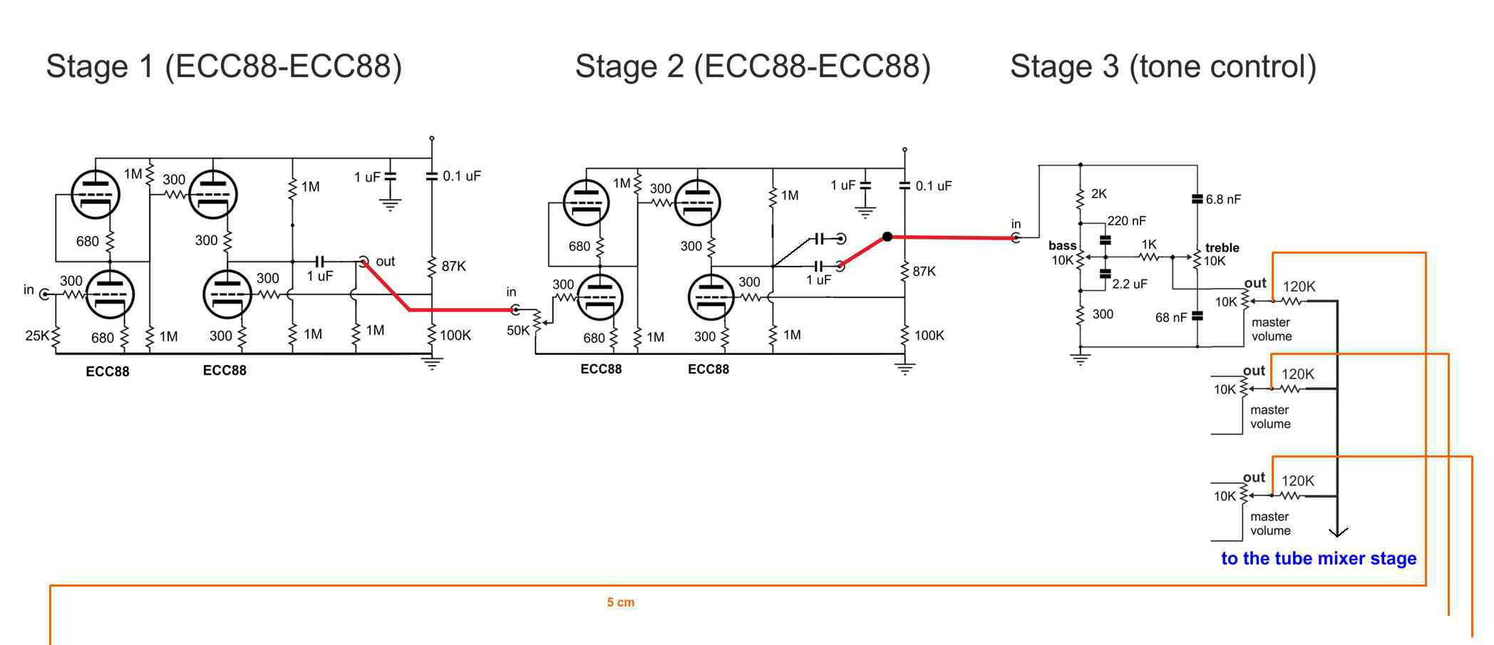

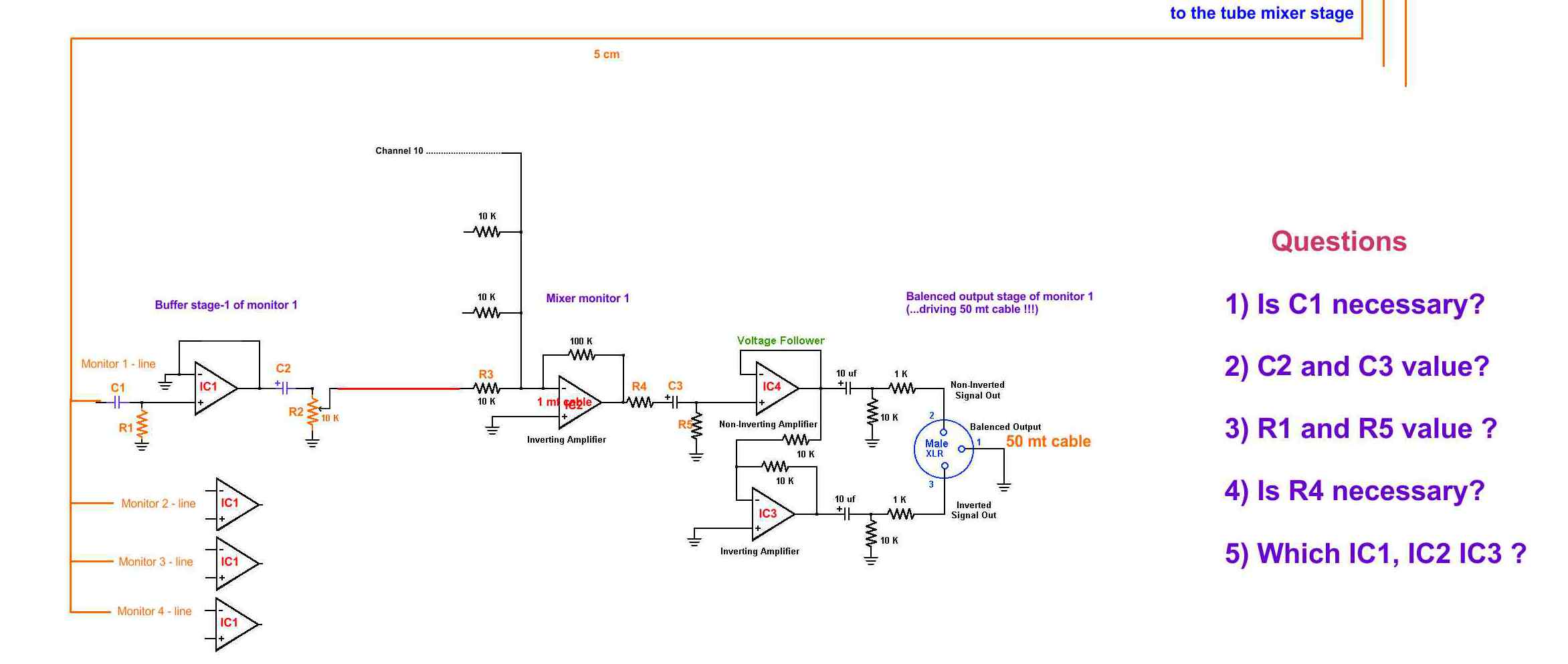

I'm projecting a 10 Ch mixer tube, with an IC output section for 4 monitors (...where a high quality of the signalit is not necessary).
1) I'd like to know if the outputs IC sections (for the monitors) may affect the signal after the tone control section.
2) Somebody can help to answer to the questions reported into the IC section?
