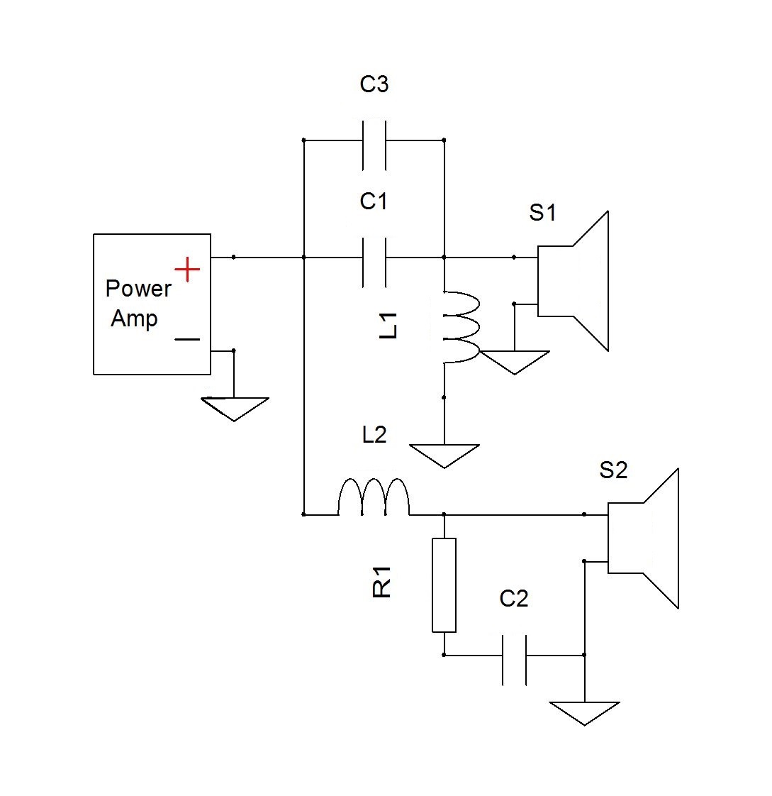

I have a pair of 751 and a pair of 751 Freedoms. I have recapped my Cyrus One with great success and now wonder if I should upgrade the components on the 751 crossovers, rewire them inside, and mess about with the filling. Does anybody have a circuit diagram for the crossover(s) and any experience of modifying them.

The 752 maybe similar. It has series inductor to bass with 15uF bipolar in series with 10R across the driver.
Tweeter has 6.8uF polyester, series 1R and a shunt choke across the driver - a typical 2nd Order

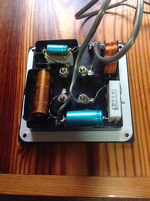

Thanks for the input. I've swapped the speakers out for some 750s and I'll pull the crossovers out over the weekend and have a look. Is it Ok if I post some pictures then ?. I'm not too sure about where the 6.8uF tweeter polypropylene should go. I was tempted to replace the caps with Ansars - Cricklewood Electronics - CCTV. CCTV Equipment. CCTV Systems. Digital CCTV Cameras. Does that sound good ?. I'm a bit new to this so any pointers (idiots guides) very welcome. I've also got some Chord Epic to rewire the innards.
I’m sorry - ref the 6.8uF I should have including the following photos from inside the crossovers. I’ll know a bit more when I get them out altogether. This is all a bit new to me.

All I see for sure there is a 3.3uF bypass capacitor and a 5.6 ohm wirewound. You'll need to trace out the circuit. Maybe unglue some components too. Usually hot glue which melts easily if messily in hottish water.
Most capacitors are safe up to 85C, which gives you some margin. Of course you then have to dry out the crossover with warm air. The blue cylinders are non-polar electrolytics, which deteriorate with age, being full of wet electrolyte.
Those Ansar polypropylenes look OK, but size will be a consideration. Putting them on bass shunts can raise issues of resistance change over Non-Polars too. Easy on tweeters.

Had a look at mine and it appears to have a 1uF cap in parallel with the resistor which I don't understand - unless I'm reading it wrongly. I would be great if somebody with a bit more electronic knowledge could explain.
Found this photo online.
