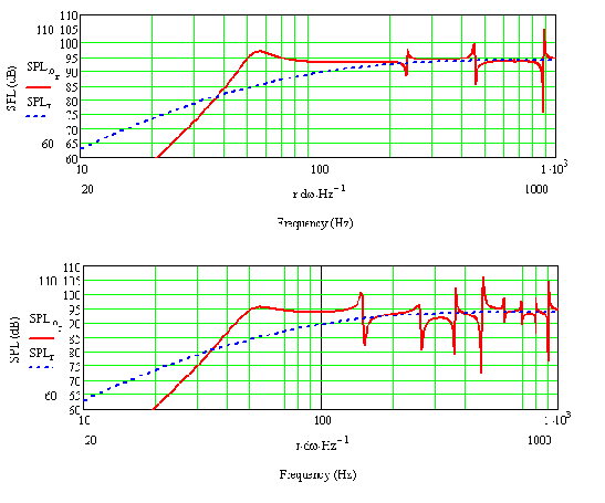

Well, assuming it's a BR, then you want as even an air particle density / distribution as possible, which is most easily attained by using golden ratio. Sticking to this should itself minimise standing waves. The overall dimensions of an enclosure do have a considerable effect on its behaviour. See the attached FR plots: two cabinets, tuned to the same frequency, with very different harmonic resonances due to their respective geometries. The first is an untapered box, the second is expanding. Basically, an MLTL & a (ML) TQWT.
Smaller internal differences such as those you're proposing should theoretically break up some resonant modes a little, in the same way that, say, room diffusors do. However, as pointed out above (IIRC, Linkwitz also mentions this WRT rooms), this can be a bit of a double edged sword as you're going to move them around & make it harder to predict in advance where exactly they're going to be. Having said that, I'd say it's worth doing, especially if you happen to be using drivers with paper diaphragms, if for no other reason than it should help reduce the potential for direct reflections from the rear cabinet wall back through the cone. The devil is usually in the detail. And if you can shift standing waves to a higher frequency, these tend to be more easily dealt with, requiring proportionally less damping.

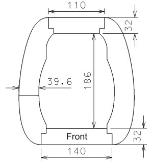

I am building a "small" surround speaker using a 4" Seas mid and 3/4" tweeter. The box is made from layered walnut. I cut 1" thick planks into rounded shapes (difficult to explain without a pic but I don't have one ATM) and stuck them together - much like this: http://www.humblehomemadehifi.com/Humble_Statement.html
The sides of the boxes are rounded and they taper from the front to the back. Only the front and back panels are parallel. The front panel is about 1.75 times wider than the back one. At no point is the wall thickness less than 1.5" thick so these boxes are VERY sturdy - no chance of the sides playing along! I was just wondering if there is any chance of the two parallel sides messing things up. It is a BR design.
Don't kid yourself: the panels will still resonate, but they're unlikely to do so in its operating BW, so you'll be fine. Nice materials BTW. No, if you damp the back-wall of the cabinet, you shouldn't have any problems. The horizontal standing waves that will occur will be at a wavelength easily absorbed by the damping material.

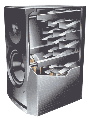

On the actual subject, i always liked what they did in the B&W DM302...
dave
