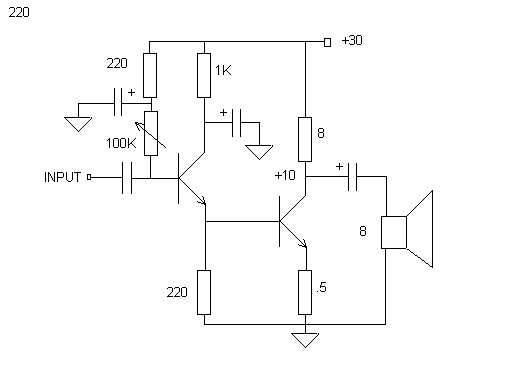

Minima SE Class A amplifier - help please

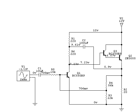

Guys... hê-hê... again today I sat down and stared at the tangle of wires and remembered something I read about Darlington step being good for high gain and drive...
I tried it! I made a Darlington pair with the 3055 at the final and a MJE4919 - input drive is done by a BC560.
Sound is fairly neutral and gain is massive! Had some oscillation issues but sorted that with a cap and resistor here and there.
D

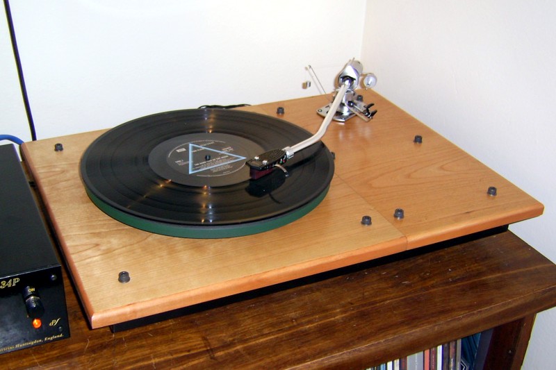

Uhmm - much obliged... yup, that is me!
and my system (more or less)
My latest turntable - the DEWAUDIO Credence - see attachment
D
Dank u voor uw bijdrage - ik waardeer het werkelijk. Nu kunnen wij deze ontwerpen bespreken!
Thank you Tschrama!
I am glad you see the design goal here and contribute by supplimenting the circuits.

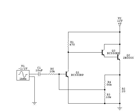

Last night whilst testing I noticed the circuit picks up AM broadcasts... is this natural? How can it be damped?
D

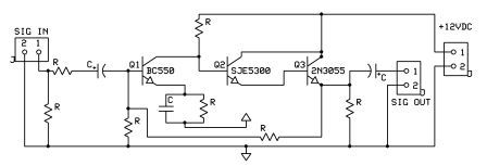

GlidingDutchman said:
This scheme works the best! Very good overall response and good drive. Noise is very low and so is the destortions.
I would like to build a neat little headphone amp with it. Any others game?

hi.
there are 3 connections to any amplifier
1. Source. signal input
2. Supply. power energy input
3. Load. Signal output to Load
We can say 'an amplifier' is an adapter between input Source & Load.
An adapter that will amplify input signal and adjust it to Load requirements.
CD-player output ->>> Speakers 8 Ohm
wont work, you know
When setting up an amplifer, we need good info about those 3.
Source.
Cd-players, normally, would want at least 10 kOhm - 22 kOhm load to work into.
( 8 Ohm or 55 Ohm, AKG K 240 MK II, will need too much current for CD output )
This is why we need an adapter. A headphone amplifier.
:cool:
I think I have what I need.
I be back with my circuit suggestion.
I will use mkax 3T or max 4T design. (max 4 transistors)
:) Information of The Three factors. :)
1. You will feed from a CD player.
Input impedance, resistor, needs to be like 10-22 kOhm.
2. Power input = 12 Volt DC lead acid battery.
Good if amplifier does not take excessive currents = empty your battery in a few hours :D
Battery has a good feature. Has got no 50 Hertz hum problems.
It is clean and good power, without a lot of filtering electrolytic Capacitors.
3. Output. LOAD = 2x 55 Ohm AKG headphones.
The sound pressure produced (sensitivity) is:
91 dB SPL per 1 milliWatt,
(or +104 dB/ 1 Volt rms input)
4. Output devices. One or two 2N3055 power transistors.
AKG K 240 MK II
http://www.akg.com/site/products/powerslave,id,1063,pid,1063,nodeid,2,_language,EN,view,specs.html
Type semi-open, dynamic headphones
Sensitivity 91 dB/mW, 104 dB/V
Frequency range 15 to 25,000 Hz
Rated impedance 55 ohms
Max. input power 200 mW
