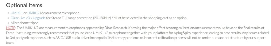

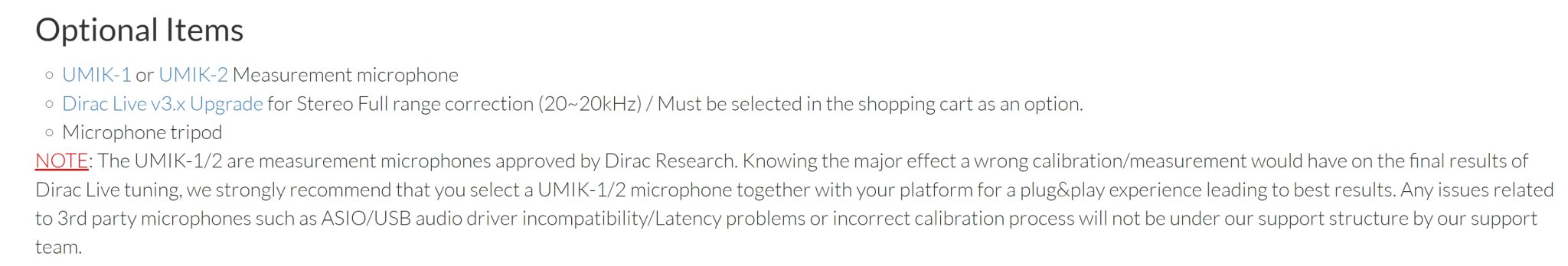

Interesting, considering that the measurement / filter generation software I think most commonly used in conjunction with the miniDSP - REW- and the Device Console itself reside within an attached computer. Do folks like myself who’ve successfully incorporated let’s say a 2x4HD for multiple subs or PEQ of speakers with passive XO’s using a UMM6 or similar, and at a later date consider upgrading the same box to DL need to buy a new mike?
I don't know for sure but I think the answer is yes. From the Flex 8 product page:

I have, and you are correct, no other mic will be recognized when you run Dirac which with MiniDSP products must now be launched from the console. MiniDSP is very specific about this in the user manual. I also have Umik-1 and Umik-2 and like you prefer the Umik-2. I currently have an SHD Studio (digital version only) and previously had a first gen SHD.
Thanks for that confirmation, Kevin. Not necessarily a deal breaker for some folks, but could certainly open up the used market for UMM6, etc. :)

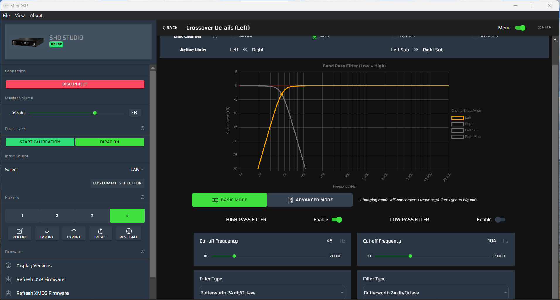

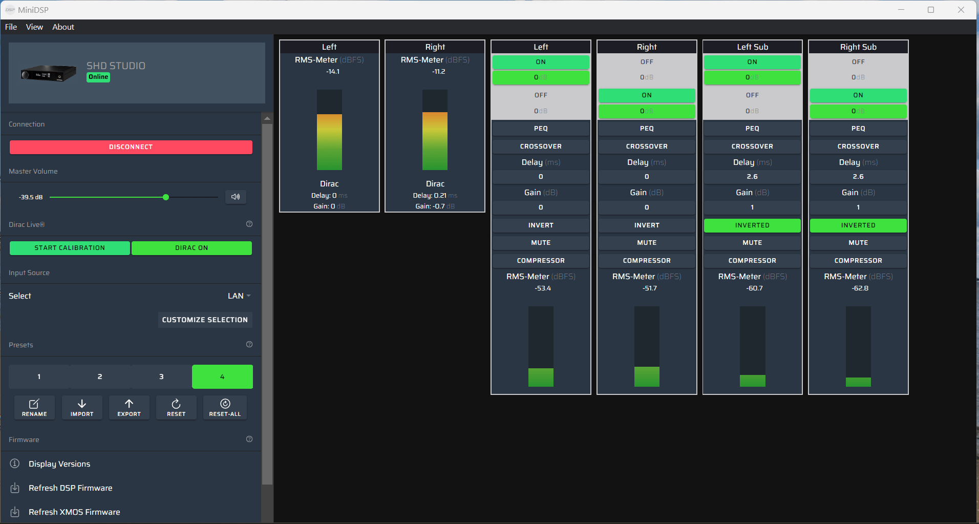

Hi Chris,
The current SHD Studio is also pre - DC, and I migrated to DC early this year to the best of my recollection. DC supports all of the SHD variants, but a FW upgrade is required to do so. DC is much easier to use and a lot more stable than the legacy console which I have largely forgotten about. The UI design looks relatively modern whereas the original looked like something from WinXP days.
Here are some examples of current DC console, although only a month old I will confess that I have changed the gains. The SHD manages the cross between the mains and the subs. A modified almost beyond recognition Behringer DCX2496 handles crossover, delay and EQ for the mains which are 3 way. An RME ADI-2 PRO FS R BE provides the ADC for analog sources and the DAC for the subs. Digital is handled by an RPI4B configured as an endpoint for Roon, and fed via SPDIF coax to the Studio. (I prefer the external streamer to the Roon Ready streamer in the Studio.)
