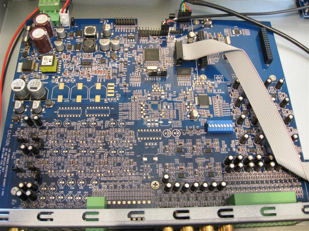

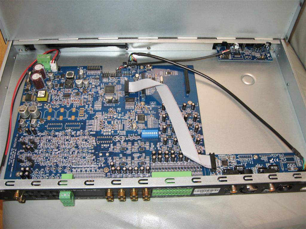

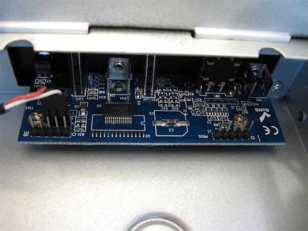

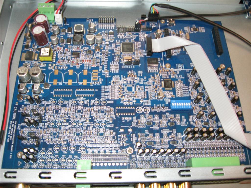

Here's some pictures of the inside of the miniDSP 4x10 HD.

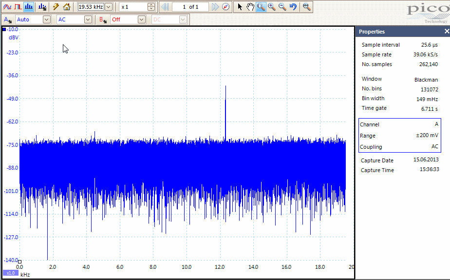

I did some measurements on my 2x8 with a scope today.
Test setup:
Scope: Picotech 3224 12-bit scope. (noise floor -126dBV)
2x8: 12V battery powered
Laptop: battery powered
Both battery and 2x8 is inside faraday cage.
Spectrum up to 20kHz. shows a noise floor of about -73dBV or 0.22mV RMS
The scope picture has a lot higher values due to the high frequency noise.
Note also the 12kHz peak. I am not impressed..
I'll do some more measuremens. But I have to go now

Maybe the 4x10hd has a lower noise floor. But you really should not convert the audio twice. You will end up with 8 bits left. No, but a lot less bits. Digital plugins like eq also reduce bits a lot. One plugin is good but 20 VST plugins on a song and you have radio quality.

btw that's way too much hf noise esp going to a wide bandwidth ss amp.. you are gonna fry tweeters ( been there done that.. not with that particular product however..

I found the 4x10HD quite poor sounding right out of the box.
I bought out of the hype and almost returned it.
As a DAC only feed via SPDIF (no EQ or anything), feeding an amplifier and passive speaker directly, my Benchamrk DAC2 run circle around it on about every parameter you can think of...
even after burn in, dynamics aren't much more impressive.
For the price, it's ok but far from a bargain.
Very, very easy to use on the positive side
I did a full recap on the power supply section with Pana FM and it really brought life to it convincing me to upgrade it a bit more.
If you can live with ~3-8mV of DC offset on your main amp or preamp, removing the all the 24 output coupling capacitor bring much more details and a presence to the overall sound. Coupling caps really screw the sound...
(1 coupling cap per RCA (8) out and 2 for each +- side of the balanced output(16))
I don't know if the stock Nichicon KW are fake or not but getting rid of them was a significant upgrade.
The 16 capacitors around the op-amp balanced output stage aren't power supply bypass as I initially thought but signal coupling from the Cirrus DAC. (blocking ~2.7Vdc)
I've changed them all with Panasonic FM and I could hardly believe the improvement. This led me to believe that either the KW aren't very good or the were fake.
I'm considering changing the FM to film caps but size is an issue and I do not think I can install 24 film caps cleanly inside this box)
Stock opamp are very low end and are a weird case standard making swap almost impossible. (case is smaller than standard SOIC and direct solder is impossible) Slew rate of the stock device is poor.
I'm in the process of replacing them all with AD8599 despite difference in casing. Very long job as you have to install a lifting rail and glue the new opamp on top of the PCB mount point. Once this is done, you have 96 tiny wire connection to make on SMT board... Very long and require good skill.
Hopefully, this will bring it to much better sonic performance
Because of it's price and ease to use, I admit that I now own 2 miniDSP 4x10HD
Thinking about buying a 3rd one if the opamp upgrade turn out great.
I hope to compete with Lynx Aurora16 sound quality for 1/5 the price (1/4 with mods as the AD8599 aren't exactly cheap)
