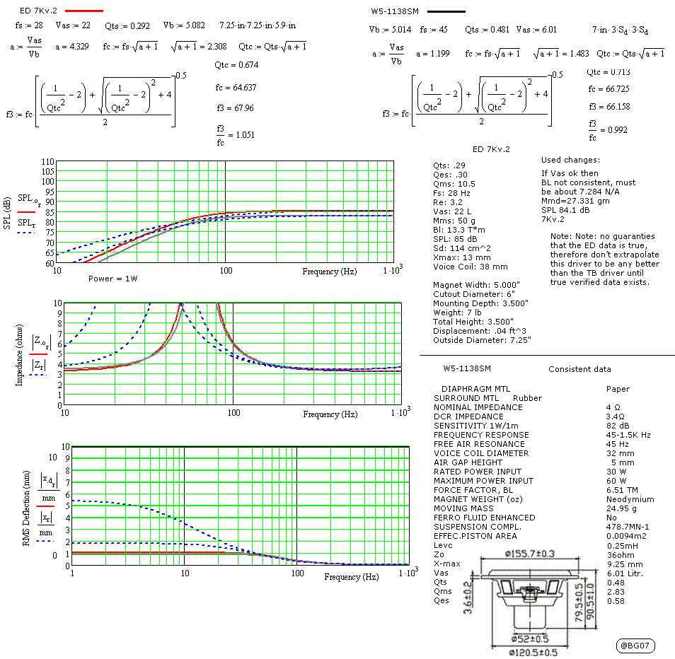

bjorno said:
Not in my opinion if the prerequisites are followed: A box max 7-8" cube i.e. about 5 L and the use of the given 4-channel BTL Car Radio IC.
Actually, for this case the ED driver would be wasted. See the picture: 1(1)
b
1(1)
Its a nice graph...but it went over my head.
I don't understand why the elemental designs driver would get less power? Its available in D2 and D4 models. If the D2 was wired in series you'd get 4 ohms, the same as the tang band.
But using the D4 could you not drive each coil with 1 channel, for a total of 32W with the 14.4V NiCad? I don't understand how the TB could get the same amount of power...that chip is bridged internally, and paralleling it won't give you more power if you're stuck with a 4 ohm speaker. Each channel is 4 ohms stable, paralleling them does nothing.
Could the cube be made slightly larger or stuffed with polyfil to make it more suitable. IMO the elemental designs driver is a better overall sub.

Hi Judtoff,
Maybe over my head too when I just took the TS data given for guaranteed and trustworthy at:…
http://www.edesignaudio.com/product_info.php?t=2&products_id=33
…and without more hesitation than the numbers should be valid for series connected coils.
Unfortunately I noticed too late that the TS data given was not consistent and incomplete. See picture 1(1).
The uses of given incorrect data for the ED driver gave an illusion of a much higher load impedance.
The only reason to parallel connect an otherwise unused power stage than allow for 2 Ohm is to gain lower losses (saturation voltage) in the IC transistors and to allow for use of the highest possible supply voltage without activating eventually built in current protection circuits.
The internal voltage loss is about 2 V at max output current= 4 A peak and not more than 16.5V peak is allowed with a 4 Ohm load = 34 W Rms.
The saturation loss + max allowed peak output voltage sums up to 18.5 V which is higher than max allowed supply voltage = 18 V.
So if 18 V is the maximum supply voltage then only 18 – 2 = 16 V is possible to be peak voltage for each half of the output stage and that results in 32 W Rms.
When a driver in box show up impedance lower than 4 Ohm an even larger current could be drawn and both the ED or TB drivers shows lower impedances than 4 ohm at some points even in the suggested 5 L closed box.
Ok for resistive >=4 ohms but not if shooting for performance at the operating point limits with the suggested BTL amp or when using speakers labelled 4 Ohm that occasionally dips down below the Re value due to bad design.
Looking at HA13158A THD graphs I find its obvious that for output powers above 15 W Rms/ channel where the THD skyrockets its possible by using paralleled bridged amplifiers to push this point above 30 W Rms as a real bonus.
