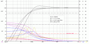

EL70 Sealed:
attachment.php
dave

Interesting measurements, F3 is really a little bit high at 80-90 Hz.
Since all three curves are black, I guess the one with the big hump at 180 Hz is in the 55L box (!?)
Do you happen to have mmar-kel-measurements for the low frequency part, too?
I found some curves from tuxedocevic in another thread, but not the low frequency part.
What measurements?
If you refer to the sealed sims i posted, the legend has the volume for each curve. Q=1 is ~2.7 litre.
And we know that F3 is meaningless when it comes to what we hear (Toole).One has to look at F6 and F10.
dave
That "big" hump is only ~1.5 dB. Not really that big. The chart has a more expanded scale than is usual.
