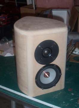

This is what it's gonna look like
It begin to look like the real thing...

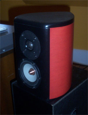

DONE!
I finished the enclosures last weekend after a 20 hours sprint. Everything turned out to be really nice. I have designed a first filter using manufacturer curves and calsod to be able to listen to them quickly. I used cheap quality parts. I will make measurements in the next few days and design better filters with good quality parts later.
F

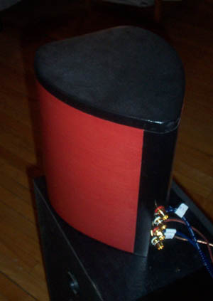

The sound is really good right from the start, but i feel that it could be better. It is normal considering the low quality parts used for the filters (electrolytic caps, dayton resistors, Solen caps for the tweeter which are OK i guess but not great, etc) Measurements will also be useful as i don't like to rely on manufacturer measurements. Bass is surprising for a small speaker and the most striking detail is the low distorsion. It is really clear on vocals and instruments like saxophone. But there is still lot of place for improvement. Crossover design is the hard part...but it may be fun.
