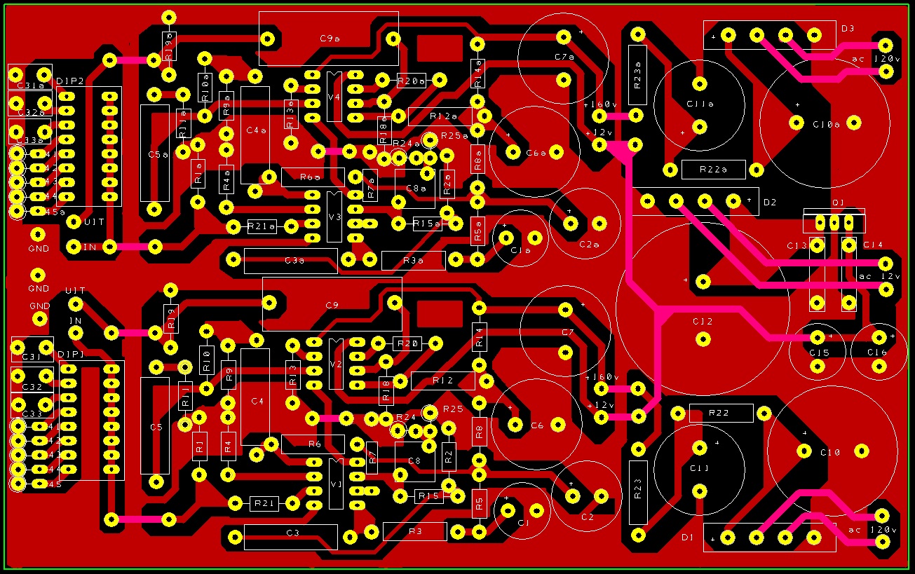

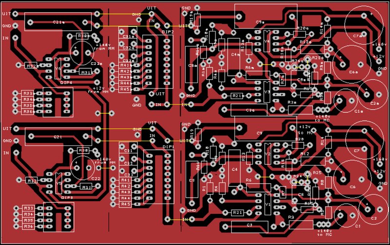

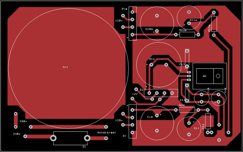

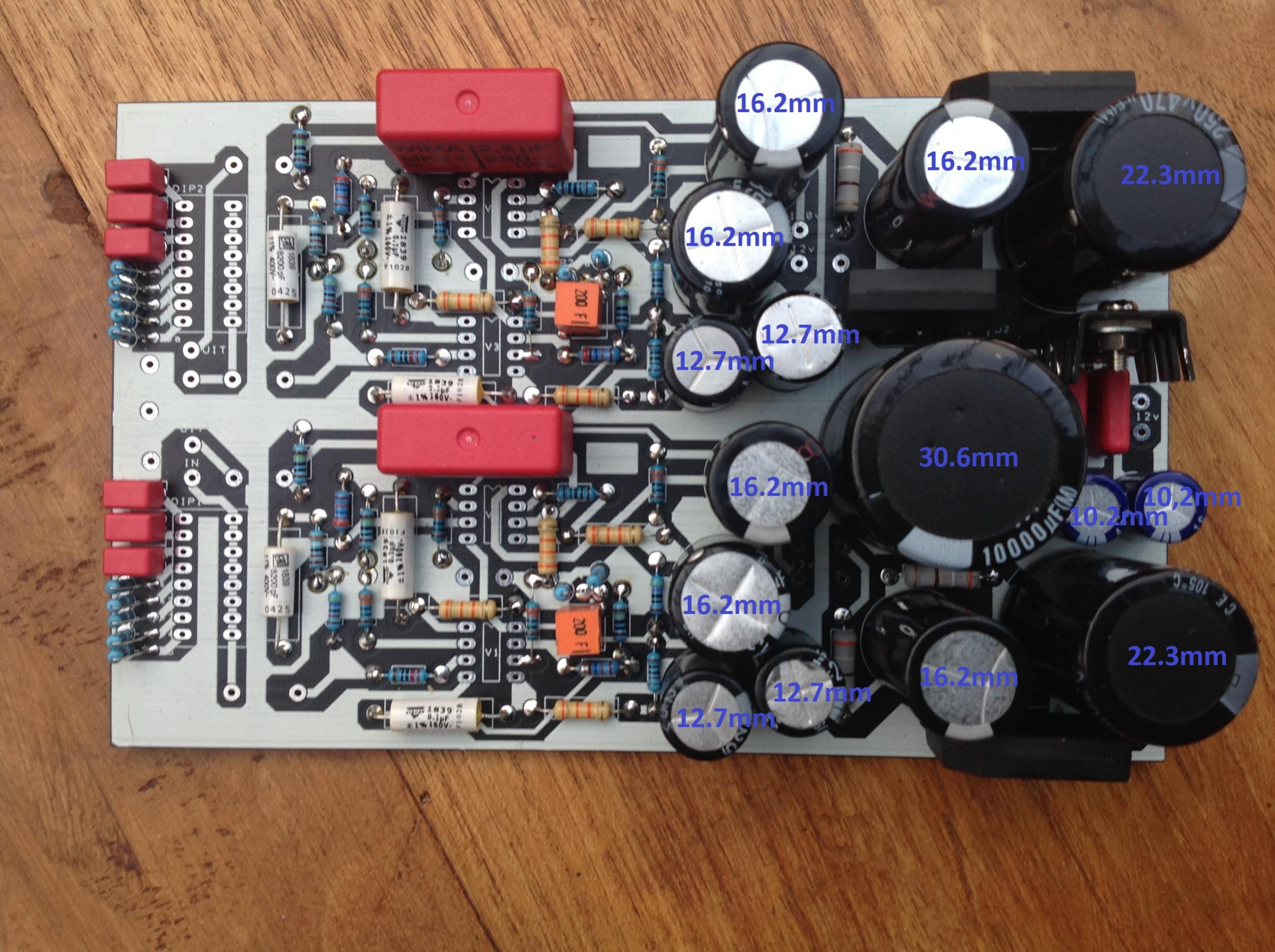

S sebuschi Member Joined 2013 2020-11-24 4:11 pm #181 2020-11-24 4:11 pm #181 What would be the power ratings for the resistors R22 and R23? ••• More options Share Koifarm Banned Joined 2005 2020-11-25 8:23 am #182 2020-11-25 8:23 am #182 Current through R22, R23 is 12ma. Dissipated power is 68mW. So 1/4 W resistor should function. But I use in powersupply minimal 0,5W. ••• More options Share Koifarm Banned Joined 2005 2020-12-05 10:41 am #183 2020-12-05 10:41 am #183 At the picture the diameter of the electrolytic capacitors. Attachments Minime diameter.jpg 538.2 KB · Views: 440 ••• More options Share Koifarm Banned Joined 2005 2021-01-10 11:38 am #184 2021-01-10 11:38 am #184 At some request the gerber files for the 2 PCB Minime. Attachments minime 6n16phono.jpg 137 KB · Views: 400 Minime powersupply.jpg 61.2 KB · Views: 375 Minime 6n16phono gerber.zip 52.4 KB · Views: 108 Minime powersupply gerber.zip 14.8 KB · Views: 144 ••• More options Share Koifarm Banned Joined 2005 2021-01-10 12:09 pm #185 2021-01-10 12:09 pm #185 Below the gerber files for the latest Minime V1b one PCB. With bigger holes were necessary and without the short in the first PCB. Attachments Minime PCB.JPG 538.7 KB · Views: 354 Minime V1b gerber.zip 39.4 KB · Views: 119 Last edited: 2021-01-10 12:12 pm ••• More options Share O Ovitzi Member Joined 2021 2021-03-01 12:20 pm #186 2021-03-01 12:20 pm #186 What is the size of the pcb? And is it two layers? ••• More options Share S Schmitz77 Banned Joined 2015 2021-03-02 10:30 am #187 2021-03-02 10:30 am #187 Hello, like your software for the RIAA curves. Wonder what programm you use? ••• More options Share Koifarm Banned Joined 2005 2021-03-05 8:19 pm #188 2021-03-05 8:19 pm #188 The pcb is eurocard size 100 x 160mm. It is a double layer pcb. You get all the info when uploading the gerberfiles to JLCPCB. I just calculated the riaa myself and optimized it with my spectrumanalyzer. Last edited: 2021-03-05 8:22 pm ••• More options Share Koifarm Banned Joined 2005 2022-10-23 6:10 pm #189 2022-10-23 6:10 pm #189 See post 1 ••• More options Share Koifarm Banned Joined 2005 2022-11-19 11:26 am #190 2022-11-19 11:26 am #190 Post 1 updated as-build ••• More options Share Prev 1 … Go to page Go 8 9 10 First Prev 10 of 10 Go to page Go Show hidden low quality content You must log in or register to reply here. Share: Facebook Twitter Reddit Pinterest Tumblr WhatsApp Email Share Link Home Source & Line Analogue Source Mini-Me phono preamp Top Bottom
