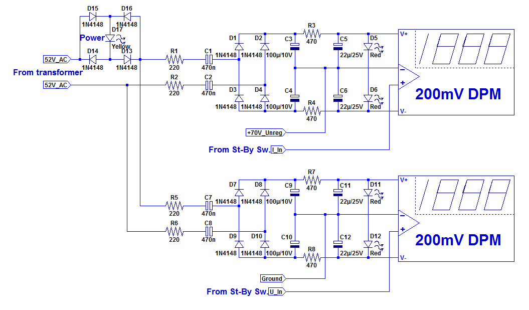

Display:
The display uses miniature millivoltmeter modules cannibalized from small battery testers.
I found them for very cheap, and when I discovered the millivoltmeter was usable on its own, I bought the whole stock.
The modules are so small I can sneak them nearly anywhere I like.
They are also very low power: they need less than 1mA/3V.
Their operation is very much like the common DPM's operating on 9V, except all the voltages are 3 times smaller. In particular, they also need a floating supply with respect to the input ground.
Here, that requirement is fulfilled by a special arrangement of capacitive supply, meaning there is no need for additional transformers or windings.
The voltage is stabilized to ~3V by two red LED in series.
Exactly the same circuit could be used with regular 9V DPM's: one just needs to replace the LEDs by a single 9.1V zener.
The capacitive currents from the two supplies also serve to power the mains LED, thus giving an instant ON/OFF indication, just like an old neon pilot light.

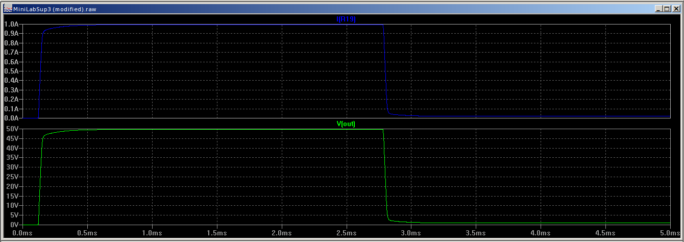

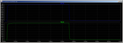

Tested with changing voltage and it looks pretty nice. For some reason I didn't succeed to limit a current playing with R33, R34. Tested model is in the attachment.

In the mean time, I made checks with the substitutions I advised you as a quick fix for the lack of models, and there seems to be a problem with the LT1055 in that configuration: it behaves in unexpected ways, and this disables the current regulator.
It is probably preferable to use the TL072 model I provided: it works as expected and doesn't cause any convergence issue, contrary to the LM358 for which the LT1013 is a good substitute, both in sim and reality.

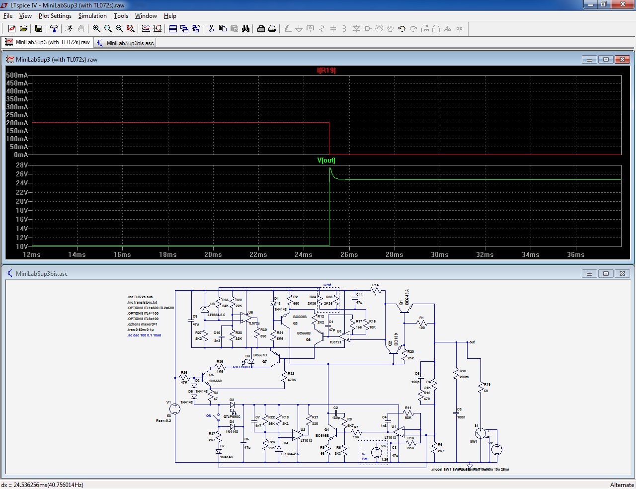

For some reason, Windows doesn't want to unzip your files. I also tried an online unzipper, but it doesn't work either:
You can post your .asc directly, if there are not too exotic models to add, I'll manage
Strange, maybe its due to fact that one file has linux owner rights recorded. Here is another one, this time also with TL072 as you suggested. Yes, current limitation now works and it produce overshoot (~15% in tested case).
The situation you examine there is that of a step at the reference input, ie. the regulator functionning as an amplifier.
It can be interesting for the study of some parameters, but it isn't a likely realistic situation with the potentiometer control and the 47µ bypass.
A stimulus applied at the output is normally what is encountered, and if it results in a change from current-mode to voltage-mode, an overshoot will result, as shown in the sim and screenshot below.
This is why the snubber network is included.

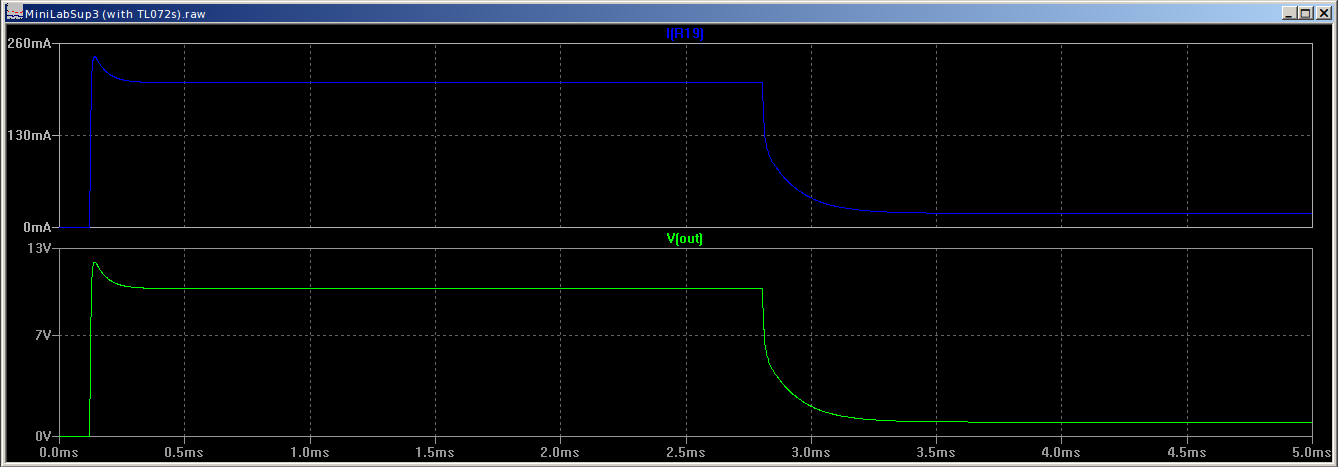

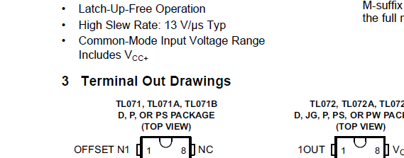

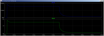

One thing worth noting regarding the current control: all Bifet opamps (probably including the real LT1055) include V+ in their common mode voltage range: it is clearly stated in the datasheet, but it is not reflected in the numerical values of the DS.
This is in fact means that the basic operation is guaranteed, but not the specifications. The OL gain in particular is reduced.
There are series (TLOX IIRC) for which the characteristics are guaranteed, but they are less common (and more expensive).
You're right. I used it as a special case to see what could happened when PSU is controlled by MCU. But as you also mentioned due to current control loop your design is not "MCU ready" what is just fine if one don't need anything beyond basic manual settings.
