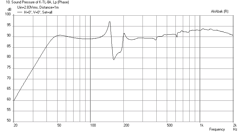

xrk971 - if you are ever bored and looking for something to do... :D :);) Perhaps you could try the SEAS full range in your Karlsonator model? (8 or 12)

GregB,
Sure, I will run the SEAS as soon as I get to my computer and have time. Regarding the slot and how far up it goes - my model seems to indicate that this part is really critical to the bass extension and shape of the bass shelf. A wider slot gives higher bass amplitude and a little overshoot but less extension. A narrow slot or cusp gives deeper extension and smoother roll-of. It makes sense that this part is important because it is the first part of the mouth that lets the sound pressure out. Velocities here at the top slot can be very high - 50 to 60 m/s on 115 dB peaks with an 8 inch 95 dB driver. Definitely enough to blow a candle out if not spray molten wax everywhere. Someone should make some measurements with both and see if this is true. Regarding the smoothness of the shape of the aperture: below the top third, the smoothness probably doesn't matter for sound quality it is mostly aesthetics. In fact, I think you could have 9 to 12 step staircase edged K-aperture and it will still sound good. Another experiment to try with measurements.
Here is the Seas in a full size Karlsonator 12 - looks pretty good.
