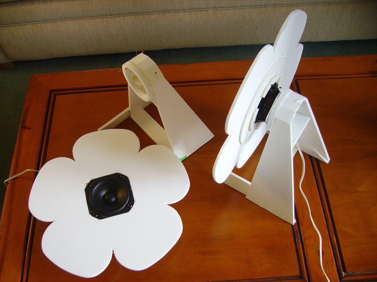

Small update
This afternoon I built / assembled a pair of 12" diam (LP size) 5 petal OBs with my tc9ds as their centre .
Hey it was fairly easy as a First FC build attempt. V few parts.
Plus I have a 3 yr old Grandaughter who is going to love these Daises .. once painted up .
It's 2.1 setup using the little sub from my temporary Cambridge Soundworks set.
This cobble up sounds wayyy better than it has any right to.
I'm seriously impressed. Decent bass too, almost usable, sans sub.
Thank you ! for the advise and concept for trying this.
Did find the $ store FC a bit fragile to handle ..really Easy to cut tho.

Finally Got show 'n tell pix.
Cobbling together stands was far more complex/time consuming than making the Daisies.
Stands are a tight friction fit onto the Driver's magnets, intent being to have them removable and ultimately adjustable.. once I figure out the best setup angle for purpose.
Very nice work, Bare! I can see you have some real foam core skills! Those stands look awesome. Very high tech. I never would have thought to use the magnet to mount the driver to the stand. I see you even added a layer to make baffle flush with driver bezel. That helps actually get rid of pesky little “grass like” diffraction around 500Hz to 2.5kHz range.

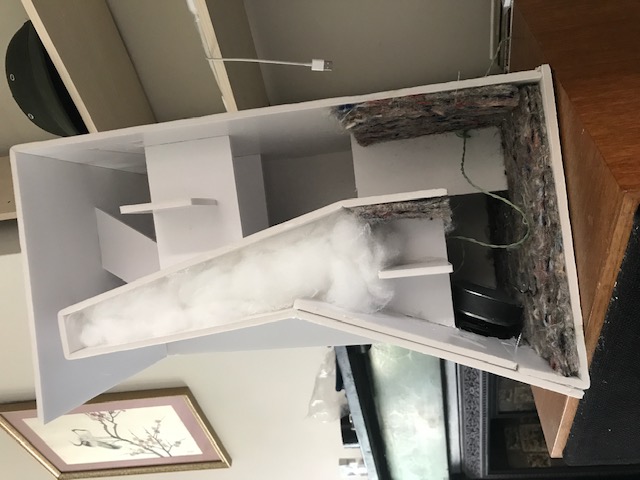

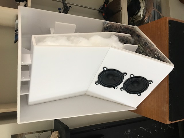

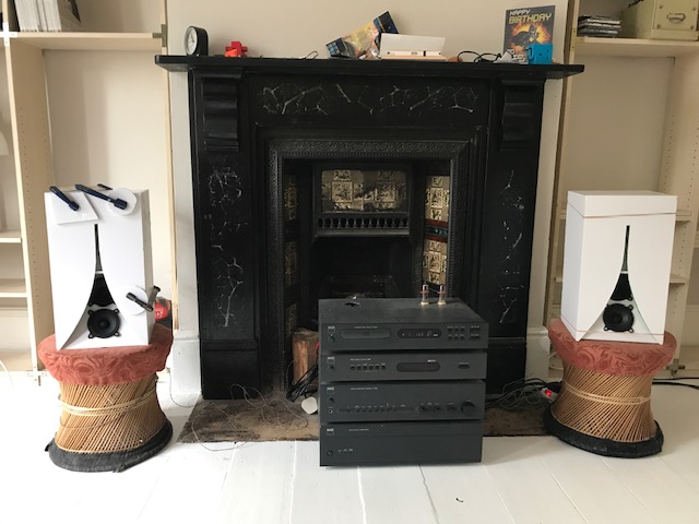

Summer project
Back home in the UK on leave for the summer. Been a long admirer of this thread and as I was able to get the 5FE25-16 locally so I gave myself a project.
Was a bit underwhelmed by them initially but after a couple of days with them and doing a some of A/B swaps with my long-term favorites KEF 104ab (the bass on them sounds so wooly in comparison to the Karlsonators) I can't imagine now swapping them out again.
Its great party trick when people see (or have heard you tell them about) your dodgy little cardboard speakers and then their expressions of disbelief when they hear them!! A current favourite demo track is KARATE by Babymetal. Also listening to Alita Battle Angel soundtrack really shows off the bass. They are loud speakers!
I've had to put a stack on magazines on the one without clamps because the bass was making it spin and move off the stool it is sitting on.
Extensively modded NAD stack is my B-reserve team as the DIY A-team lives with me abroad.
Since these pics were taken I've added some masking tape around edges of front baffle to stop them farting.

Thanks for the awesome post, Sthcoaster! Great party trick, indeed.
I think you are using 3FE25-16’s not 5FE25-16? Although that would be a cool driver if it existed.
I use those sticky clear plastic bumpers with self adhesive on the bottom of my speakers to keep them from rolling of the table.
