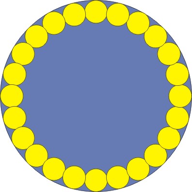

Also, I went out and bought a circle jig for the jigsaw today and failed horribly. I was going to make boxes for my Hivi B4N just to get the hang of it.
I think I am just going to get a router jig. I have a router but need the bit and the jig. Also a table saw because it's IMPOSSIBLEEEEE to but a straight line with a jigsaw lol. This project is starting to cost more money than I wanted...I knew I should have just bought the bose and dealt with missing frequencies.
