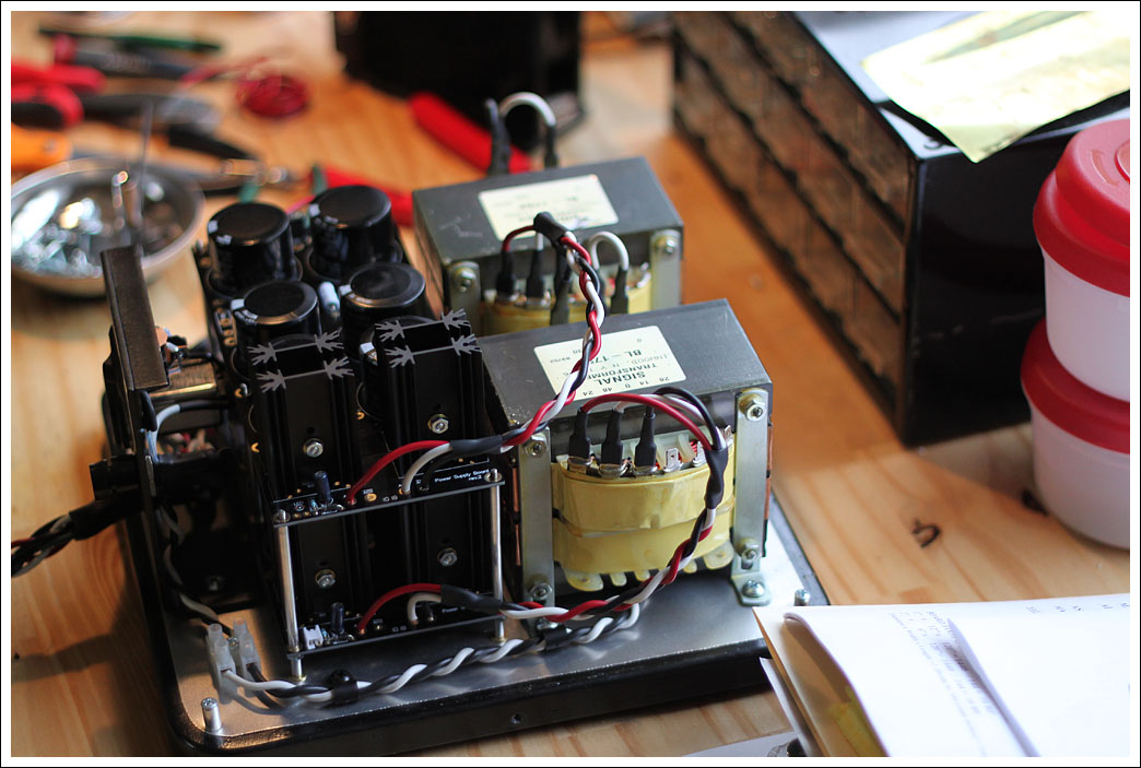

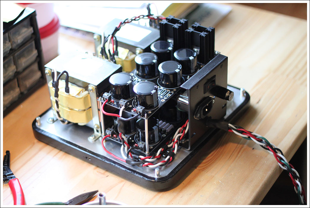

The power supply unit is about twice as big as the amp itself and is probably majorly overkill. Since this photo was taken I installed 20 2.7ohm resistors to implement a 29Hz CRC filter. The power cable now also has a strain relief.

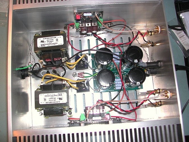

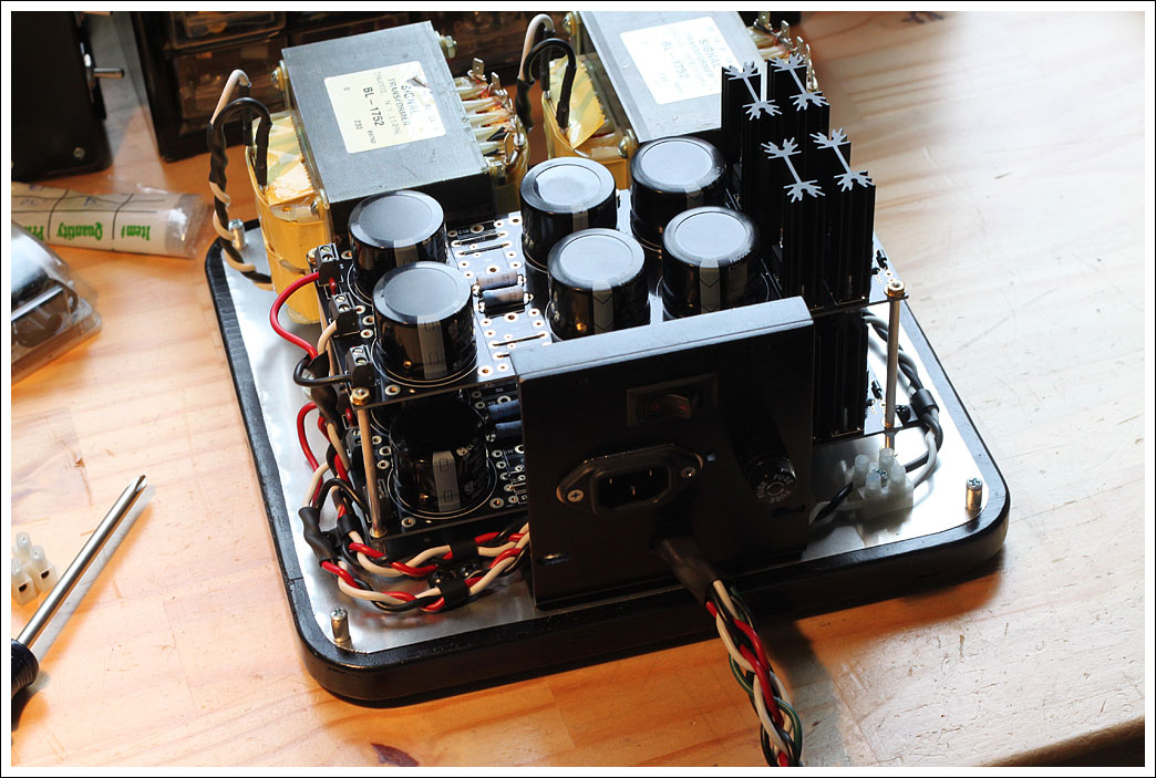

All 120v connections are point to point on the back panel. I put a small capacitor across the switch to prevent arcing, with a thermistor in series with the hot lead after that.
All AC lines are on this side of the unit. The 120v line is close to the ground for shielding. I'm pretty sick of braiding wire at this point.

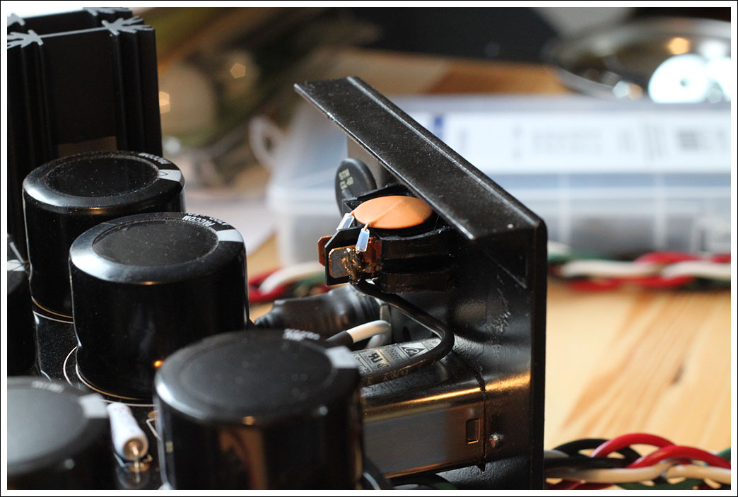

Here is the DC side of the unit. Unfortunately 6L6s connector was a bit too small for the 14g wire I used, but I have a plan for it in a future project. If I were building this again I would definitely go with 16g wire instead since it is easier to work with.
It was a very tight fit but I got all six 14g wires onto the power connector.

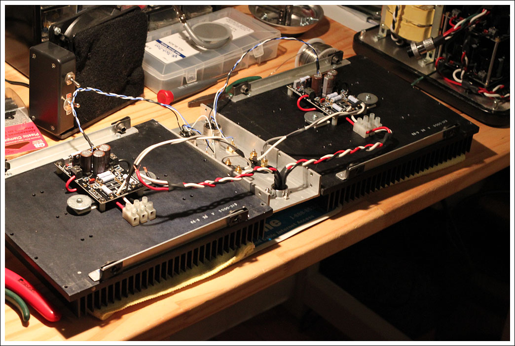

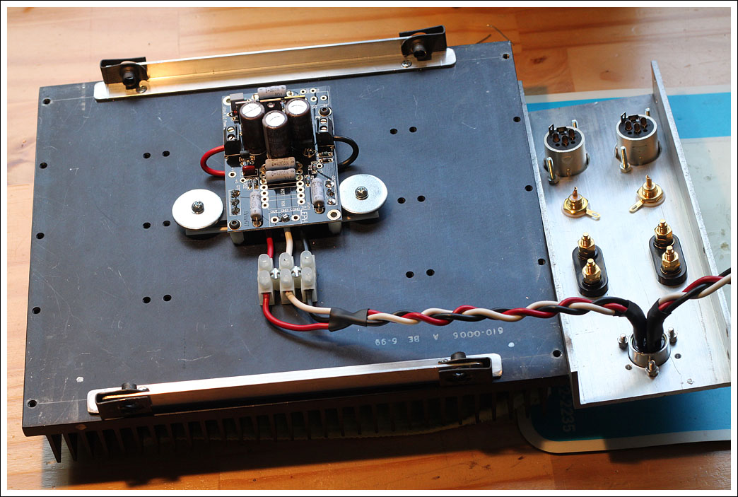

Here is one amp channel mounted on its heatsink. The mosfets are on aluminum oxide insulators.

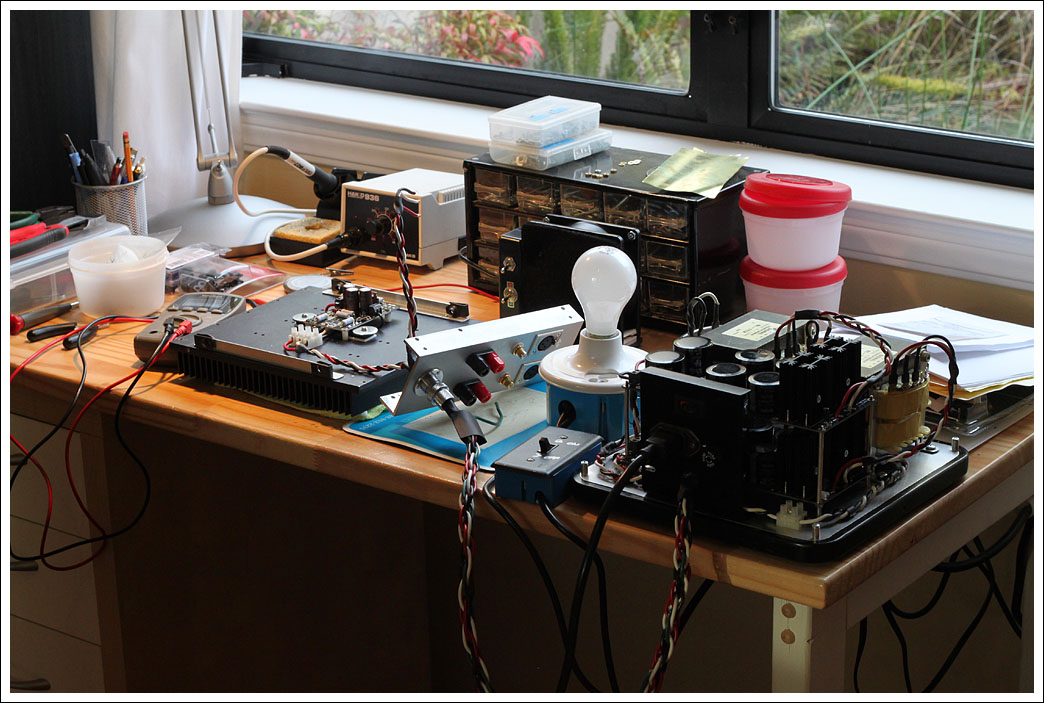

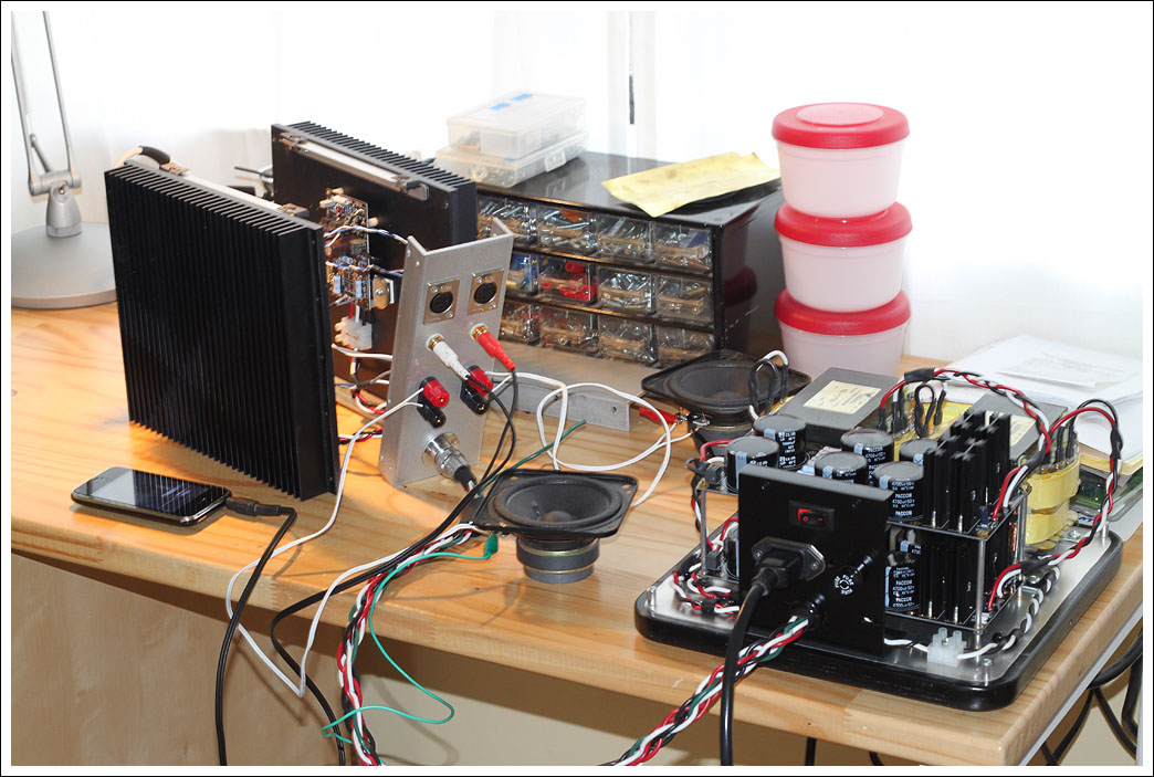

The setup for the initial power-on testing. Surprisingly, with the light bulb in series I only saw ~9v rails.

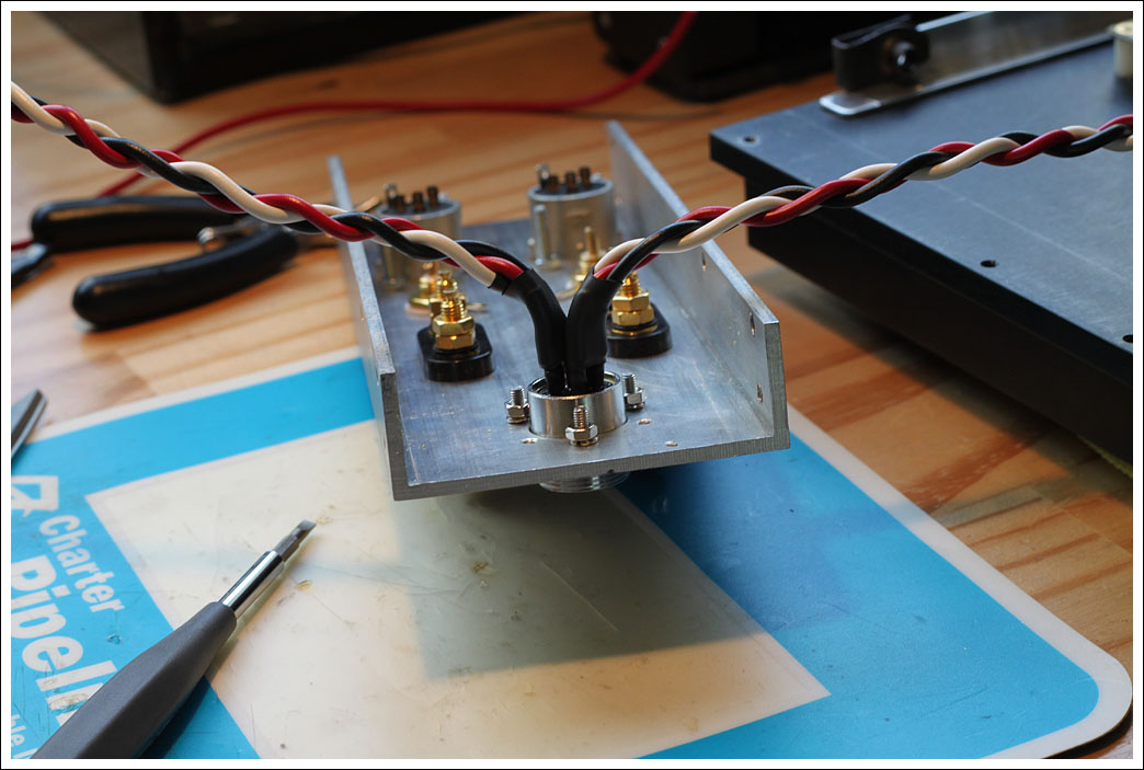

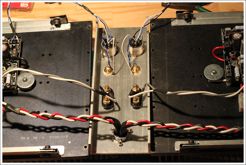

Here is the input panel wired up. Originally I was going to solder the speaker outputs to the binding posts, but could not get a good joint. Instead I crimped and soldered ring terminals on the wire, this should give a solid connection and is easy to disassemble. The signal wires are 22g cable from ApexJr, it is very nice but difficult to strip. Blue is positive, white is negative, and black is ground. As you can see the negative (white) is hooked to ground so I can use the RCAs. The loose connection is somewhere in this area.

Testing with "no baffle" Pioneers 269-469s and an iphone as a temporary source.

Do you have a star ground ?
The amp is setup as two monoblocks in a shared enclosure, so the only electrical connection between the two channels is the chassis ground. For each channel the power supply DC ground goes straight to the amp board, and then the grounds for the input and output are also connected to the board, so you could consider the ground plane on the board as the "star ground" for each channel. I currently have no connection between the DC grounds and the chassis ground.

I have mine wired with the out and ground on Brian's board going to insulated binding posts, and the Cground (Chassis ground I assume) wired to the ground on the power supply board; the power supply ground is then tied to the chassis ground along with the ground conductor from the power entry (star ground).
My RCA inputs are also insulated with the coax shield connected at both the RCA and the PCB.
I have a miniscule amount of hum (shows up as some fuzz around 0V with the scope set at 5mv) that I haven't yet noticed on my 95db speaks.
Brian's board has the signal output ground and the cground tied together. Am I correctly understanding that you have your power supply ground tied to cground on the board and also to the chassis itself? This would mean that the center taps on your transformers are tied together correct?

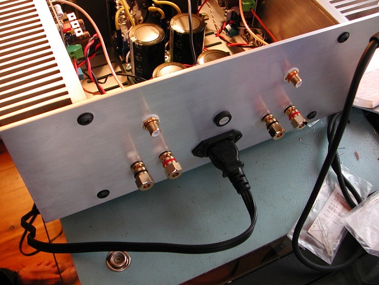

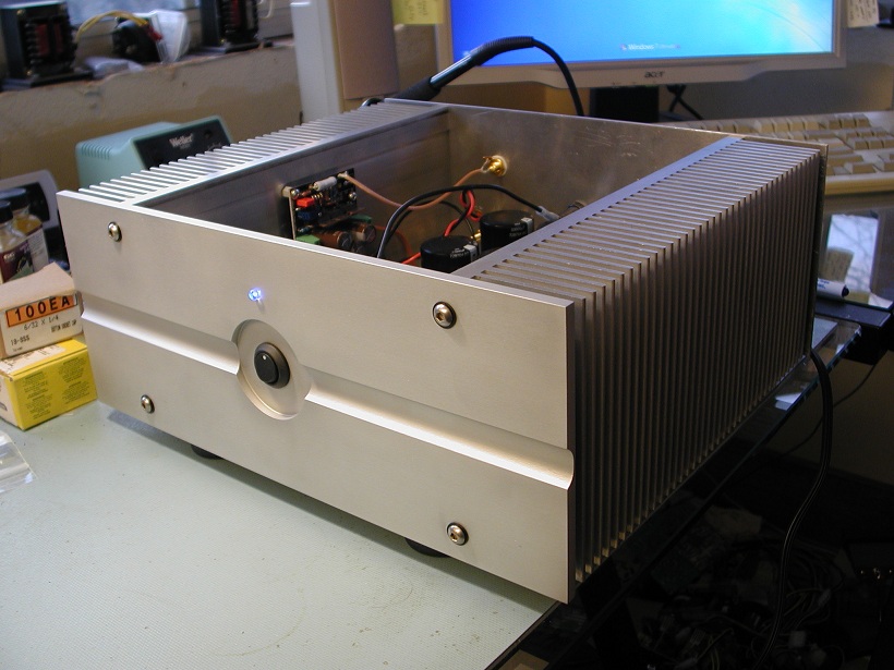

Outstanding metal work! Did you do it yourself? I can see some elements of style similar to you Poindexter Music Machine build.
Thanks! Yes, fabbed in the garage. The heat sinks are Antek/Par-Metal HS11XX series, 5" tall, the rest is fabbed from aluminum rems from the local metal supplier. Transformers and bridge rectifiers are leftovers from an old work project.
I got lazy on the binding posts when I found shouldered nylon washers from McMaster to isolate the posts from the chassis, no exotic wood insert.....
I'm considering anodizing it.....perhaps when I get the next project built (F4 is next), I'll get the whole lot anodized to save $$ on the minimum fee.
Correct. The two grounds are tied together on Brian's PCB and one goes to the binding post and the other to the PS ground, then PS ground to chassis ground stud. My transformers are single 12V secondaries; one is doing the -ive rail and the other is doing the +ive rail, no center taps.
Ah gotcha, I didn't notice in picture that you were using two transformers to get the +/- rails, I assumed they were center tapped.

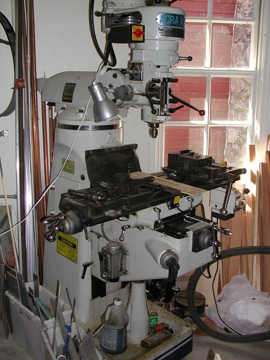

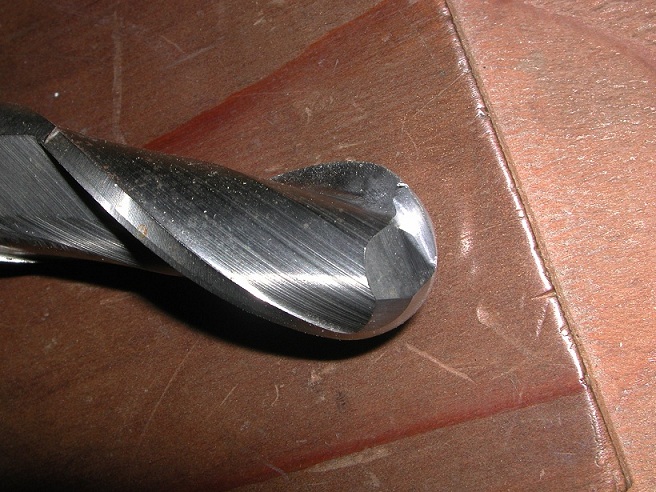

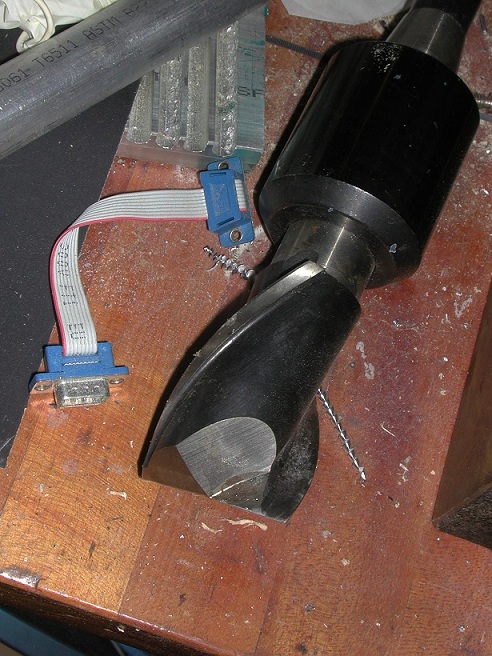

How did you machine that groove in the faceplate? You said you did it at home?
With a Bridgeport, a ball end mill and a big-*** 2 flute end mill.......... (not counting the mounting holes, just a drill bit for those)...
