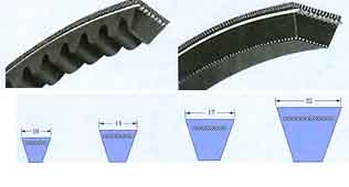

chipco3434 said:RECOMMENDATION...
With those short belts, you should be using a "cut" v-belt. Those standard belts EAT power and makes mucho heat on the small pulleys.
It's the style on the left...
upgrading the belts is on my list... i was told that these belts are very good, reducing vibration, increasing power, and dont wear out as quick:
http://www.rockler.com/ecom7/produc...DBDADADADADFGCGFGMHEHDDADADADBDB&filter=belts
any idea where to get the ones you are talking about?
