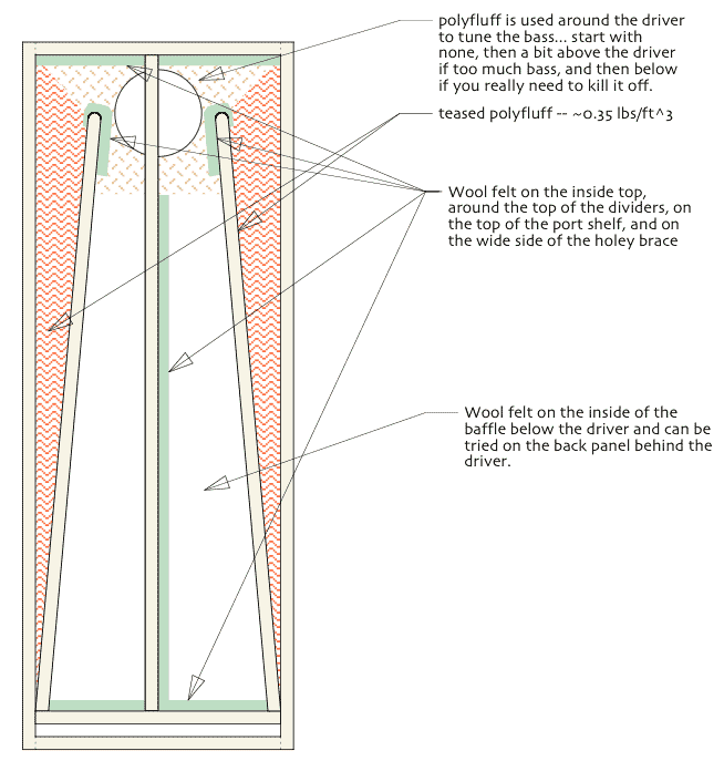

EEatKSU said:Also, what/where is the recomended stuffing for these?
An extract from the Mileva 1v1 documentation (not quite finished yet)
dave
