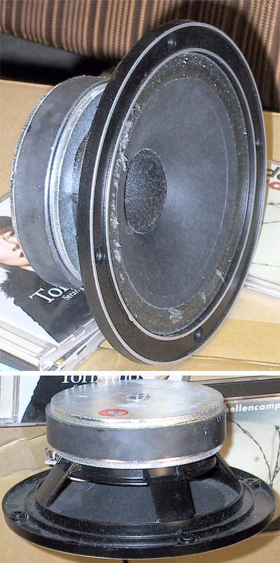

Audax PR17, paper cone one. Close to 100 dB.

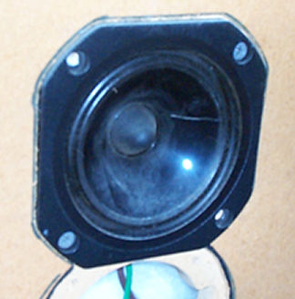

Audax has made a few different versions of that driver; I've tried the TPX and it sounded fine until the TPX cracked (as it tends to do). So far, I've lost about half my Audax TPX drivers to cracking, even one that had never left its original box.

Wow. I haven't seen or heard the TPX, but Thorsten says he prefers the paper. The paper certainly has greater longevity -- the pic was taken within the last year, but i bought them in 1982.

I used the PR17 (as pictured) in horns (of my own design) from 300 Hz up to 1.5 kHz. Each pr of drivers was driven with a Bryston 4B. I don't recall ever loosing a midrange driver (the pr i have were spares for that set-up). I treated the paper cones with puzzlecoat (as i am want to do with almost any paper cone driver).

Someone explain (or give pictures ) of this "cracking" phenomenon--this is something I think I'd like to avoid. I'd like to use these PA speakers for a LONG time...

diypole, no, those are two different materials. TPX is indeed polymethylpentene. It's a bear to anneal properly, thus the cracking problems. I've talked with one of the suppliers of this material to Audax and they told me that my problem is not that unusual.
OTOH, I am an unabashed fan of their HDA Aerogel cones.
When I get home tonight, I'll snap a picture of a cracked cone for Nappylady.

Here's a pic of a cracked TPX cone from a 3 way transmission line system I prototyped and abandoned. Low hours, only played at less than 90 dB on Sundays by a little old lady; no abuse here. Sorry for the dust, it's in my garage.
