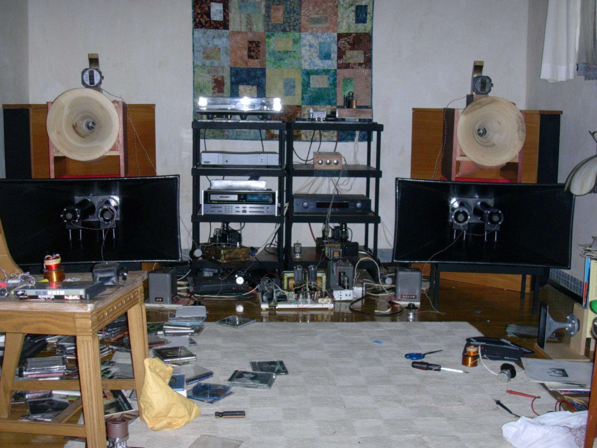

I also experimented with idea of compression driver upperbass. Electrovoice used it in their Patrician IV horns. On the picture is oversized mouth 100Hz taper dual compression driver reentry units in compound configuration.Yes it ads a lot of snap, energy and dimmension to the sound but ultimatively I gave up because after a while one notice that the body and low end response is lacking and the sound is to dry. The horn was crossed 200Hz-600hz. I'd suggest cone driver and with time compression driver from 400 up. in suitable horn.

Last week i connected my lower midrange horn with Fane Studio 8M. Did not change the settings of the crossover. It sounded aweful to me, compared to the Beyma 12p80nd. Colored and unpleasant. Switched soon back to the actual configuration.
