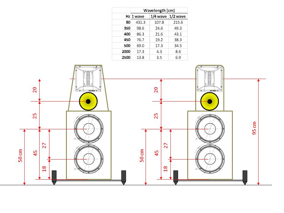

Context: I'm designing a 4-way active system using digital crossovers, linear phase, time-aligned. The bottom end will be handled by two Rythmik 12" in DIY sealed enclosures. The midbass will be handled by two 10G40 per side in their own sealed boxes, playing from 60-80Hz to somwehere in the 350-500Hz range. On paper two 10G40 per side seem best, but I might end up with one per side.
Midrange will be taken care of by a 6.5" or 8", and the top end will be handled by a Beyma TPL-150H.

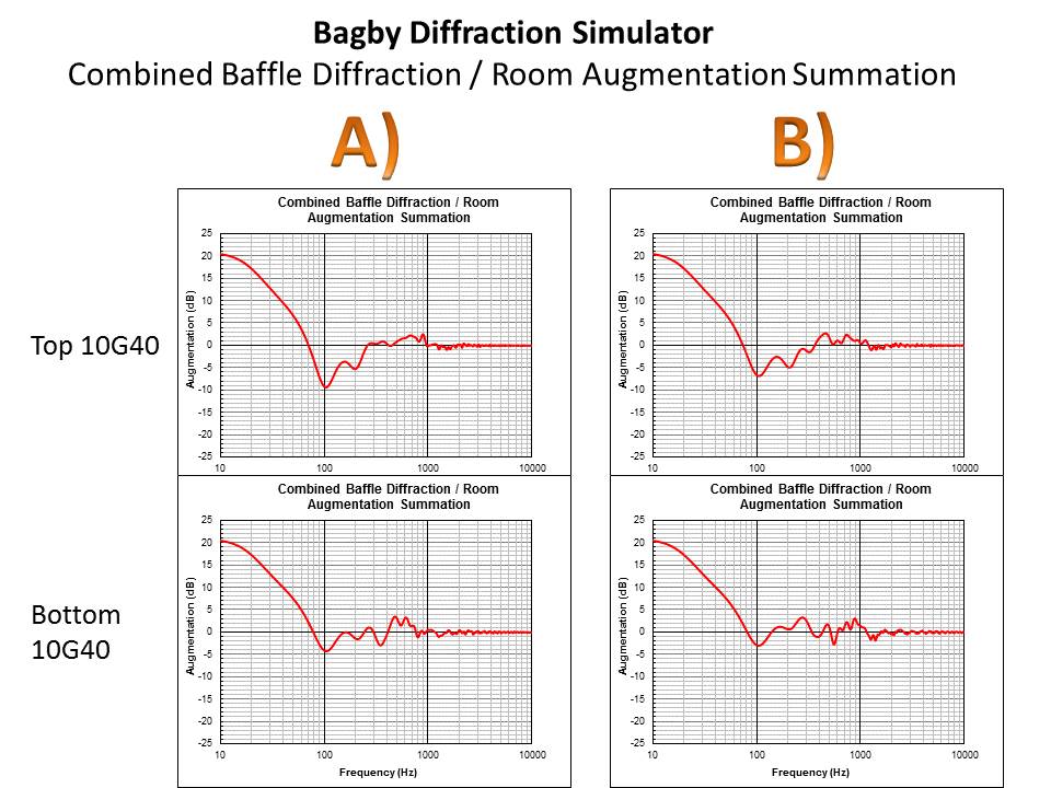

The baffle is 40cm wide, so baffle step F3 comes in at 290Hz. Using Bagby's Diffraction Simulator I concluded using two drivers would better allow for mitigating baffle step.

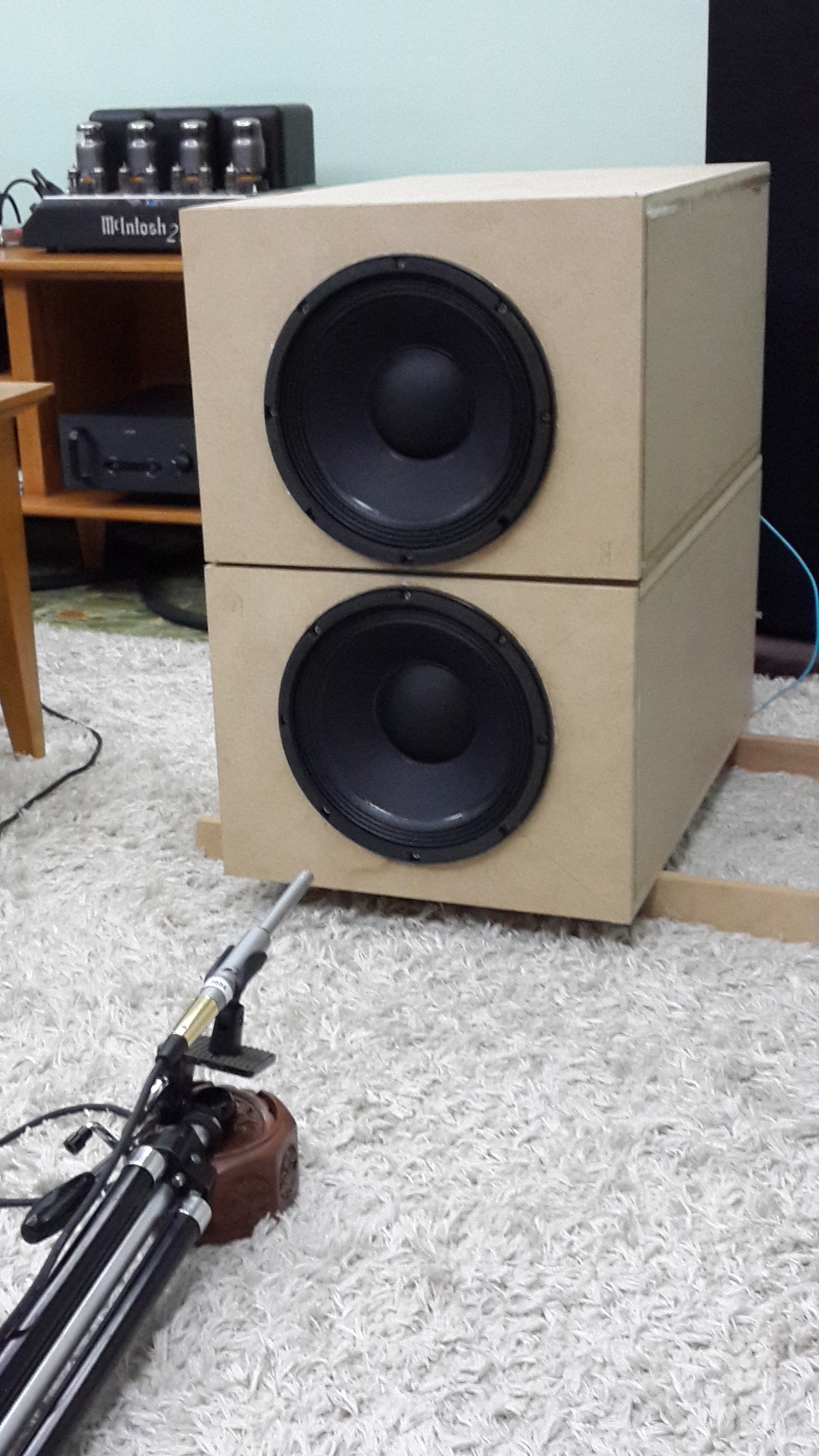

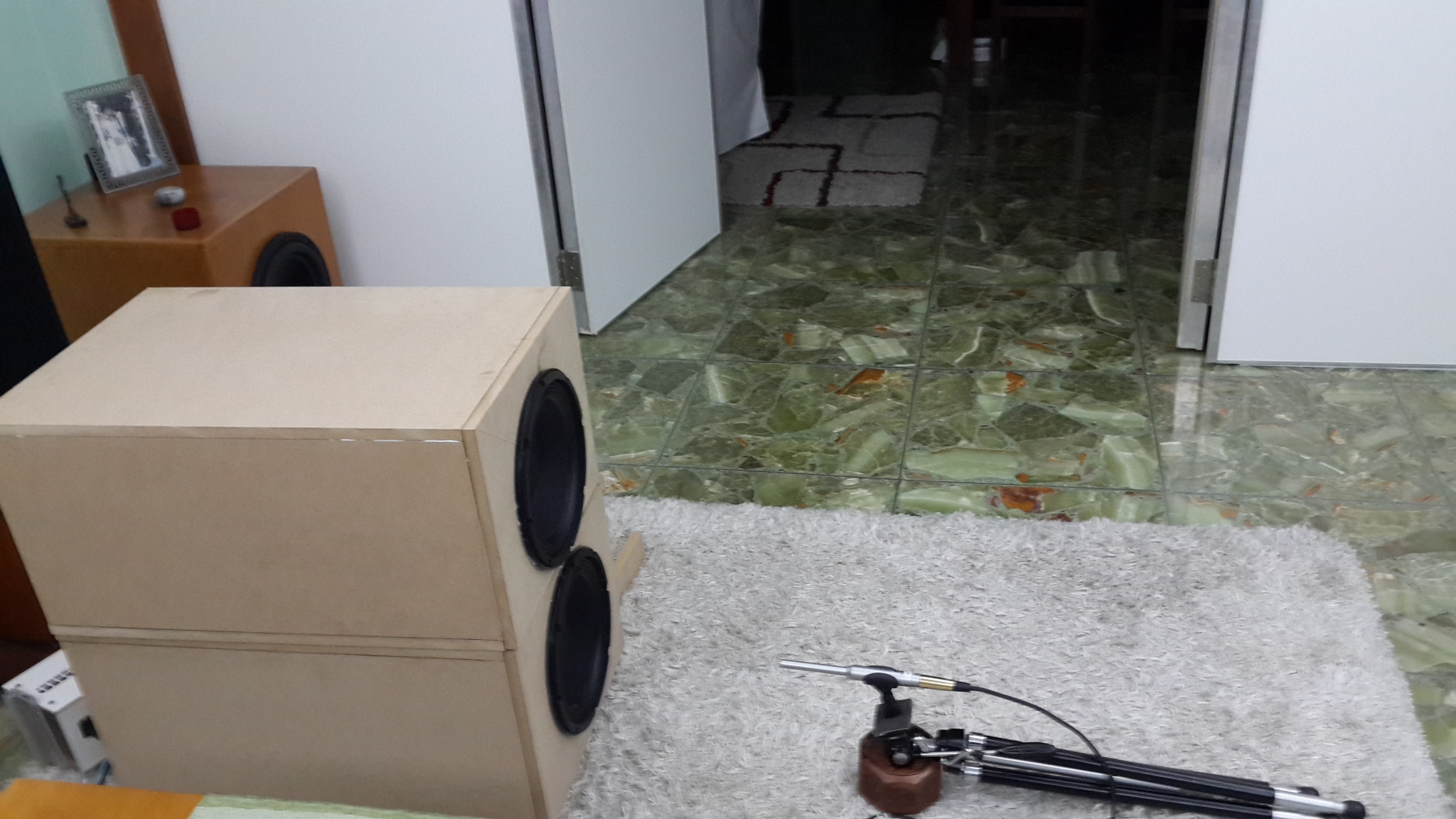

I built super simple boxes in 15mm MDF, sealed, and with no filling, to try out how the drivers perform with different volumes. The back plate is built in such a way that it allows for easily changing box volume. Each box has a front baffle of 40cm wide x 30cm high. One box is 40 liters (net of the driver volume) and that represents a Qtc of 0.41. The other box is 56 liters and has Qtc of 0.38.

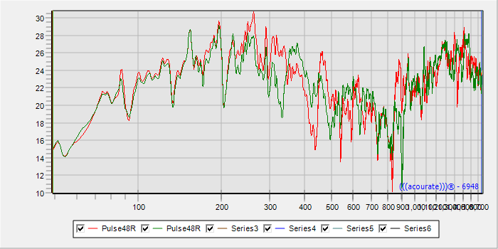

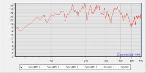

Below you can see a couple of pictures of the measurement setup and the frequency response. The boxes are placed in the middle of the room 1.7m from the front wall, 3m from the back wall, and 4m from the side walls. I had both boxes one in top of the other to have the baffle effect in there, but only the bottom driver was playing and the mic was 30cm away from the dustcap and on axis with the bottom driver.

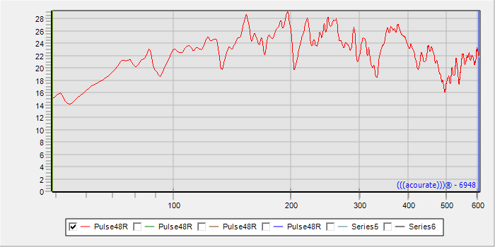

The frequency response shows unsmoothed measurements, red is in a 40 liter box and green is in 56 liter box. What should I conclude?
I'm thinking xo at 60Hz won't work, while 70Hz might be a good idea. I use Acourate software for DSP and it only trims response (no boosting). Looking at 70 to 500Hz I see the red line plays louder until 350Hz, but it displays the trough in 400-450Hz.
I'm thinking:
I believe the next steps are:
I'm thinking:
- If using 70 thru 500Hz I would be better off using the green line, 56 liter enclosure, because I would need to trim less (at about 18 it would do).
- But if playing 70 through 400Hz then the red line might be a better idea.

Do these cabinets have basic cross-bracing? A 90db/watt midbass can rattle a side panel with 1-watt. Perhaps the 200Hz/400/800Hz dips are box resonances.

The dip you see might be because you are measuring so close.. From far enough back, the diffraction energy would be half the baffle delayed, but up close it travels back to the middle. Try something a little closer to the listening distance.
I can certainly do that. Should I also place the boxes where the speakers would sit?

Unless you want to include the room I wouldn't.I can certainly do that. Should I also place the boxes where the speakers would sit?
It's also debateable whether to keep them on the floor. You'll get a longer reflection free time with the speaker and mic at half room height, but you could push this further if you put the speaker and mic down on the floor.

Take them outside and measure again. Save the measurements and compare them to the ones done inside.

I think that using two 10 inch drivers is a mistake. You will find that unless you are running a nightclub, that it will make no real difference to the SPL you can produce - but you will get all manner of ripple in your frequency response as a result of there being two drivers a side.
If you have put two drivers there for SPL, just hook up a big amplifier, they will take it and deliver very high SPL. Especially if they are not trying to deliver bass at the same time!
Your near field measurement show this very well.
I have found the Beyma published data to be reliable for all the drivers I have used. I have not tested the 10g40, but I do use the TPL150h matched to a 10 inch driver with great success.
If you have DSP crossover available I would try running one 10g40 per side crossing to the TPL 150 at somewhere between 1500 and 2000Hz.
If you have bass drivers on both left and right channels (I.e. Not s seperate sub) then I would strongly consider running the subs up to a higher frequency than you suggested. This would result in the bulk of large come excursions being handled by the sub. As a result your mid will be cleaner as the driver will not be trying to generate midrange on a cone moving back and forth.

I'm not sure you are right. Twin 10G40 per side are not for SPL. One would reach max SPL needed, as you say. The reasons for twin drivers:
- keep maximum displacement at 20% of Xmax vs 50% with one driver, thus reducing distortion.
- Achieve almost the same volume displaced at 80Hz and 105dB than a 12", while keeping displacement very low, using drivers with very low F3 at Qtc=0.707.
- Get 86% of SD of a 15", but with all of the above.
- Two drivers allow for better mitigating baffle step. See the simulations using Bagby's software below.
- The 10G40 were not chosen for their midrange ability. Hence I don't think it's a good idea to think about them as midranges, despite me likely crossing them to the TPL temporarily as the project evolves.

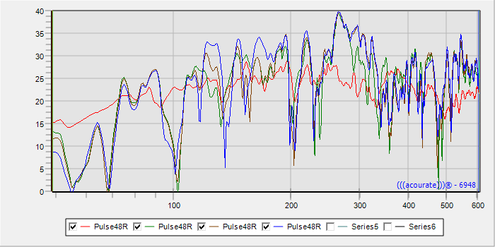

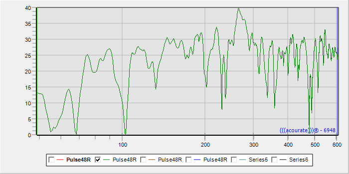

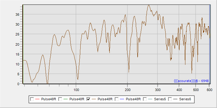

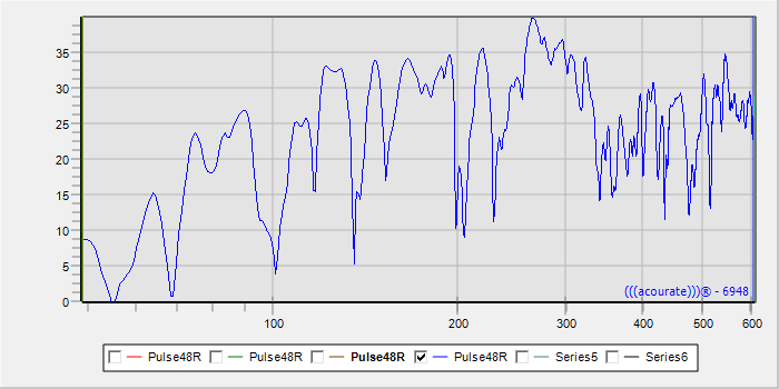

I finally had time today to measure again:
What do you guys see?
- Red: lower driver only in 56 liter box, measured at 30cm and 10cm high (same as before, for reference). Qtc=0.41
- Green: again lower driver in 56 liter box, measured on axis at 185cm away and 95cm high (ear level)
- Brown: 20 liter box, measured on axis at 185cm away and 95cm high
- Red: 10 liter box, measured on axis at 185cm away and 95cm high
- All of them together. Busy chart.
