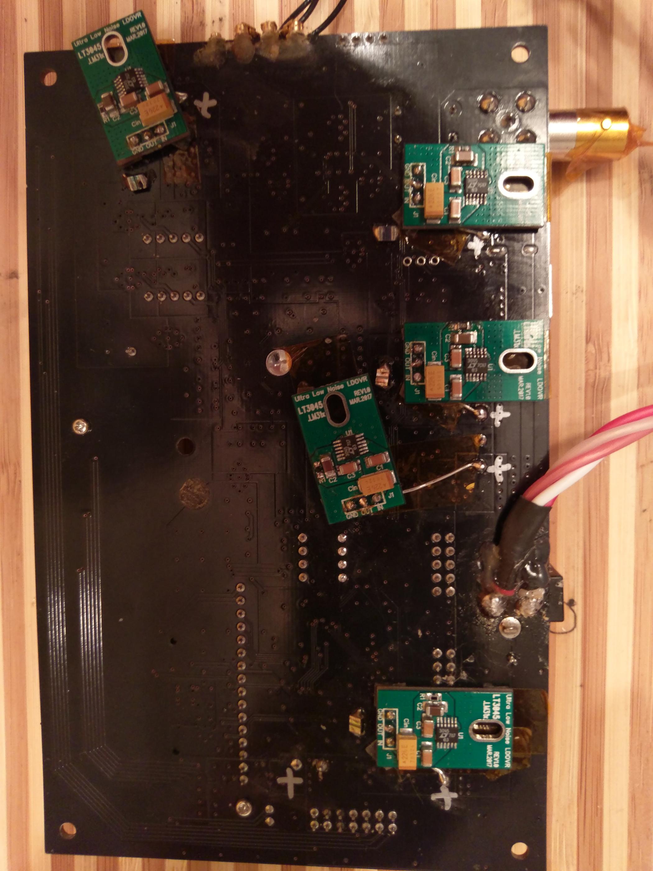

A few weeks ago I did a pretty extensive modification to mine. It involved replacing all of the on-board regulators with small LT3045-based boards from ldovr.com. Given that the SDTrans384 has readily available external voltage insertion points, it made this mod pretty easy. Nice upgrade in definition too. Clocks possibly next, I've got some of the higher-quality NDKs from Lorian's group buy. Though I really want to put a Pulsar clock there!

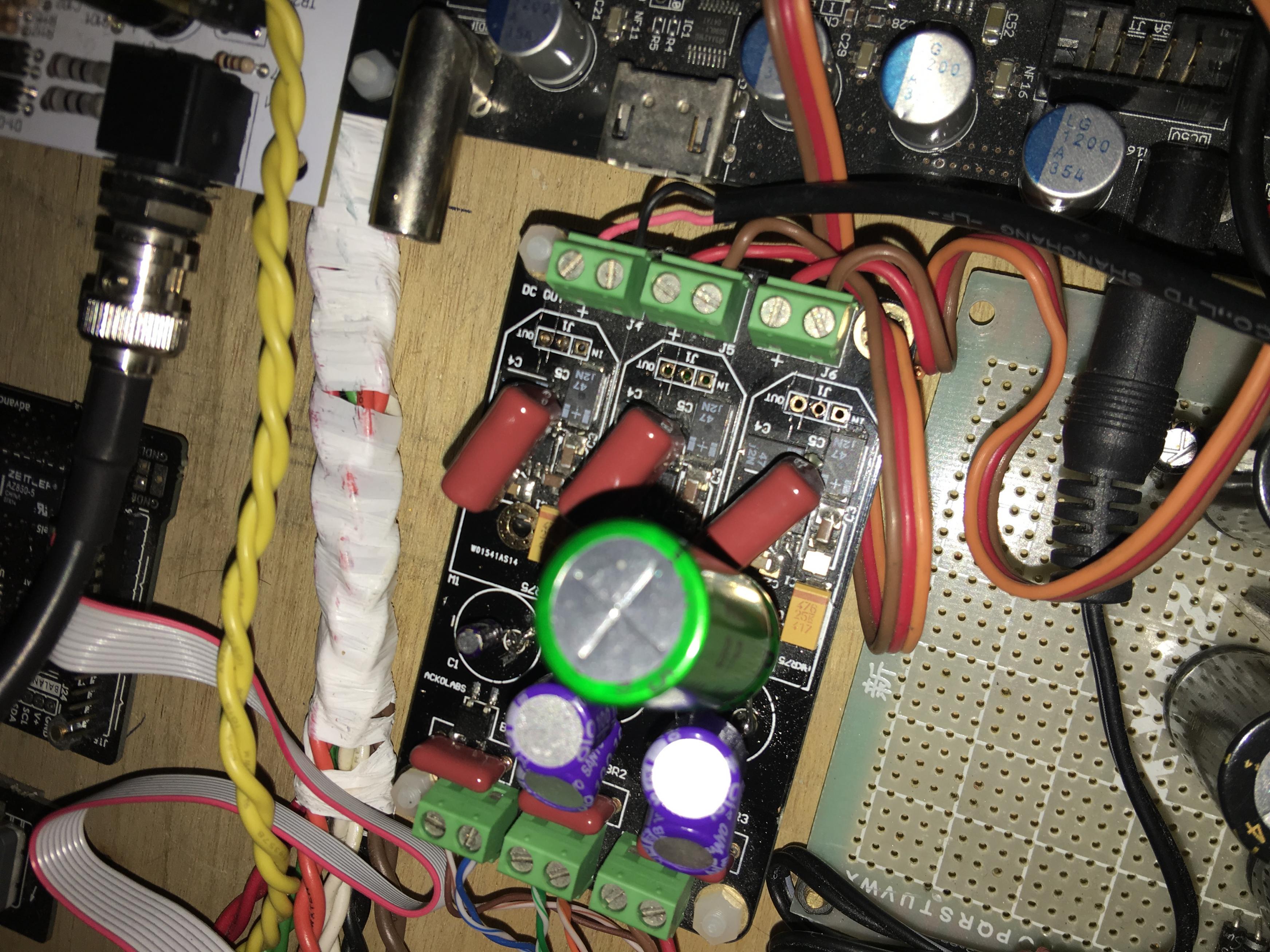

Here you go Greg. To be honest am not too sure which version are the regs as I bought the shole set from a fellow member her. As it it is there’s 3 regs of 1.2v,2.5v & 3.3 v which is use to power CN 1,5 & 7.
Im getting very good results with the tweaking of main PS caps. Do wonder if somemore improvement can be had if I change those on board 1200 & 470uf caps. Not having the schema doesn’t help matters. What really surprised me was the effect that I got just tweaking the PS caps for the FGA supplies.

The regs you have from Acko are his previous model, the AKR75, which uses the (again, still good) ADM715x regulators... I can see the model in the picture and also enough of the reg chip package to ID it. That was what I'd planned to use on my SDTrans384 mod before the LT3042 ones came out. The ADM715x ones are good (that's what Twisted Pear is using in their latest regs for the Buffalo DACs) AND I'm not sure there's a ton of reason to switch.
On changing out the pre-post regulator caps on the board, I am sure that will make a difference... but whether any is a positive or negative diff to one's ears and listening preferences is hard to predict. That takes a lot of time and care to do... instead I'm focusing on things I'm pretty sure will make positive diffs, such as better regs and power supply sources. BUT if you try it and find some you like, I'd be happy to try them out.
I DO find it really important to keep path-lengths short for digital supply final regulators to their consuming devices. That's why I mounted my regs right on the back of the board with a very short link up to each input point. I have plans to try multiple raw DC supplies at some point, but that's low-priority right now. I do that other places... my Soekris DAM1021 DACs are fed from 4 fairly serious separate supplies, each feeding one of the 4 regs on the board (which I also just upgraded, LT3042-based board for the 3.3V clock & FPGA & 1.2V FPGA rails, Sparkos discrete regs for the +-5V shift register supplies... and each is as close to the power consumer as possible).
But back to the SDTrans384, while I replaced the on-board regs (even removed them), I used the power feed that was the input of each to power my add-on regs, to keep things simple. BUT I did it so it'd be easy to disconnect and feed each separately when I try that.
