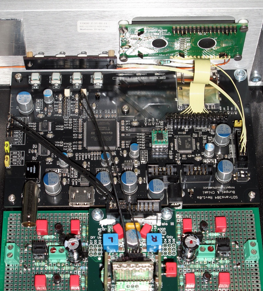

remote control for sdtrans
I received the remote kit and had no trouble installing it. Works great and am happy to have the lazy way to control the player. Now I need to make a case for it. Anyone know what type of ribbon cable is needed to move the LCD so it can be viewed from the front?

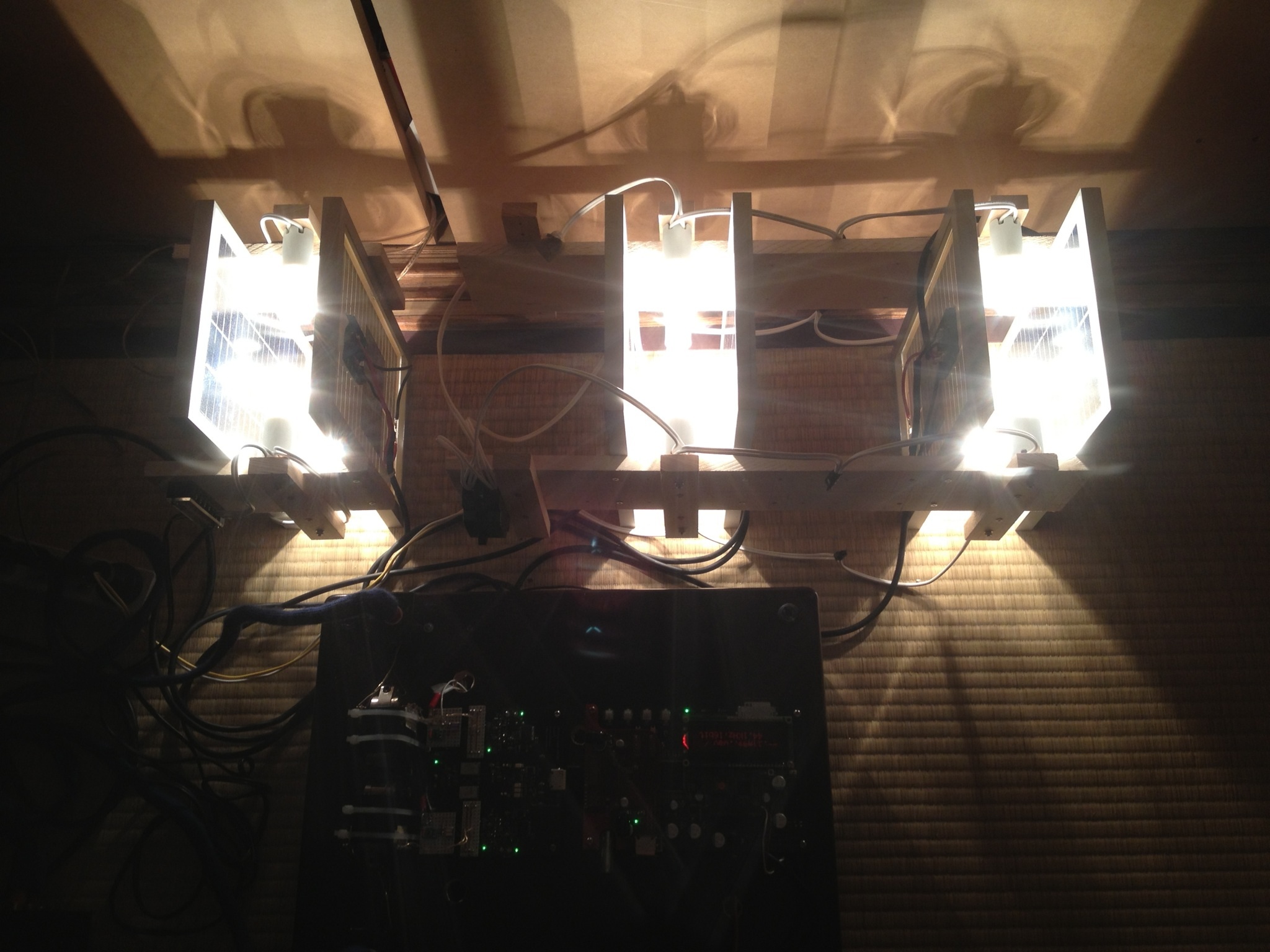

A Japanese SDTrans user, Ken, built a "solar battery panel" based power supply and connected it to SDTrans384. Bunpei had a chance to compare resultant sounds with that of a conventional power supply.
Bunpei could perceive a definite sound quality difference. The solar battery panel power supply gave clearer sounds. It reminded me of DSD sound characteristic.
The system consists of two panels, a shunt type regulator and Krypton bulb light sources.
The system achieves a complete galvanic isolation.
Clean solar energy provides clean sounding audio

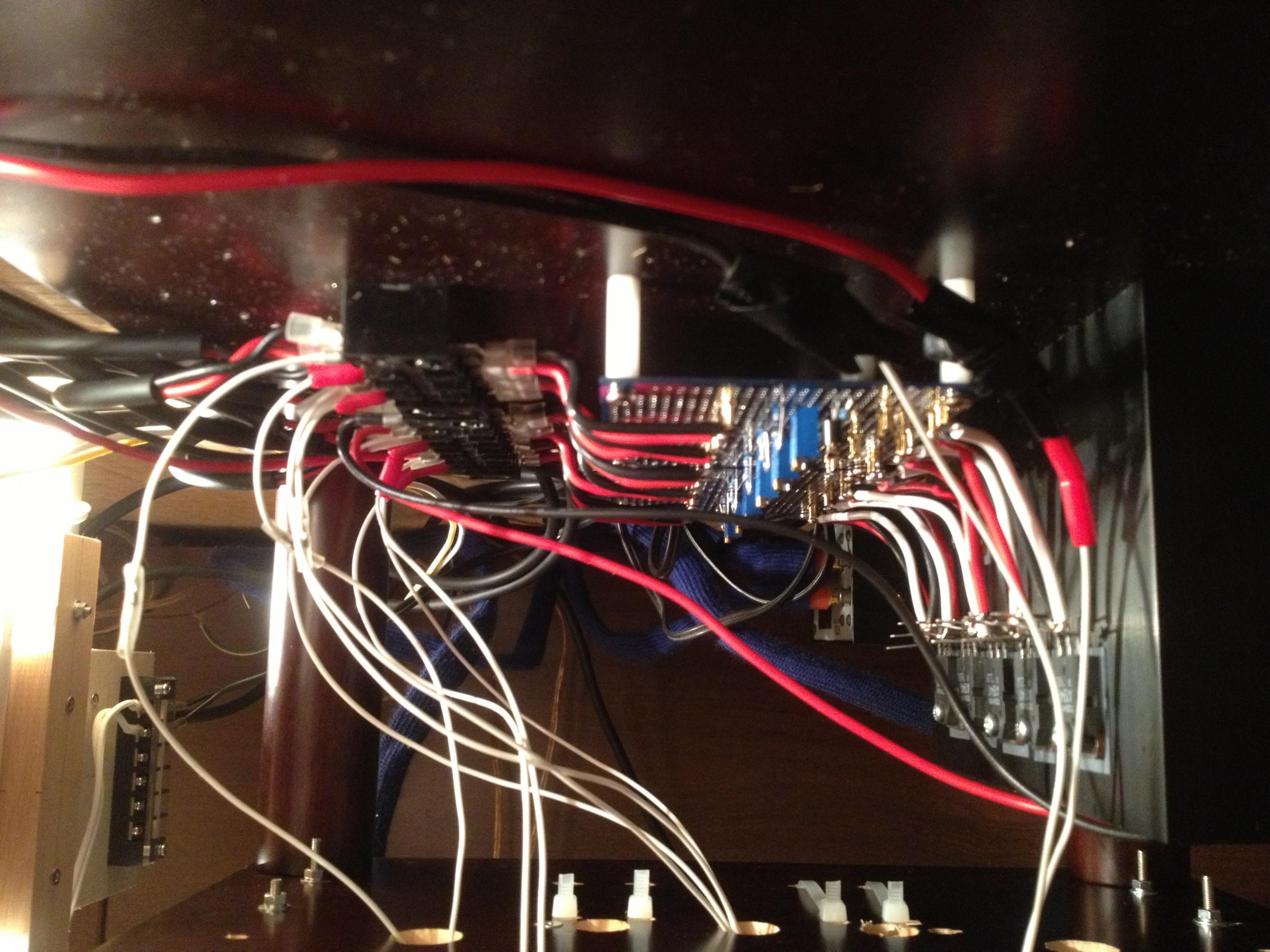

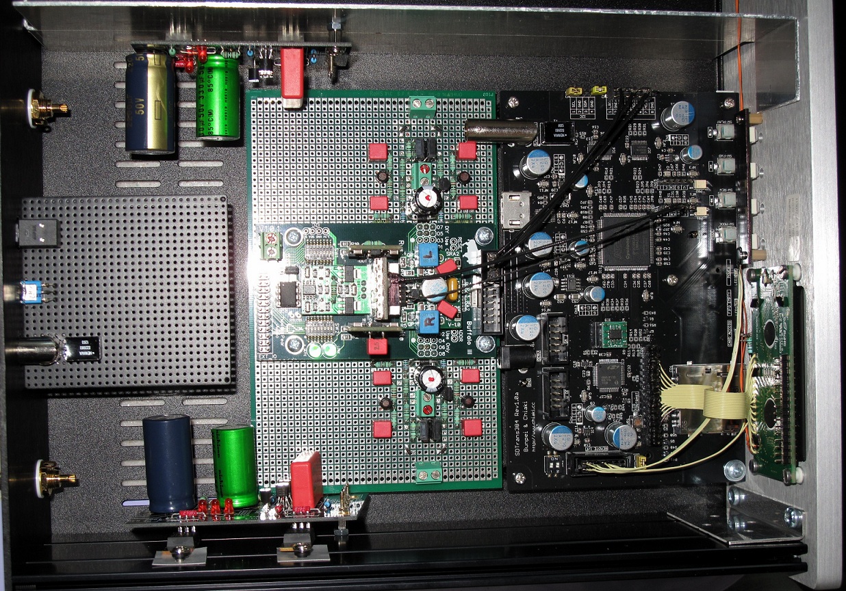

I built my own Solar Cell Panel power supply for SDTrans384+Chiaki's ES9018 Dual Mono DAC. Three pairs of solar cell panels generate six independent +5V output for SDTrans, Clock section DAC, DVCC section L, DVCC section R, AVCC section L and AVCC section R.
Solar cell panel +10V raw DC output are regulated by simple TL431 + 2SA1941 based shunt regulators.
I believe I have obtained the best power supply system commensurate to Chiaki's DAC so far.
Resultant sound quality is very detailed and powerful at the same time as well as bright and clear. The PS meets digital, analog and clock sections.
