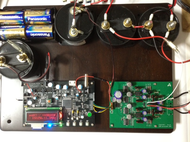

SDTrans with ElectrArt's "DSD Principle Board"
Hi, staccatiss,
I appreciated your comment and the link very much.
The picture attached below shows a combination of Chiaki's SDTrans384 and ElectrArt's "DSD Principle Board" which is a simple 8 tap FIR and op-amp based analog filtering circuit designed and dedicated for a DSD play.
Without such commercial DAC chips as ESS ES9018 or TI DSD1794A, I can listen to fine music of DSD sources, ranging from DSD64 to DSD512 by using the ElectrArt's board. His schematic is available here.
When you use SDTrans384 as a DSD player, it supports DSD64, DSD128 and DSD256. (DSD512 is out of scope due to a performance limit of data read out rate from a SD memory card.)
However, I love plays of DSD256 sources converted from PCM by Sony DSD Direct software using SDTrans384 as a transport.
Bunpei
Very neat setup you have! And no DAC - amazing!
I also see in the schematic that there is an isolator used. I think that that is very important to have.
What will improve sonics is to short out the electrolytic caps (C36, C37) in the signal path unless the output signal before the caps has too much DC offset. To use electrolytic caps in the signal path is very very seldom used in high end audio designs.
What OPamps are used?
Looking at your power supply wiring, I think it is far from optimal. The wires are too long and twisting them would also be good. I would actually try to stack the PCBs on top of the huge PP caps for shortest possible power supply wiring.

Hi, staccatiss,
I'm sorry for my delayed reply to you.
As for C36 and C37, in my case, after checking output by an oscilloscope, I eliminated them. However, ElectrArt recommend we use them because in the actual situations of playing DSD sources we sometimes unintentionally suffer DC offset output due to malfunction of player software.
The OPamps ElectrArt selected is OPA2134.
As for my cabling of power supply lines, thank you very much for your advice. I should make them short by locating components in multi-floors.

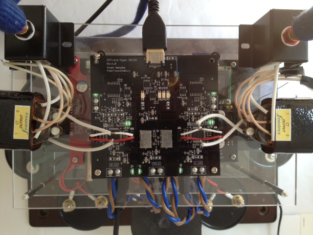

By the way, in Chiaki's web page he shows a picture of his original ES9018 dual mono DAC arranged in a five-storied building!
It really reminds us of buildings in Tokyo.
The dark brown eight devices are linear power supply units!
TPA IVY III is connected as a tentative I/V stage for his DAC.
Chiaki's SDTrans-Sync-9018D DAC system
I had a chance to listened to resultant sounds of Chiaki's SDTrans-Sync-9018D DAC system in my environment.
Outputs of ES9018 dual mono (8 channels in parallel at each ES9018) were connected to Feastrex Finemet line transformers.
The sounds were superb!
Both high-resolution and energy existed together.
Seamless plays from 44.1kHz/16 bit to 384kHz/32bit PCM and from DSD64 (both 44.1kHz/48kHz series) to DSD256 without any clicking noises were supported.
It really gives a glimpse of "High-end"!
Chiaki has not made his final decision for a possible release of the DAC board kit yet. Please post your requesting messages here if you are interested in his DAC that is closely integrated with his SDTrans384.
Bunpei
The Chiaki-DAC looks awesome!
I would like to know a bit more about it. Is ther maybe a block diagram showing for ex how the clocks are used, and what music inputs and outputs it have, and what power supply on the PCB are used?

Dear staccatiss and Gappone,
I appreciated your hearty greeting messages very much!
This year, Chiaki will release his original DAC board tightly coupled with SDTrans384.
(To staccatiss: I am very sorry that I have not shown the diagram here you requested. I have not observed his DAC well enough.)
My concern still remaining since the last year is,
"Are all the users of SDTrans Sync-option satisfied with the expensive option? Could they integrated the board with their own DACs?"
