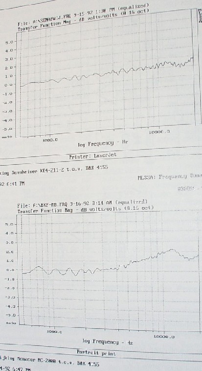

The modified Panasonic is fine, IF it is calibrated. I like many, just bought the pre-calibrated Behringer as I have a suitable preamp. My Panasonic I built has a mini jack so it can feed a sound card direct. NO mic is at all useful if it has not been calibrated and your measurement can not accept the cal file. NONE. Do I need to say that again? It must be calibrated. Oh yea, one more thought. It must be calibrated. A mic is only slightly flatter than a speaker.
I disagree that the uncalibrated Panasonic mic is not useful. I calibrated mine against a B&K reference mic I have at work and it was within +/-0.5dB up to ~8kHz. I think that would be useful for the majority of crossover design work. If you want to know what your speaker is doing at very high frequencies you'll have to get something that's calibrated, but it does usually require more expensive gear to measure things at the limits of a range...
You could possibly calibrate the mic yourself, but it might be a bit tough. You can use a concept called reciprocity to calibrate the absolute sensitivity of a transducer using reversible transducers without any outside reference device. That is, you have to have transducers that can function as both speakers and microphones. I did this the other day using headset transducers - similar to tweeters. The way I did it required three transducers. The procedure and relevant equations are in Beranek's Acoustics. The tricky parts are that (at least for me), the voltages I was measuring were very small - millivolts or less and you need a voltmeter that will give you a precise enough reading. I used a meter that could resolve to thousandths of a millivolt. Also, I was doing a calibration in a sealed chamber which requires that the chamber size be <1/20 wavelength (iirc) of the frequency you're calibrating. There's a free field method as well, but at least in my case the voltages would likely have been even smaller. In theory you could do this at all the frequencies you were interested in and then you'd have a calibrated transducer. Then you could compare the response of this transducer to a sound source to the response of your measurement microphone in order to calibrate the measurement mic.
It's probably easier to find someone with a reference measurement mic and get them to calibrate your mic for you.

You can't as it requires a known laboratory standard. It only costs about $60. I have to totally disagree with the other replies. I have a Panasonic capsule, and an uncalibrated E8000. Using them I built speakers that measured well and sounded like well processed hay. Now I have a mic I can depend on. I kind of wish I had gone to a more expensive lab and gotten a phase calibration, but the E8000 is pretty flat through the midrange where it matters, so I live with that.
