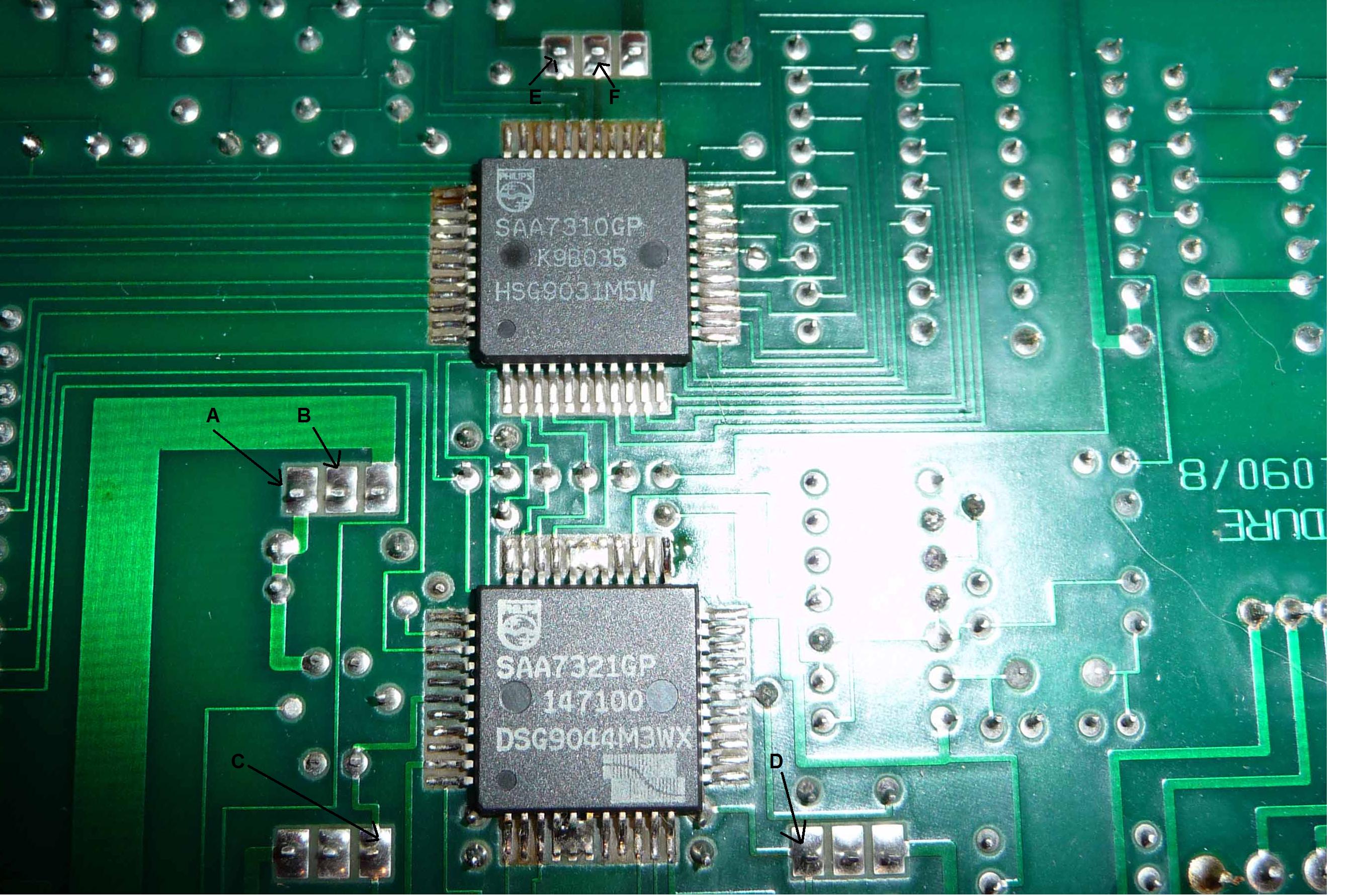

And these 6 measurements here A to F

Measured the following:
MC7HCD04N Pin 14 4.69V
L356N Pin 4 15.09V
Pin 7 -14.93V
On Main Board
A -4.75V
B 0.00V
C -4.98V
D -4.97V
E -4.79V
F 0.00V
Also
TDA 5709
Pin 6 -4.58V
Pin 11 4.84V
Pin 12 -0.08V
4560
Pin 4 -13.87V
Pin 8 -9.7V
Some were a little tricky to measure but I would think are pretty accurate

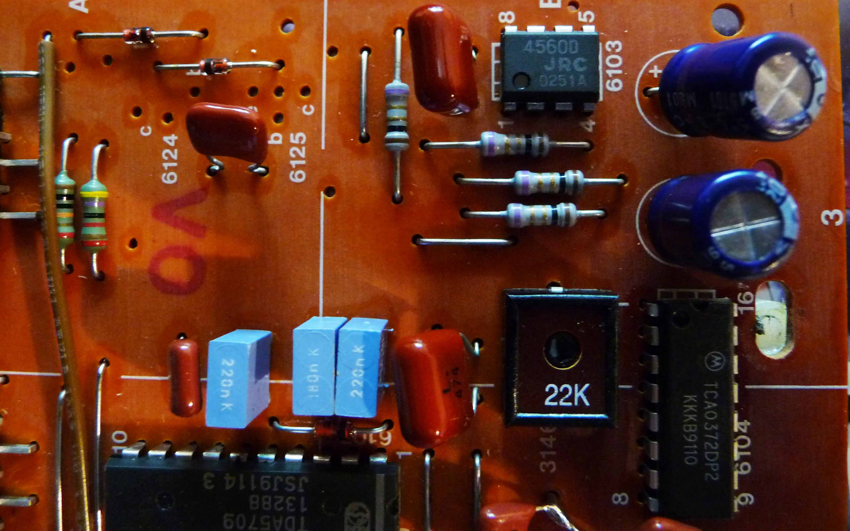

The 4560 is a dual opamp and I suspect used for motor control. I would have expected pin 8 to be a positive reading. That said -9 on pin 8 and -15 on pin 4 is still a "valid" supply depending on the exact circuit application but it stands out a mile as not "normal".
I would recheck that reading and try and trace back pin 8 and see where it goes...

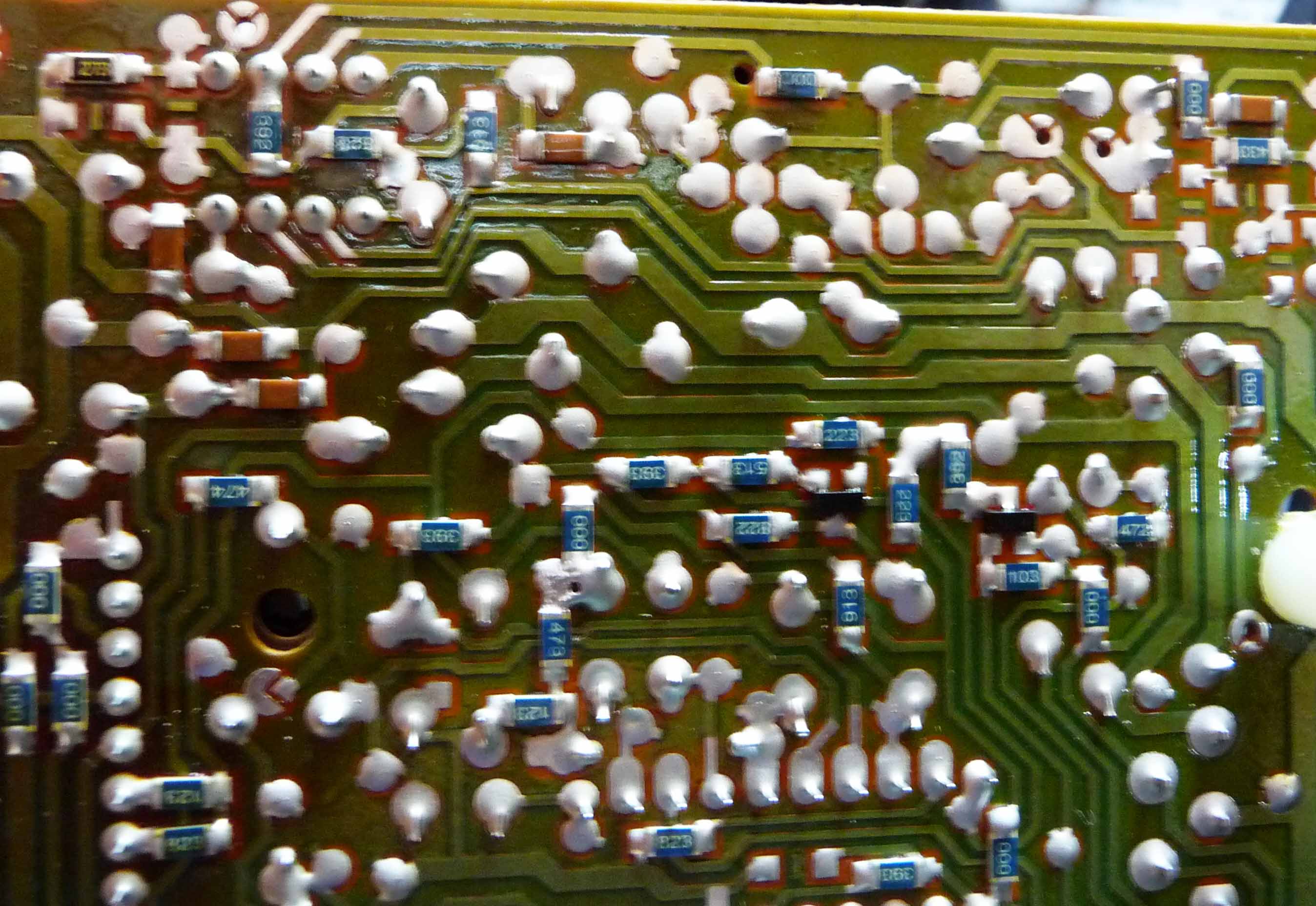

I have also attached a close up pic of the rear of the board - with the 8 pins of the 4560 top left on the rear view of the board - pin 8 is nearest the edge fourth from the right!
I attach also a pic of components in close proximity to the 4560

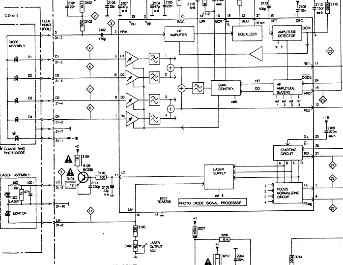

The schematic excerpt attached is representative of this player. The 4k7 is shown at the top above TP2. There should be 50mV across this resistor but I only measure a few mV. The voltage on the LM pin varies in sympathy with the LO voltage on the 12R (3101). I haven't measured the voltage on the flexfoil to the laser unit but I assume since the monitor photodiode is generating a signal the laser is getting power and doing something.
Does it need to be in service mode to properly setup the laser current or can it simply be in normal play mode ?
Jon

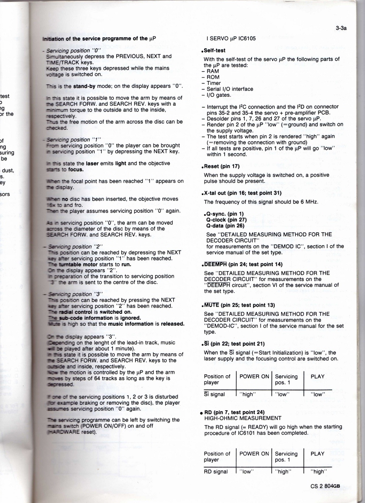

The only key combination I know is the old one of pressing PREVIOUS, NEXT and the TIME/TRACK while the mains is applied... don't know if that's applicable to many Philips models though. If it is that brings 0 up on the display.
If you press the NEXT key from this service mode the laser should light and focus search 16 times with no disc.
Search forward and reverse move the arm.
The 50mv adjustment depends entirely on light reflected back from the disc. So the laser can be bright but if nothing gets back then the 50mv will be wrong even though the laser itself is good.
Measuring the voltdrop across that 12 ohm is the best way to determine actual laser current as that is independant of any disc etc and see if it's reasonable... guessing 45 to 65 milliamps would be in the right region. Be carefull not to "spike" the laser. Best to solder wires and rig up the DVM first.

Mooly you're a genius, it is indeed those keys !
Now I need to brush up on my German to understand the Philips service manuals. NEXT goes from mode 0 to mode 1 and the laser assembly lifts up (but it just drops back to mode 0 again). << and >> do swing the arm.

Here's the full service modes available,
