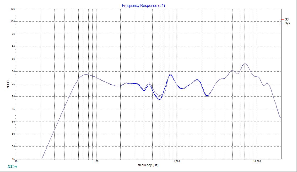

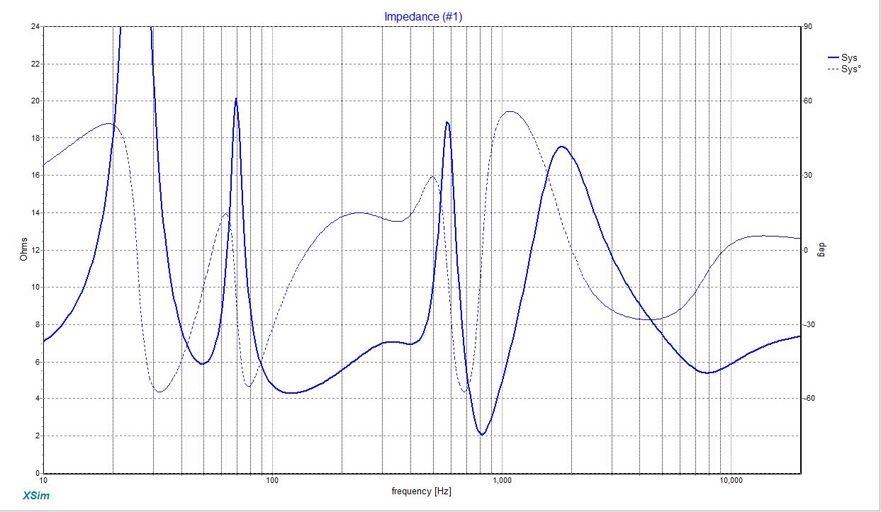

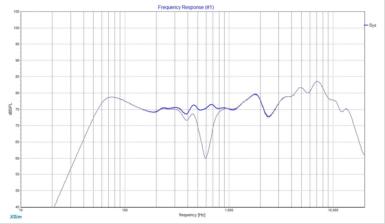

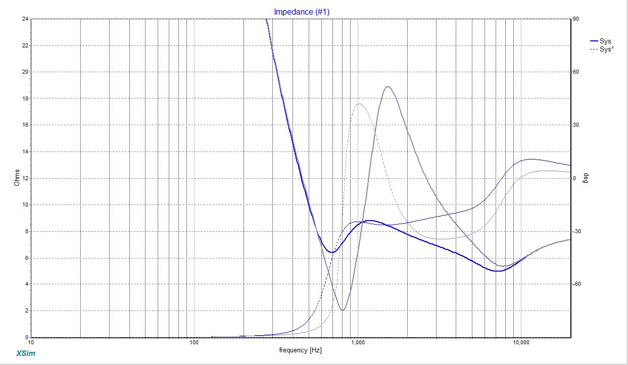

The wood is absolutely lovely looking with so much effort invested in building an unusual shape along with taking photos of the process. This is just the kind of speakers you usually start to appreciate once you are passed showing off with big boys systems. Congratulations!
I've tried to simulate your speakers and it appears now that the issue at about 870 Hz isn't due air resonances, rather odd filter value of full range HP. This is your filter impedance. Can you measure to confirm that? I'd suggest a little modification to improve that, once we're sure it's what I'm suspecting.
I spent over 30 hours tuning the XO on these, this is some anomoly with the PS95 interacting with the raised frame of the W5 woofer as if I removed the W5 from the baffle the response would smoothen out here. Ultimately it's quite a small bump, EQing it out digitally made little difference that I could hear.
Javad
...this is some anomoly with the PS95 interacting with the raised frame of the W5 woofer as if I removed the W5 from the baffle the response would smoothen out here.
Javad
The difference in impedance plots of your and my minor filter modification is evident in peaking of FR. Further FR plots show summing in and out of phase.
