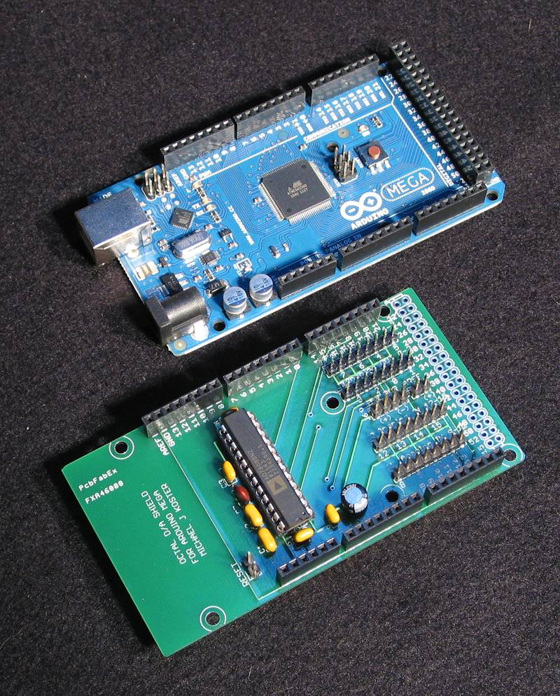

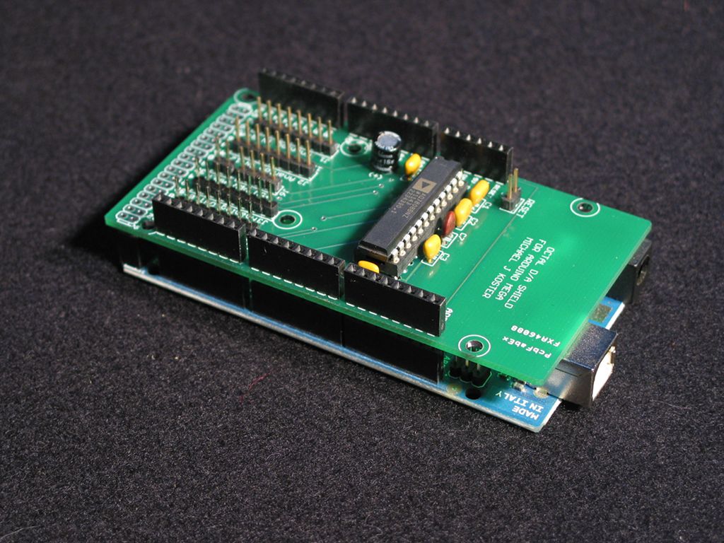

Here's an 8 channel 10 bit DAC Arduino Shield I built to control my Internet of Things tube tester.
